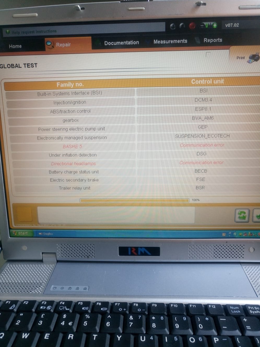

Don't know if this helps Kenny but my X7 has similar issue which the dealers diagnosed a broken wire to the suspension pump ecu, unfortunately they didnt tell me which wire had broken and they have now closed for the next couple of months. I have managed to get the car back home and it looks like they have done a bit of rewiring as wires to suspension pump ecu have fresh black tape on them.
Here is a screen shot of my global test but I am using an earlier version of diagbox so it might be different.

Thanks Gino,
My suspension is working fine but the diagnostic line isn't. So communication between diagbox and ecu. Hence my hunt for a broken/damaged wire.
