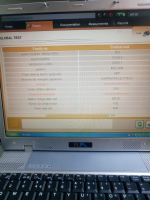

Here is a screen shot of my global test but I am using an earlier version of diagbox so it might be different.
Gino
Gino

Re: suspension ecu
Thanks Gino,
My suspension is working fine but the diagnostic line isn't. So communication between diagbox and ecu. Hence my hunt for a broken/damaged wire.
Kenny
