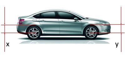

Hello dear colleagues.
I have one request a colleague which has a Hydractive 3+ suspension system. Can one of you give me the values in [mm] for "x" and "y" from the picture attached? Please take this measurement with the car on flat ground and the engine turned on.
I know that probably it isn't the best way but I have tried to adjust my height using the tutorial from Marc and I want to double check with you these "x" and "y" values. Perhaps we can also share some more values and see if there are differences.
Thank you very much.
P.S. My new values are: x=38 [mm] and y=41,5 [mm]. Before I have not measured, but the rear of the car was always higher that the front => this had an impact also on my headlamps.

Hi Vlad - just a little confused - the 2 arrows in your diagram show the measurement from the centre cap to the top of the wheel arch - it this what you want? I ask because in the height correction notes, the " R1 " and " R1' " values are taken from the centre cap to the ground.

Re: C5 Mk3 58 plate Exclusive Hydractive Suspension height
Hi Marc. I need the distances between the centre of the rear and front wheels, to the wheel "wing", in the vertical direction, and not the radius of the wheel, with the engine turned on.
Ok, so here are my measurements - obviously, you need to allow for ground surface and tyre differences.
Front centre to wing = 41.5 cm
Rear centre to wing - 40 cm
Thank you very much Marc. What do you think, shall I leave the values like mine (41,5/38) or shall I modify the rear like yours? Tires dimensions are 225/55 R17.
