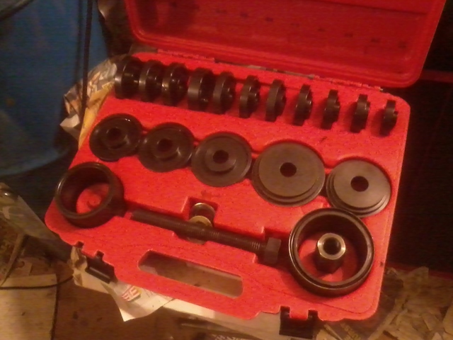

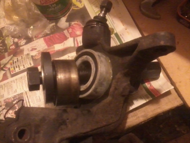

Re: 1996 Xantia 1.9TD 290k front nearside hub replacement
Just use the best fitting of the plates from the puller kit on the inside (Don't fit the circlip first, cos then you have to take it out again - guess how I know thatromie wrote:cool, so supporting the other side of the inner race. I can use the old inner race for this?
Thanks Jim
Using the threaded puller it's pretty easy to get it square and pull in OK - well I managed it twice anyway! When you do it 'for real' make sure you take care over the ABS sensor - easy to damage I imagine.
ah, right'o.
Does the hub only pull through flush to the outside of the inner race then. And so I can use a flat plate to support the inner race?
(I don't have it with me to check)
Yes and yes, as the inner hub stub ends up just shy of the end of the further inner race whilst its flange face rests on the outside of the nearest inner race....romie wrote: Does the hub only pull through flush to the outside of the inner race then. And so I can use a flat plate to support the inner race?
Took me bloody ages to get it in (must get some proper circlip pliers next time), finally got it. Then offered up the puller, and realised my mistakeCitroJim wrote:Richard, good point about the circlip

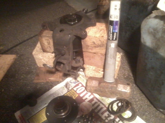

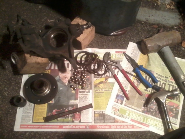

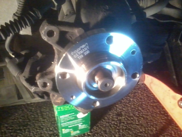

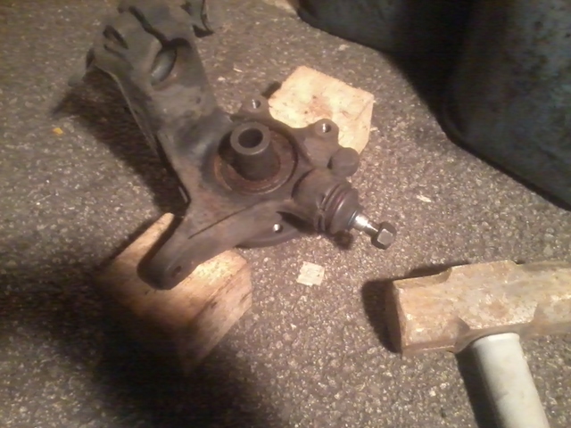

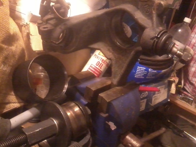

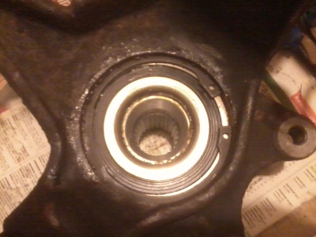

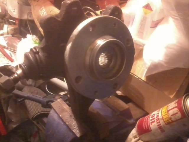

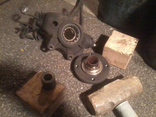

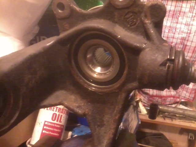

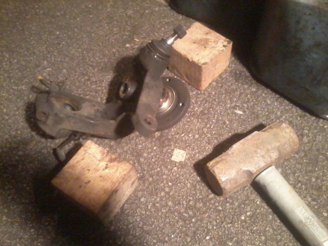

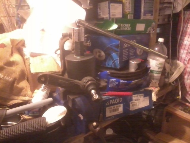

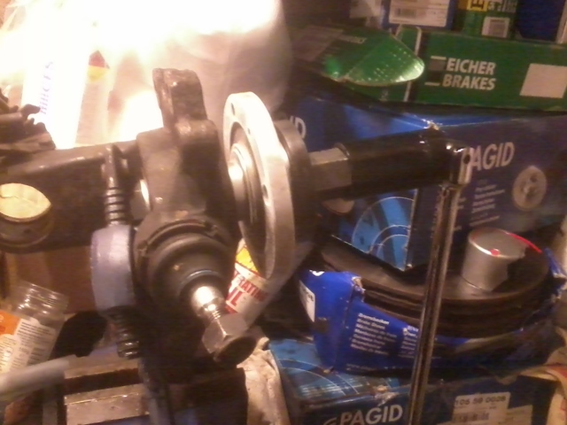

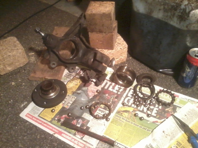

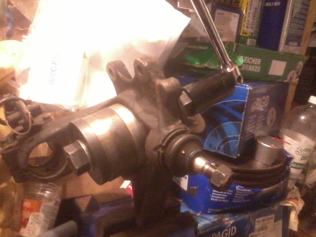

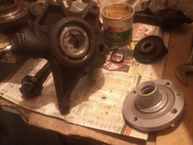

DONE!
Not such a bigger job, (ehem ~ only after some great pointers on here! :p and being able to practice on spare hub carrier)
Cheers guys!
Totally recommend going straight for the hub/bearing change in future.
Excellent work Romie
Those pictures give a good guide for anyone doing the job without a press and shows it can be done, albeit with the aid of a big hammer!!!
cheers
Thought these terrible 2mega pixel photo's even without a flash might help someone out who's in the same predicament :/
Would have taken a lot longer without the very useful advise on here mind!
