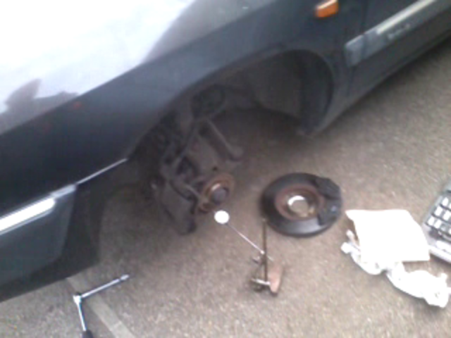

Thought it might be the disc but of course I wanted to check the hub before running off to exchange.. and here's the vid.

it seems the tip of your dial gauge is running on a rough/rusty surface in your vid
Regards, malcolm.

yup :/ I sanded off the surface but it was still a bit rough. It showed me that the general wobble came from the hub tho.

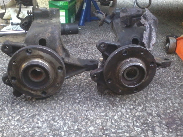

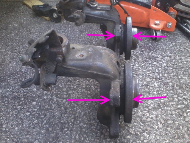

So replacement hub carrier assembly was slightly different to my one. Only found out at the point where I was just fitting the brake calliper back on :(
Looked identical, but these two distances were different, see picture :/
(hub at bottom of image is mine. Higher one had a bigger distance between calliper mounting face and hub face)
(also my 35mm impact socket fitted in my hub, but not in the new one! Slightly smaller outer diameter ring where the socket needs to go into >:( )

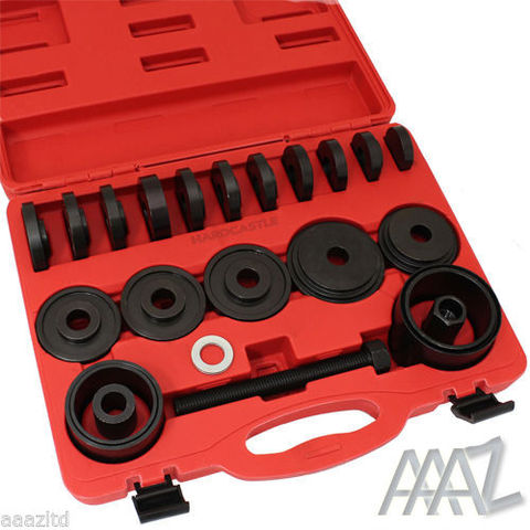

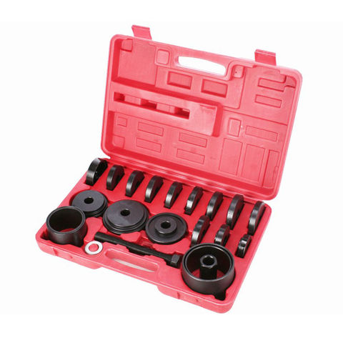

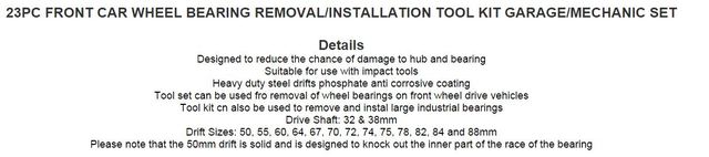

So would it be possible, given some sort of 'hub puller' (slide hammer or other type) and a bearing install tool, to replace hub without upsetting the bearing?
Was looking at this bearing install tool set.
There seems to be a few different arrangement of bits in some of these.
These look ok to re-install the new hub? :)
or this one looks like it might have one extra bit in it.
http://www.ebay.co.uk/itm/23PC-FRONT-CA ... 4ae6d961ed

I fear you my not be successful with those tools, those bearings are best done in a large press and I wonder if you/they well be strong enough.

Before buying tools, I'll try 'tapping' the hub from the bearing using something like a socket and a sledgehammer, just to see what happens.
Orrr, I could make a press from some box section and a bottle jack - hmmm

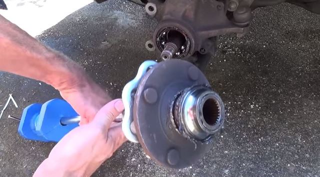

On the 'new' hub the centre part looks smaller diameter? In which case it will be no good for you, as the wheel won't fit properly. Also, if you put that hub in your hub carrier, then it will probably still be in the same (wrong!) place. If you look at the back of the bearing, is the hub flush with the back of the bearing?
You can't change the hub without changing the bearing - when you pull the hub out of the bearing it will pull the inner part of the outer race of the bearing with it (and which you will then need to cut / press off the hub), rendering the bearing scrap.
I've got one of those tool sets, and used it to change both front wheel bearings on my 307. It works surprisingly well, but you need a big vice to hold the hub, and a bag bar to turn the nut on the screw (see that breaker bar you used to get the hub nut undone :mrgreen: ). What I did with mine was to put tension on the bearing, then support the hub and give the end of the tool a good few whacks - this was enough to just unseat the bearing, and allow me then to pull it out. First of course you need to remove the circlip on the back - and that may be a whole world of pain!
Easiest way to get the hub out of the bearing is to get a couple of bolts the same pitch as the wheel bolts, and then screw them through the wheel bolt holes, and using appropriate packers, use them to jack the hub out of the bearing / carrier (some of the tool sets contain screws that are for this, but be aware that PSA sometimes use different thread pitch, so the std ones may not be any good (I got to having all the bolts undone and ready to take the hub carrier off the car before I realised that.... :roll: )

Can't remove hub without pulling the bearing apart?
ah, damn. This is what I was worried about.
I've seen a few youtube vids of a hub bearing falling to bits after the hub is pulled out but was hoping that was on hubs that had open races? Bud damn.
And now you've said that, I've also seen the vids where that inner bearing race needed to be angle ground and then whacked out with a cold or air chisel. ugh.
Good plan with the bolts pushing the hub off 'through the wheel bolt holes', I was thinking about this myself! >:D
I need to figure out what thread they are :/
ok, now I know that getting the hub and bearing off is the same as some of the youtube vids I've been seeing.
Something like this procedure?
