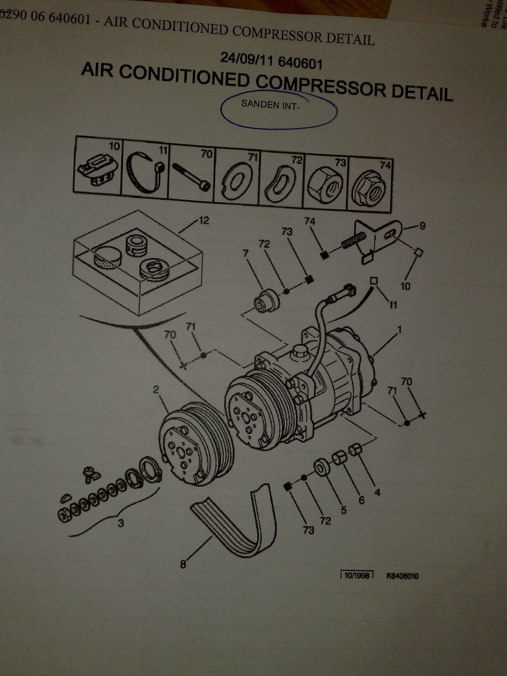

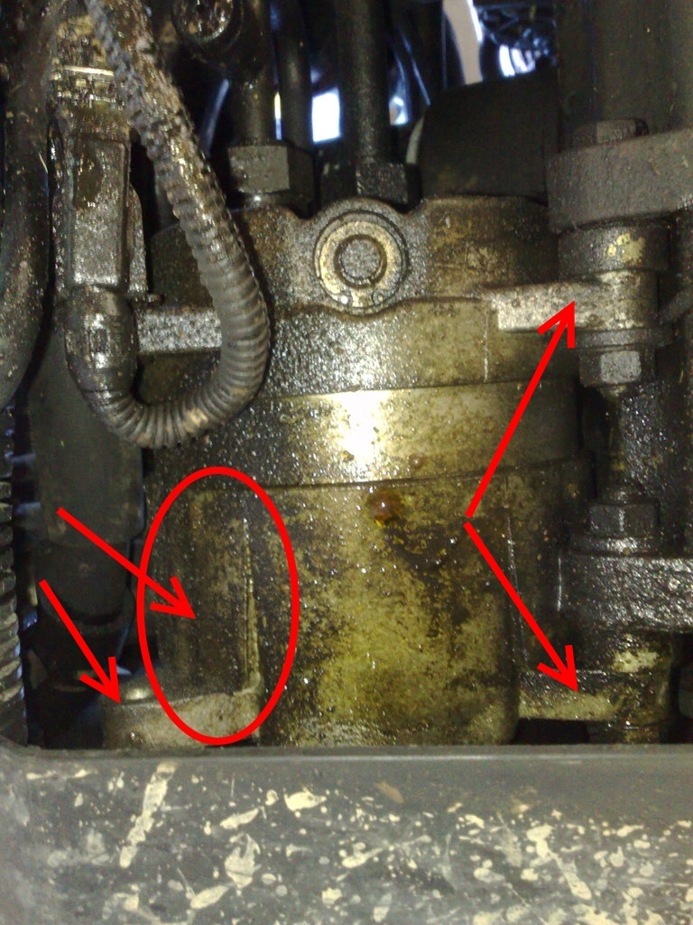

So here is the diagram of the sanden compressor.
When comparing the delphi diagram with the sanden one, the images I took from beneath my car seems to show more points that look like the delphi than the sandern.
Notice the 'ribs' going to the mounting points on the delphi diagram and on the actual picture of the one on the car. The sandern does not have these ribs.
Also notice the mounting points themselves. They 'stick out' much more like the ones on the delphi, but the sandern ones are a lot more squared off.

Looking at the different compressors online that all proport to be the same model (SD7V16) but have different hose attachments, which would suggest that the pipes are not make specific as I though.
Those diagrams above show what Jim mentioned, with the pulley face being the important factor, especially as the Delphi Harrison diagram mentions screw union and union with clamp.
So triangular plate on the pulley = Delphi Harrison
Kool-aid man shape plate on the pulley = Sanden

Romie and Xac your pump number does not come up but the tech man at delphi says both the 5253 & 5290 are the same except the air con pipes are definitly diferent
http://webshop-cdn.tecdoc.net/delphi/?&isRedirect=1" onclick="window.open(this.href);return false;
I shall attach a photo of mine in a moment or 2.
Kenny
I'm back again
Check this link to the delphi tec site very interesting
Kenny
