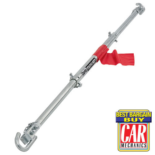

As an idea, to take the pressure off the immobilised car, to swap it over
with the one behind, at a cost of just £15 get yourself this:
http://www.machinemart.co.uk/shop/produ ... n-products
These are great as you have a fixed length bar that you can not only tow
the car with but push it as well - these are superb and I've moved my cars
around a barn and up a steep ramp. Even if your car has settled on the
suspension you can prop it up to prevent it grounding - s2's shouldn't though
but I can elaborate for you if you want
