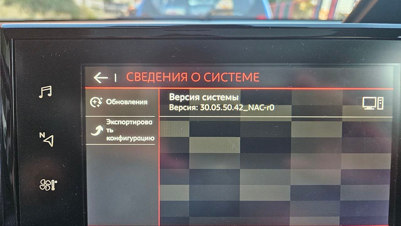

Marc, I downloaded the firmware from the URL you provided, but it was 31-09-46-62_NAC-r0, not 42.01.72.32_NAC-r0 you recommended to use first. Nevertheless, I tried to upgrade the firmware with 31-09-46-62_NAC-r0, but received an error message "Version is not compatible with the hardware". Could this happen because I tried to apply 31-09-46-62_NAC-r0 instead of 42.01.72.32_NAC-r0? Would you please suggest what else could be done?First install 42.01.72.32_NAC-r0
I do appreciate your support.
Thanks in advance.

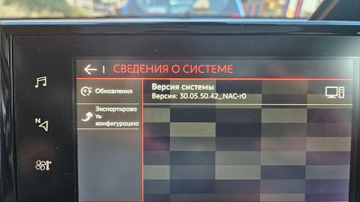

Re: PSA NAC RCC Updates
I have. The USB stick root file system screenshot is in the attachment. The license .key file is in the /license folder. The instruction says it is license, not licenceHave your read the following guide on how to use the licence file? This message can appear when the licence file is not being read.
You are right, my current version is 30.05.50.42_NAC-r0.Are you sure your existing version is 30.05.50.41_NAC-r0 and not 30.05.50.42_NAC-r0
