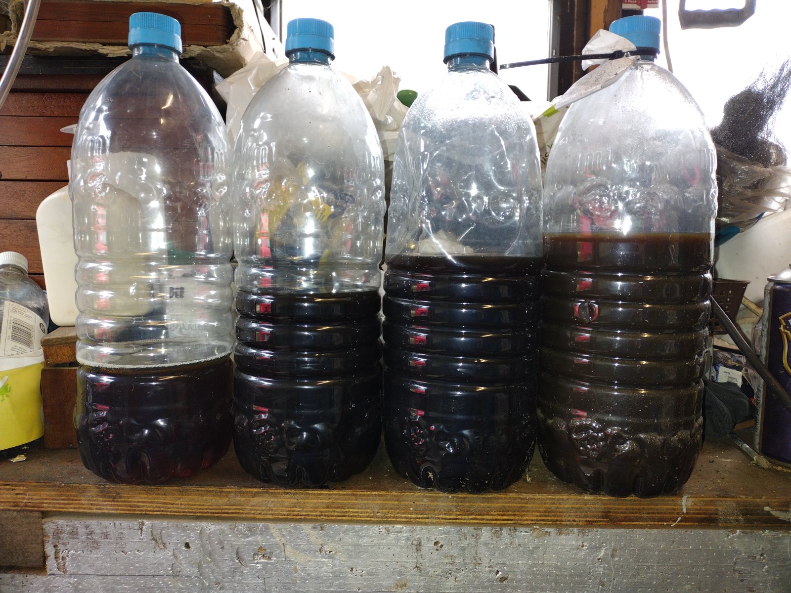

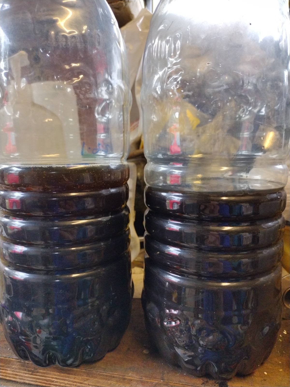

Gearbox oil comparison!
New and lots of old
New and lots of old
Left to right
1 litre of new stuff, end of this bottle:
New oil spec
New oil spec
Next, what drained from the HDi Coupe (should be approaching 1.85 litres, as above) age and mileage unknown.
Next, 1.8 litres drained from the BE4 gearbox of my 2.0 Coupe. Surprisingly only about 30,000 miles on this and looks nearer the rest than to the new. Don't think it's the synthetic stuff, but some other mineral 75W80, maybe Halfords own?
Right hand side, what drained out of the ML6 gearbox on the C5. Again mileage unknown but it did have a gearbox off job about 4 years ago and the previous owner was at least billed for new oil!
Not much difference on the pictures (other than not enough in the HDi Coupe gearbox!) In the flesh the C5 stuff is definitely the worst, the others similar and none anything like resembling the new.
As the litre pictured is end of my current stock of gearbox oil, this will be a part old part new swap for the HDi Coupe, will aim to do a full change next time I've need to pull a driveshaft out.
And rest will finally go to the tip!
This post sponsored by Vimto 3 litre bottles! :rofl2:

1.85 on the left, what came out on the right, so down a bit, but not silly low

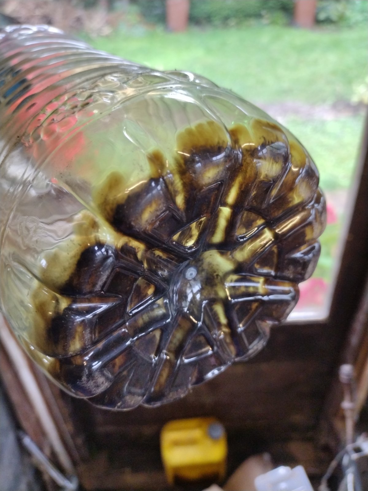

Just decanted the C5 gearbox oil into my waste oil container for the tip run. Gosh that was grim: literally lumpy towards the end!?! And this is what's left in the bottom
Crud!
Crud!
amazing what settled out over a few months!

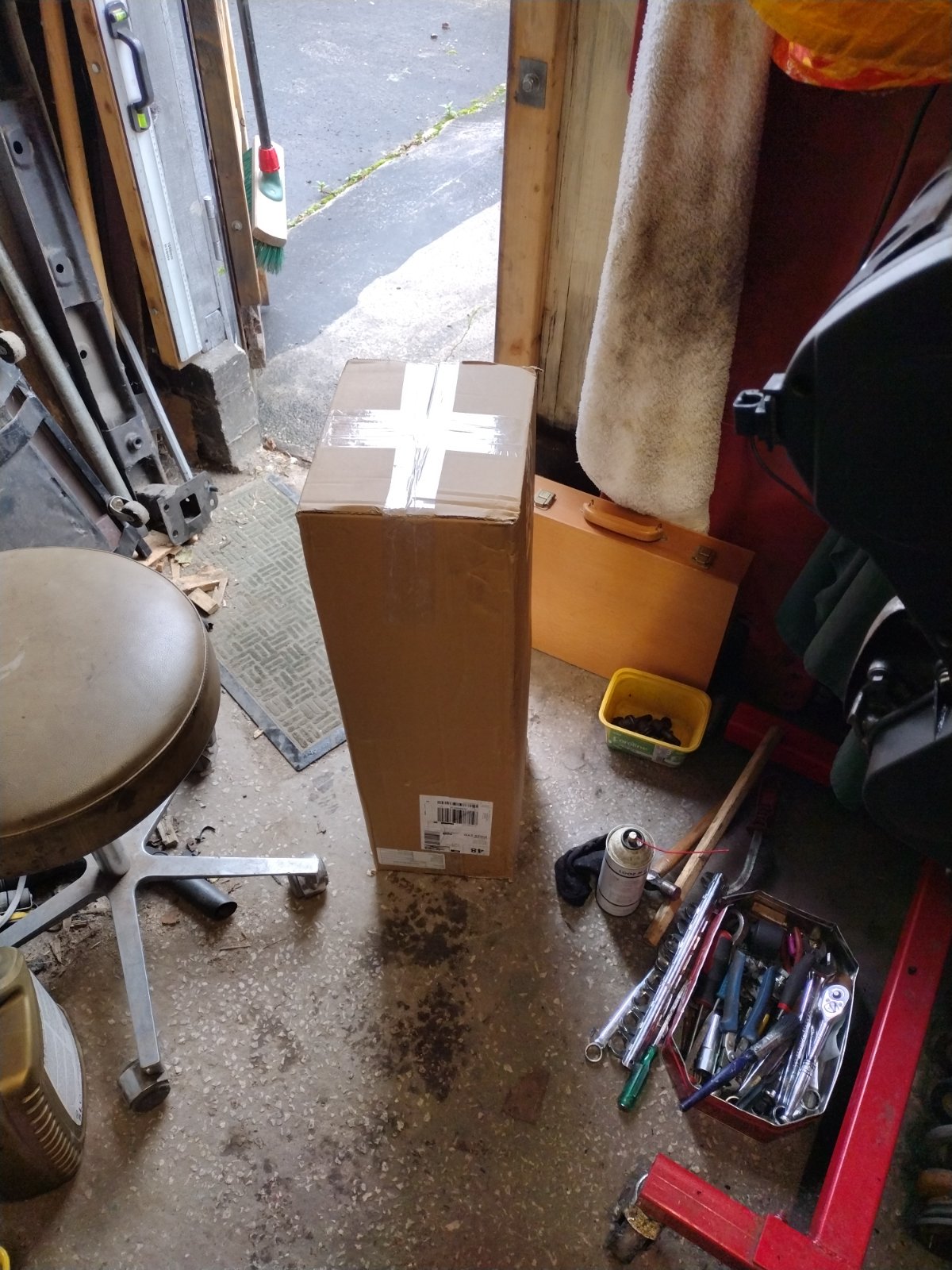

Door to door strut delivery service (Parcel Force) - he literally fetched into the garage for me :)
(Plus bonus biscuit tin content bottom right)

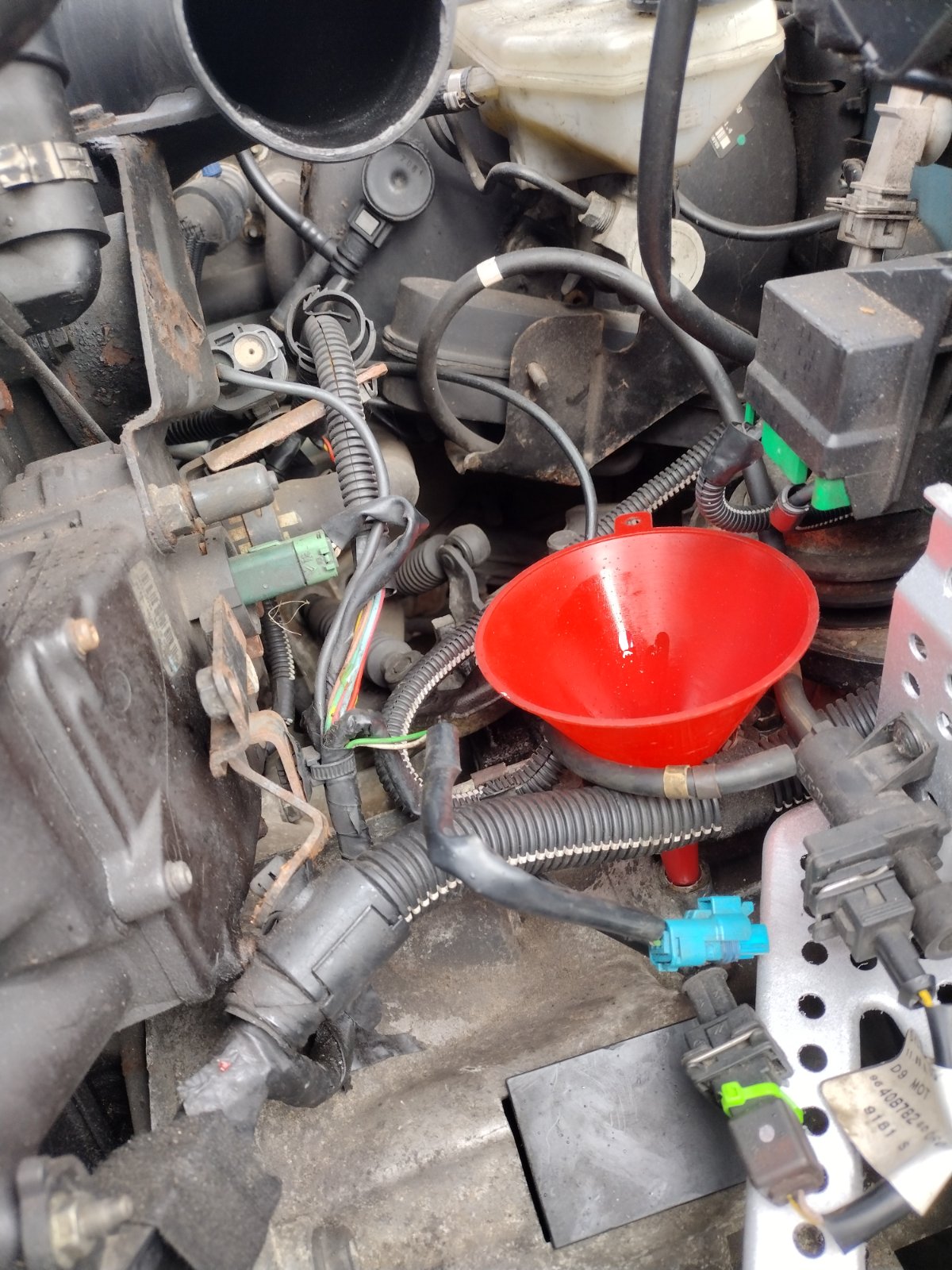

Thanks to the excellent advice from Jim, here:
viewtopic.php?t=24906
Gearbox now refilled
My normal green hosepipe on same funnel is too large outside diameter for the reverse light switch hole (is fine for a BE gearbox vent breather hole)
Rain now, dinner time
