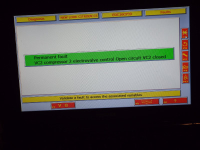

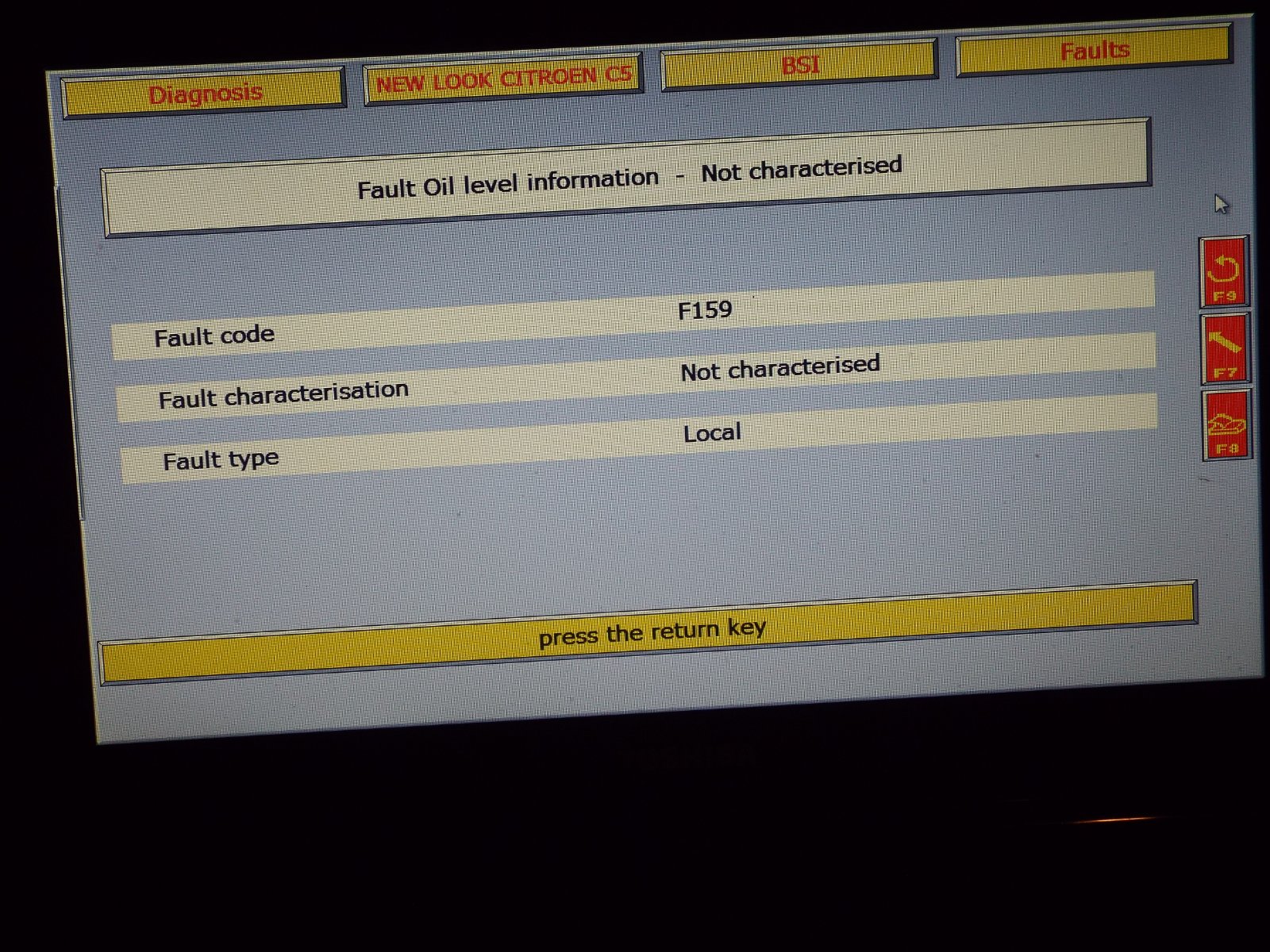

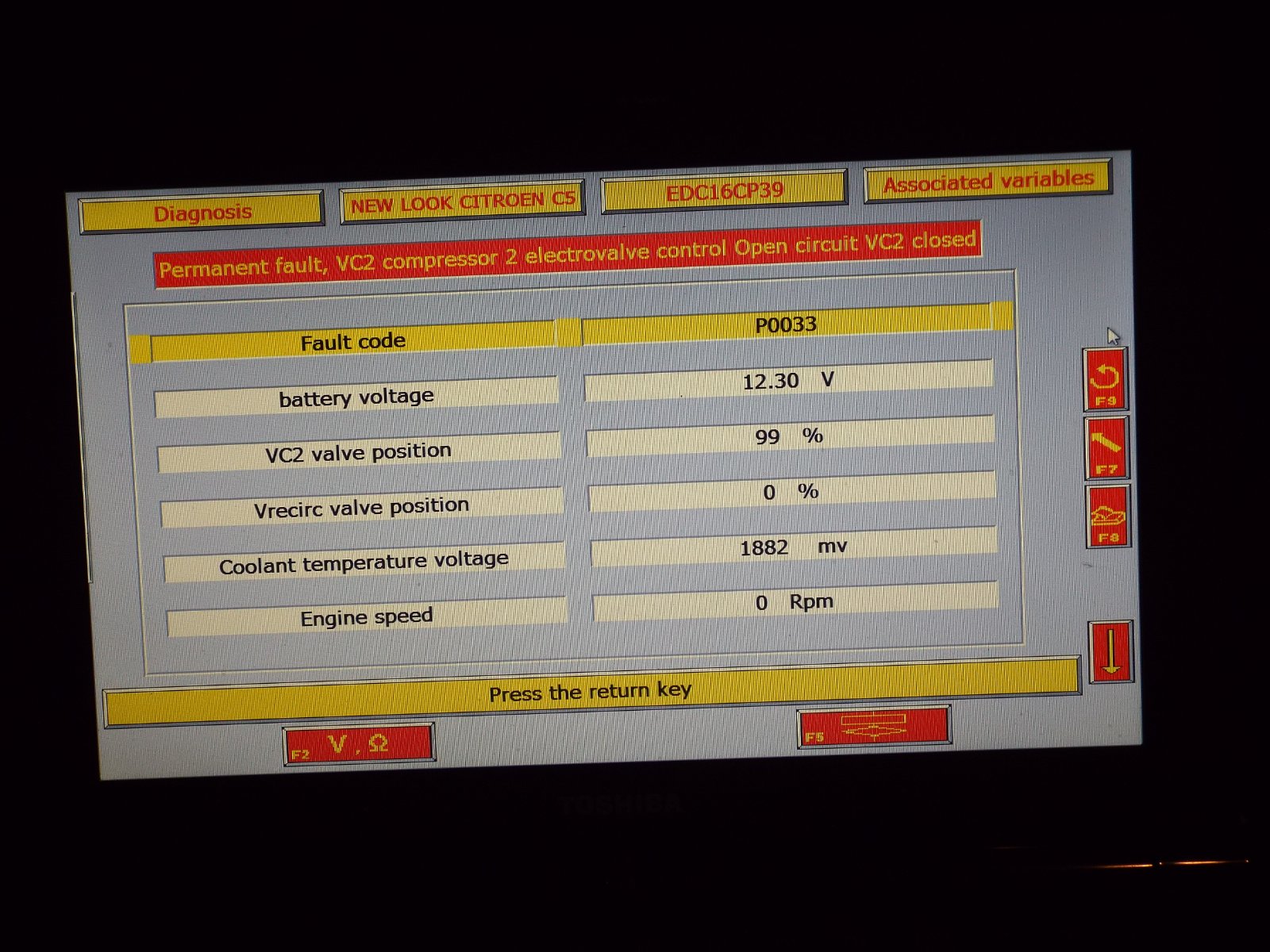

Well, the radio is showing firmware version 8.31, and the UK map is 2016/2017, so all good there. However, she has a few glitches to sort out still (I will be doing a BSi reset either this evening or tomorrow). Neither the radio or the multiscreen show up on the Lexia (no dialogue with either of them), the BSi says there is an error with the oil system (F159), while the Injection is throwing up the error P0033. This afternoon she went into limp mode (2000rpm), but with no EML.

Fault p0033 is bypass fault for turbo.. Possibly wastegate.. So possibly a vaccum electro valve like the mk. 1 C5 unless it's electric.. I'm not sure.

Where would I find the oil sensor? I want to check the wire is properly connected, and (if it is reasonably accessible) spray some contact cleaner into the connections.
Is the turbocharge purely electronically operated, or as there a vacuum 'component' involved? I want to resolve this turbo issue and I need to know where to start looking.

Oil level sensor. Is likely to be on the back of the block.

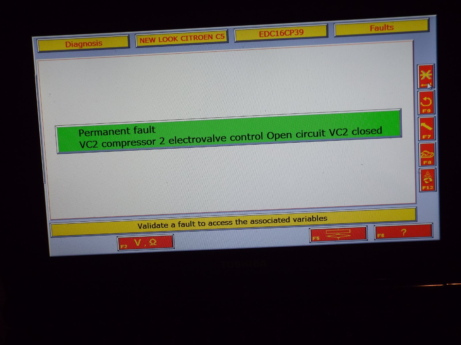

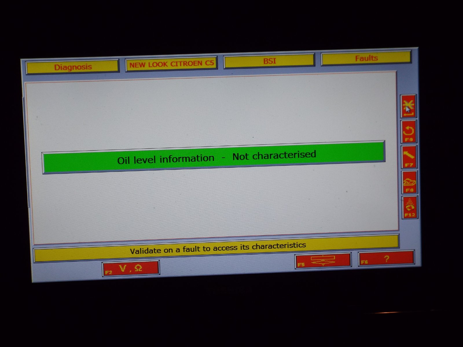

I have had the Lexia back onto the C5, with my camera. The two errors are still there. F159 in the BSi, and P0033 in the Injection. They will NOT clear, which strongly suggests they are present when the Lexia is talking to her. Neither error was there when I checked her after the engine problem occurred (I have a little book with the owner manual that I record Lexia result in).
