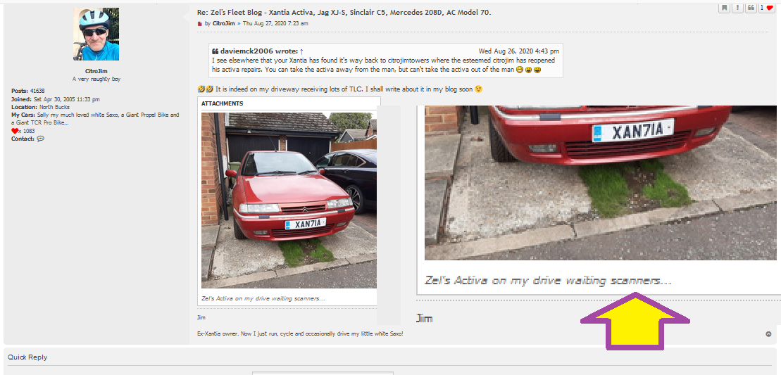

That was the over-zealous spell check on my 'phone NeilNewcastleFalcon wrote: 27 Aug 2020, 12:14CitroJim wrote: 27 Aug 2020, 07:23It is indeed on my driveway receiving lots of TLC. I shall write about it in my blog soon
Mind you, I should run my ELIT over Zel's car so in a way the 'phone got it right after all

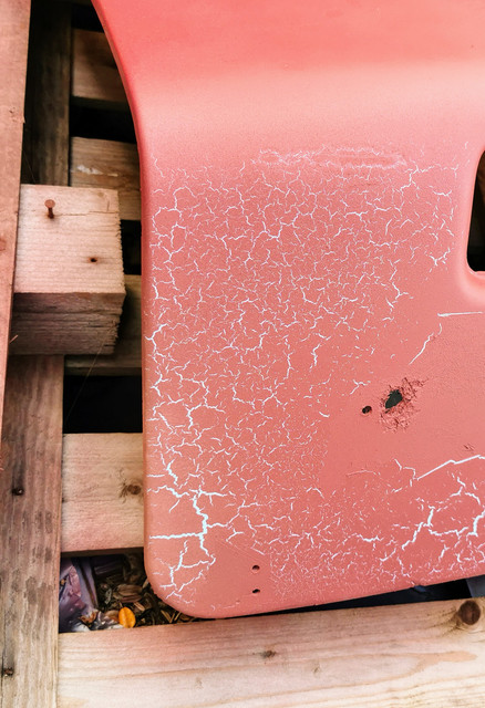

After three days of faffing around with it I've got the paint on the engine cover...looking not quite as good as it did before I started messing with it.
I just really need to accept that bodywork isn't really my forte. It wasn't going to go well when after sanding things back and degreasing the panel, the primer proceeded to do this as it dried.
The worst of that was flatted back but I had to admit to having lost patience with the job a bit by that point.
During the long cold evenings in the winter we'll see about totally stripping the panel back...or getting a professional to do it.
Trying to smarten this up was a daft idea and I should have left it alone. Will get everything put back together later...then stop messing about trying to make things pretty. Just concentrate on what it needs to be a working car that's reliable and pleasant to use.

Judging by how that engine cover is looking and all the other bodywork you've done I'd seriously disagree with that statement Zel, it looks very good indeedZelandeth wrote: 29 Aug 2020, 11:55 I just really need to accept that bodywork isn't really my forte.
That crazing is just a reaction to whatever is underneath. A very common occurrence and a change of paint to a compatible type should resolve...

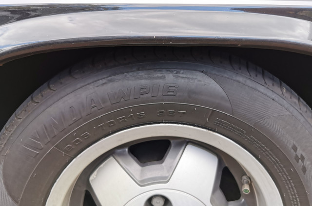

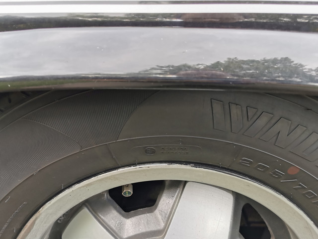

The Jag is now off the road until such point as I get the tyres replaced. The front ones are ancient and had turned to more plastic than rubber and were out of round. However at £220 apiece it's one of those jobs which it takes a bit of time to build up to, especially as my husband is now looking for work as their work contract has just come to an end, especially as while they weren't great the tyres were still legal and I just made a point of not using the car in the wet - especially as it's near impossible to keep the thing demisted without working air con. The rear ones are older than ideal but still nicely compliant and have some life left in them. However I can't really just change the front ones as the tyres it's fitted with aren't correct. It should be fitted with 215/70 R15 tyres with a W speed rating. Not the 205/70s with a H rating on the front or T on the rear.

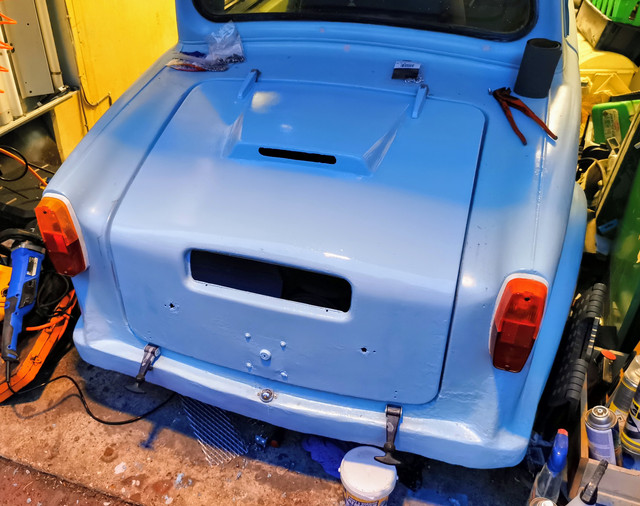

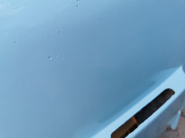

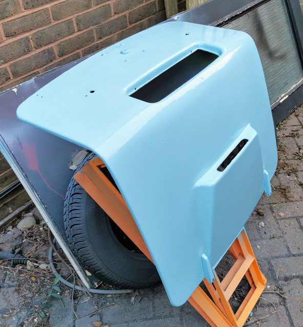

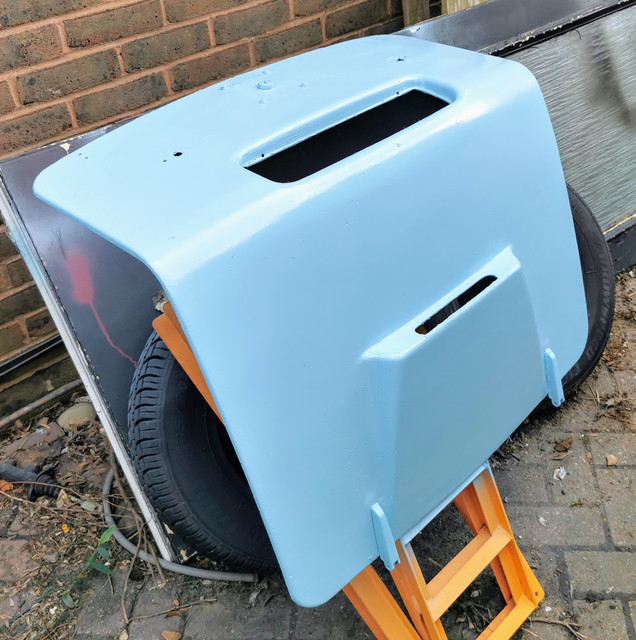

The Invacar engine cover repaint has progressed today. I gave it a skim over with the sander this morning which got rid of *most* of the remaining chunks of paint. I'm not worrying too much about it at this point as I fully realise that there are about 50 steps needed to get a properly smooth uniform finish that I have neither the time nor patience for. If I can get it back to looking reasonably cared for and more or less presentable from ten paces I'll be happy. Somewhere down the line it will need to be more aggressively stripped and sanded back, the well and truly rusted on hinges and lock removed, the surface properly filled, sanded, filled, sanded many times over, before being repainted in a proper spray booth or at least a properly equipped garage. That ain't happening today though!
A couple of thin coats of cheap. basic primer (rather than the expensive high build stuff that started this whole mess) were applied and didn't appear to do anything unexpected. So topcoat number one went on...For some reason I forgot to get a photo of the primer stage.
This was repeated a couple of times until I was satisfied I had decent even coverage, and I just had time to get the first layer of clearcoat down before it started to cool off and I started to lose the light.
It was then very carefully placed back on the car in the garage so it can cure overnight in there rather than being left outside to get damp which would almost definitely make it go cloudy.
It will want a few more coats on, but should be able to get it put back together tomorrow. Then I'll leave it the heck alone and concentrate on stuff which actually will make the car better to use rather than worrying what she looks like.

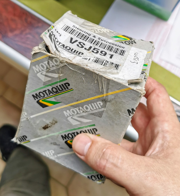

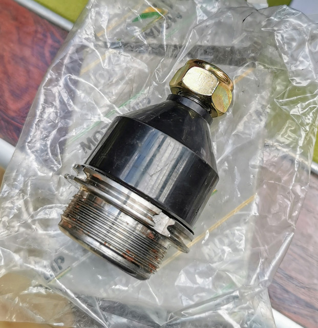

A few days ago I went through my Citroen spares stash carefully three full times checking for a lower ball joint before I admitted defeat and ordered one.
Today what did I spot sitting on the pool table...about a foot away from the P-bush which has been waiting to be dropped off at the car once the new ball joint arrives?
I must have physically picked this up and moved it TWICE when I was digging through the boxes of parts. I really do worry about the state of my brain sometimes...
Anyhow...It has now been dropped off with the car. Jim has indicated that his plan is to build up the control arm in the interim and we'll hopefully get it put back together on Friday which is when we're next both free. When the new ball joints arrive they can go back into the spares stash as ball joints are one of those things which you're always going to need at some point.

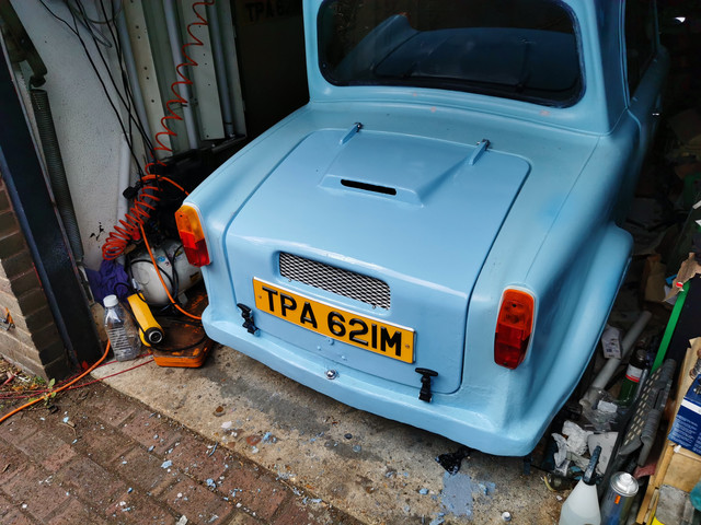

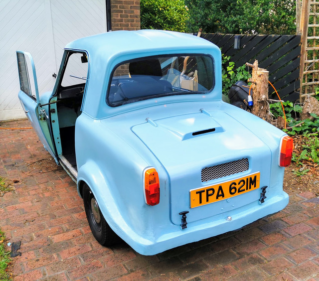

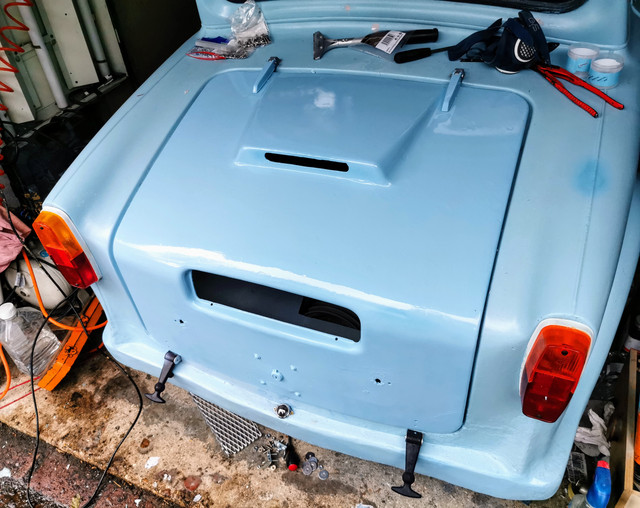

I've decided to call time on fiddling around with the paint on the Invacar for now. The finish on the engine cover isn't even close to great if you look at it up close, but given the state of the rest of the car it'll do just fine. "Obviously cared for even though rough around the edges" is the basic target we're after.
We called it good there and I set about putting things back together again.

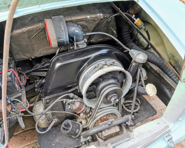

While I had the painting kit out I gave the top cowling on the engine a quick sand back and a coat of paint as it was flaking off there badly in a few spots and it was bugging me.
Something I did before putting the engine cover back on was to move the block I used to set how far forward I can pull a bit to give me more clearance at the back of the car. On three separate occasions now I have taken a chunk out of the engine cover with the latch on the garage door when turning it to lock it.
The way the door sits means that you actually have a good six inches or so less clearance than it really looks like you should have...I really don't want to have to touch in a chunk out of the engine cover there for a fourth time.

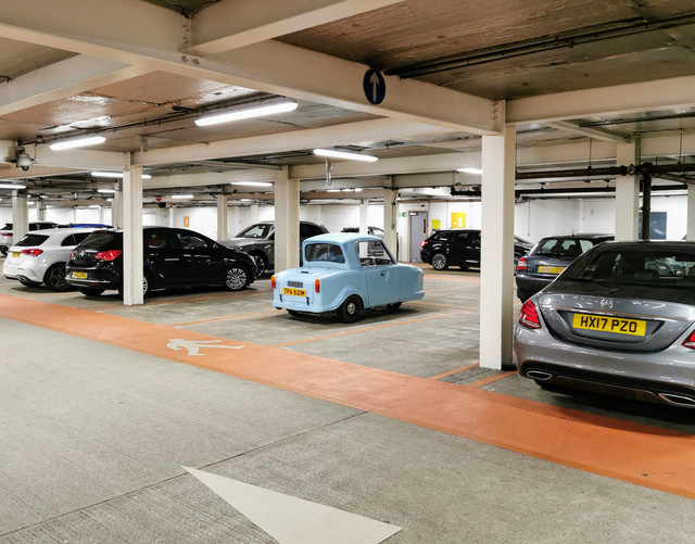

Given the Jag is now off the road until the tyres are replaced, the Xantia is still in bits and a couple of places I needed to visit today have height barriers, she was immediately dragged out of the garage and pressed back into service.
It's definitely one of the easiest ways of making normal sized parking spaces look comically huge.
She's a bit tidier now than the first time I took a photo of her in that car park on her first trip out onto the road...Still held together by duct tape, cable ties and hope!

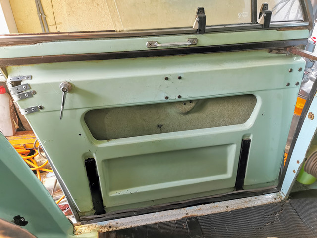

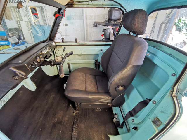

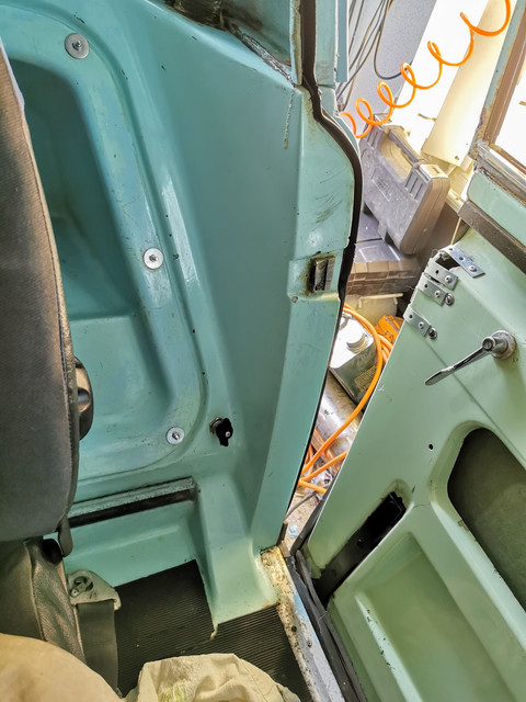

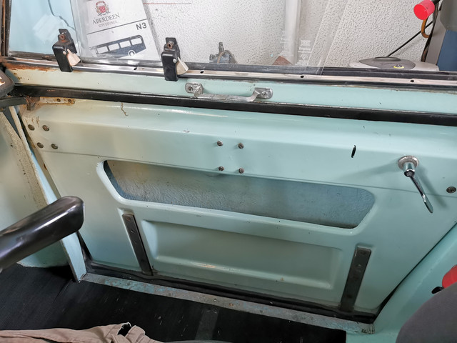

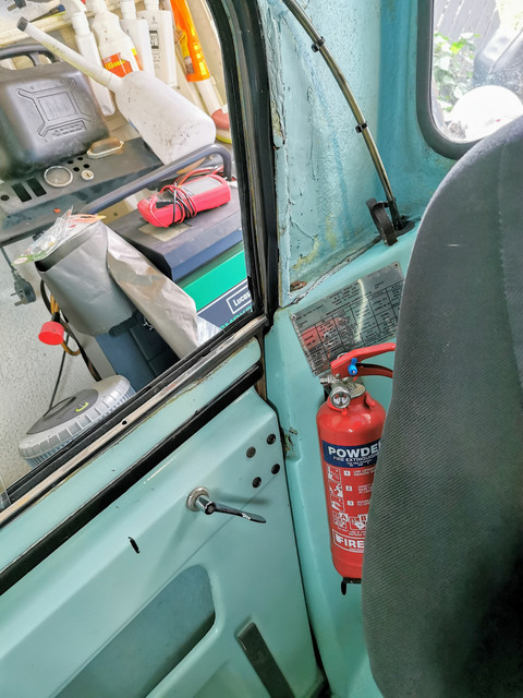

Now the Invacar is back into regular-ish use I figured it was time to start trying to properly clean the interior a bit. I'd got the very worst of the grime off originally, but there were quite a few areas which needed more detailed attention. This is where we left off after maybe an hour or two.
At a glance not a huge difference, but a lot of the effort has been in some of the smaller areas. Particularly the doors, both of which had quite a lot of rust staining down below where the windows had been leaking for decades.
This one was particularly bad at the front. I'll need to put a touch of paint at the front there as it's actually stained the fibreglass below the runner, but it's a lot better. I also need to get the thinners and remove that paint drip just forward of the door handle as that's driving me crazy.
Nearside door wasn't anywhere near as grubby at least.
The colour IS that different, I believe one of the doors is an Invacar made one, the other is AC made. I *really* need to do something more elegant by ways of a repair to that rear corner. The only reason I didn't glass it up originally was fear of getting resin into the door latch assembly. Realistically I'll need to get the latch out to do this properly (or anything vaguely resembling properly).

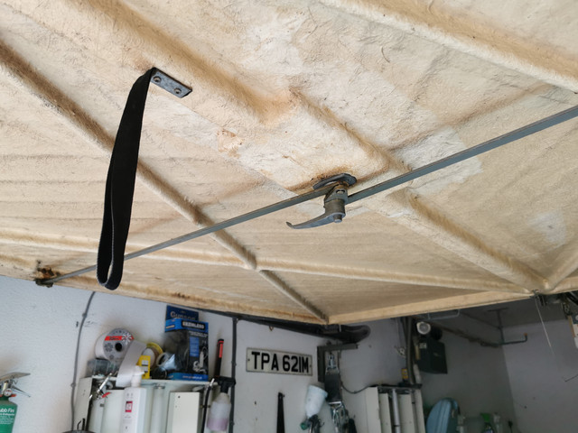

In addition to the doors, the area between them and the rear bulkhead is looking a lot better now.
The access hatch really needs hitting with the power polisher and some cutting paste to try to get rid of some of the flaky paint etc on it but we're getting there.
Definitely need to look at getting the flooring sorted out because it is really letting things down - and I'm fed up of nearly faceplanting into the tarmac when climbing out.
Small stuff in the grand scheme of things, but making the car a nicer place to be is important in my book.

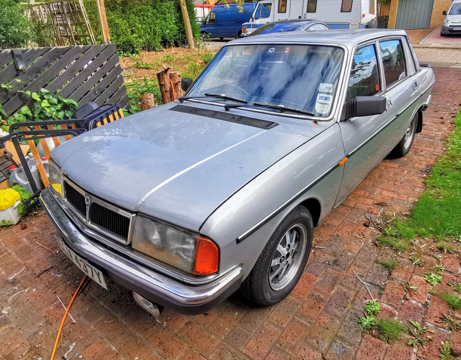

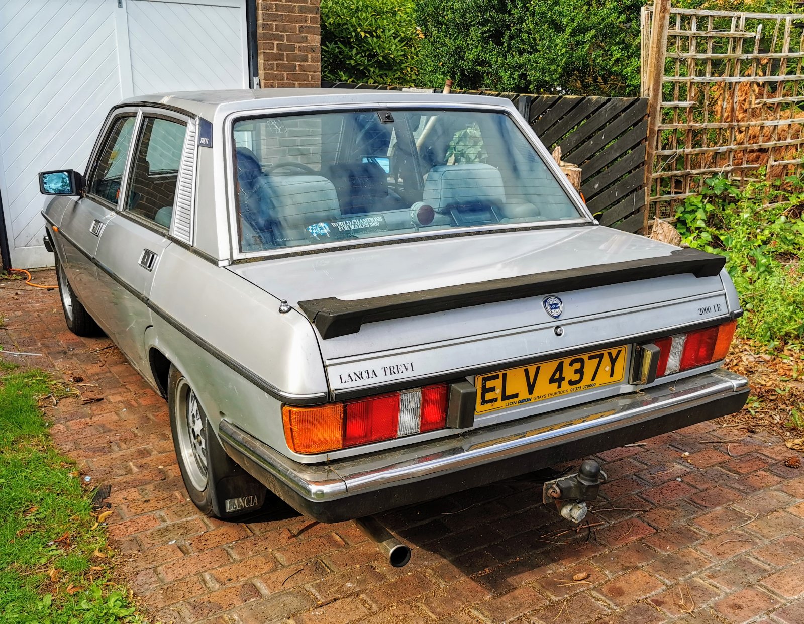

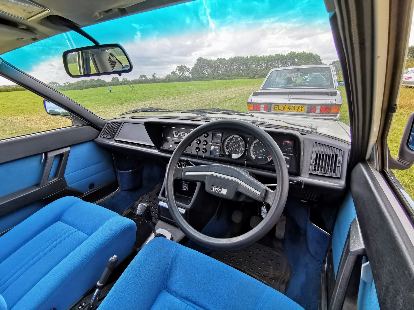

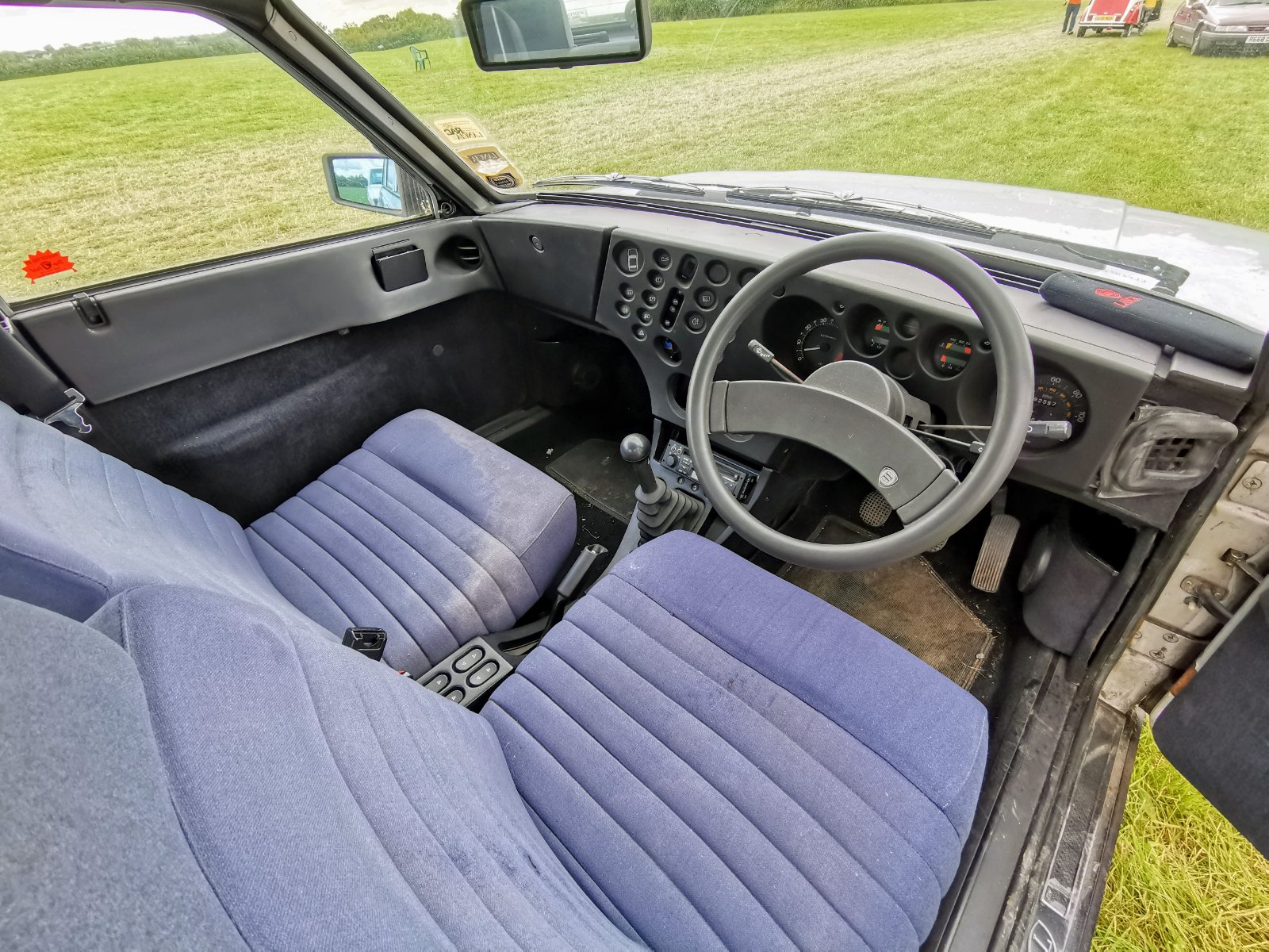

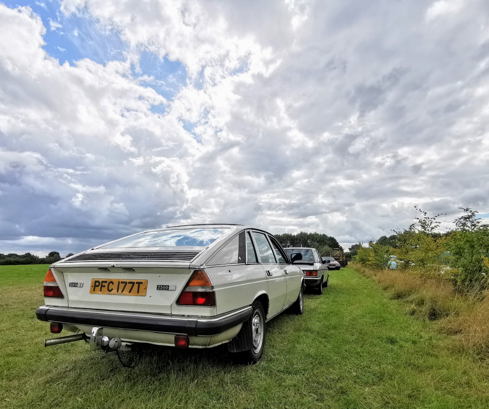

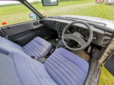

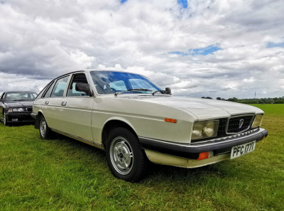

I feel quite honoured that a friend has entrusted me with a very rare bird in need of some minor electrical rehabilitation.
I really miss Lancia from this era. They really were one of those companies who just did things their own way for better or for worse. I've never really had much exposure to them until recently, but between the Gamma Berlina and this one I'm finding myself quite drawn to them. The Gamma is absolutely on my lottery win shopping list in a heartbeat. Never mind how pretty a car it is, it's just so, so comfy. The ride in particular has nearly Citroen levels of waft to it which I was absolutely gobsmacked by.

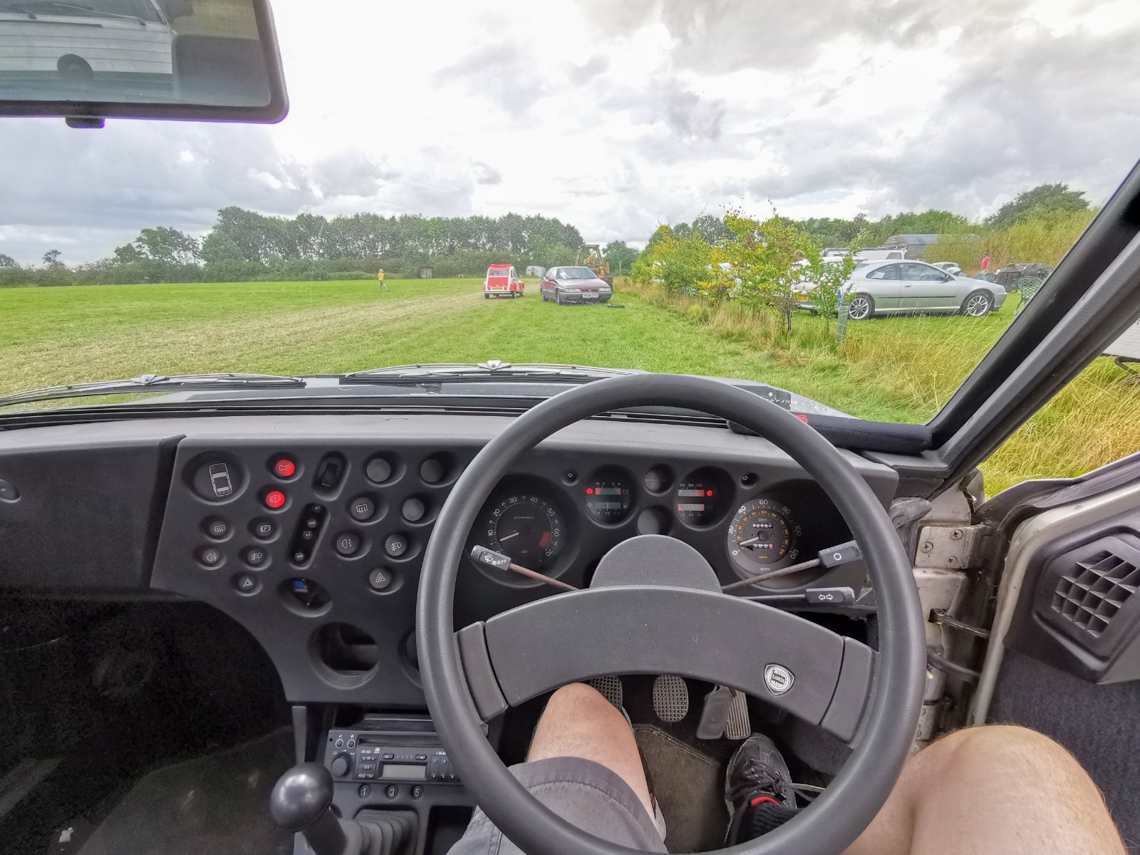

I want one of these in my life...
So, so comfy...

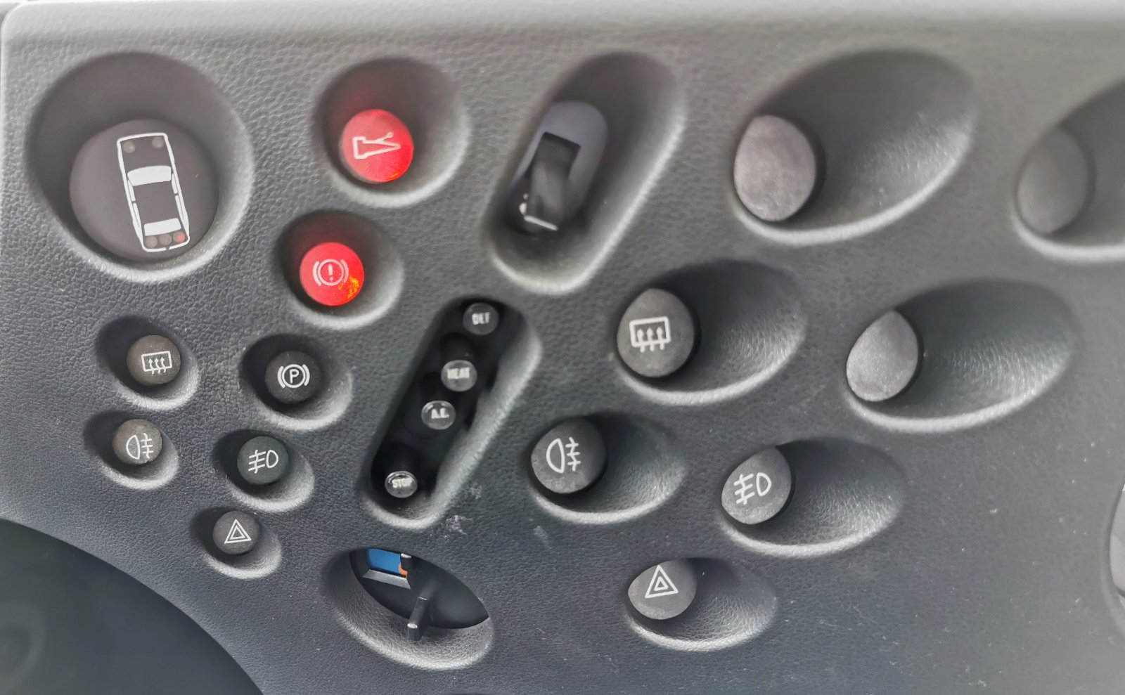

Nothing too groundbreaking I'm doing here. The biggest complaint is an erroneous bulb failure warning from the tail lights (which also lights a large red "central warning" light which is essentially the equivalent of the "Check Gauges" light on some US car dashboards) which I've already pretty much traced to a dodgy ground. The walkround test pretty much did this as I ascertained that the indicator flash rate on the affected side dropped by roughly half whenever the headlights of brakelights were activated. Looking at it after dark you can see that whenever either of those lights are on, the indicator bulb is also glowing barely visibly. I'm not even going to go hunting the dodgy earth here, I'm just going to clean up and/or reterminate any ground connections I can find anywhere in the vicinity of the tail lights. Given this is an Italian car, never mind one that's been sitting unused for many years, they're all probably going to cause trouble at some point if not fettled.

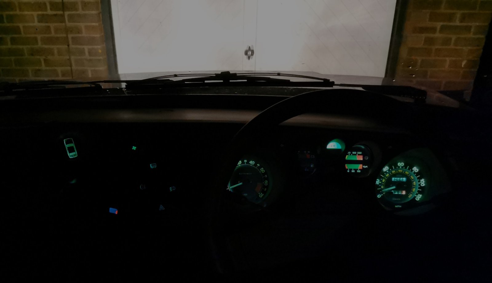

The other job is to do a blanket replacement of the dash lighting lamps as it's looking a bit sad just now.
There are at least two lamps out and there's a lot of light leakage out behind the "damage report machine" into the area around the dash warning lights which are just below it. I don't know if the switchgear uses the same fibre optic setup as a lot of 80s Fiats to light them, if so I'll probably convert that to use an LED as the light source to bring the illumination level up to better match the rest of the dash. I don't see any need to mess with the rest of it as the dash is actually quite nicely lit and knocking the dash rheostat down to 95% rather than flat out should make the lamps last perfectly fine.
I don't *think* there's actually any illumination of the demist/AC/Off control buttons...but I'll confirm that when I've got the panel out. It's hard to tell just looking at it.
The dash in this car is something else. Heck, the design of the whole interior is something you'd expect to be on a concept car rather than something that actually hit the market.
Those seats are wonderfully comfy.
While the dash looks absolutely mental in photos, especially from that sort of angle...I was surprised when sitting in the driver's seat that the ergonomics and sightlines actually work astonishingly well. Oil/Temp/Volts/Fuel warning lights are directly in front of you next to their gauges, and the rest of the lights while slightly further out of your eyeline than they would be on a normal instrument panel, are at least twice the size they would be on a normal instrument panel and are angled towards the driver...I can't see visibility being an issue.
I really wasn't sure what to make of it initially, but it's very much grown on me.
Looking forward to getting stuck into this. I want to double-check the charging voltage too as according to the gauge on the dash it's a touch low...though I trust that gauge to be about as accurate as a Channel 5 weather forecast, it's most likely just fine.
Still feel quite honoured to be trusted to work on such a rare motor.
So, so comfy...

What an absolutely awesome dash in a very gorgeous car Zel
I can see why you'd love one in your life!
Looks like that dash could be a lot of 'fun' to remove! Or is it a lot easier then it looks?
