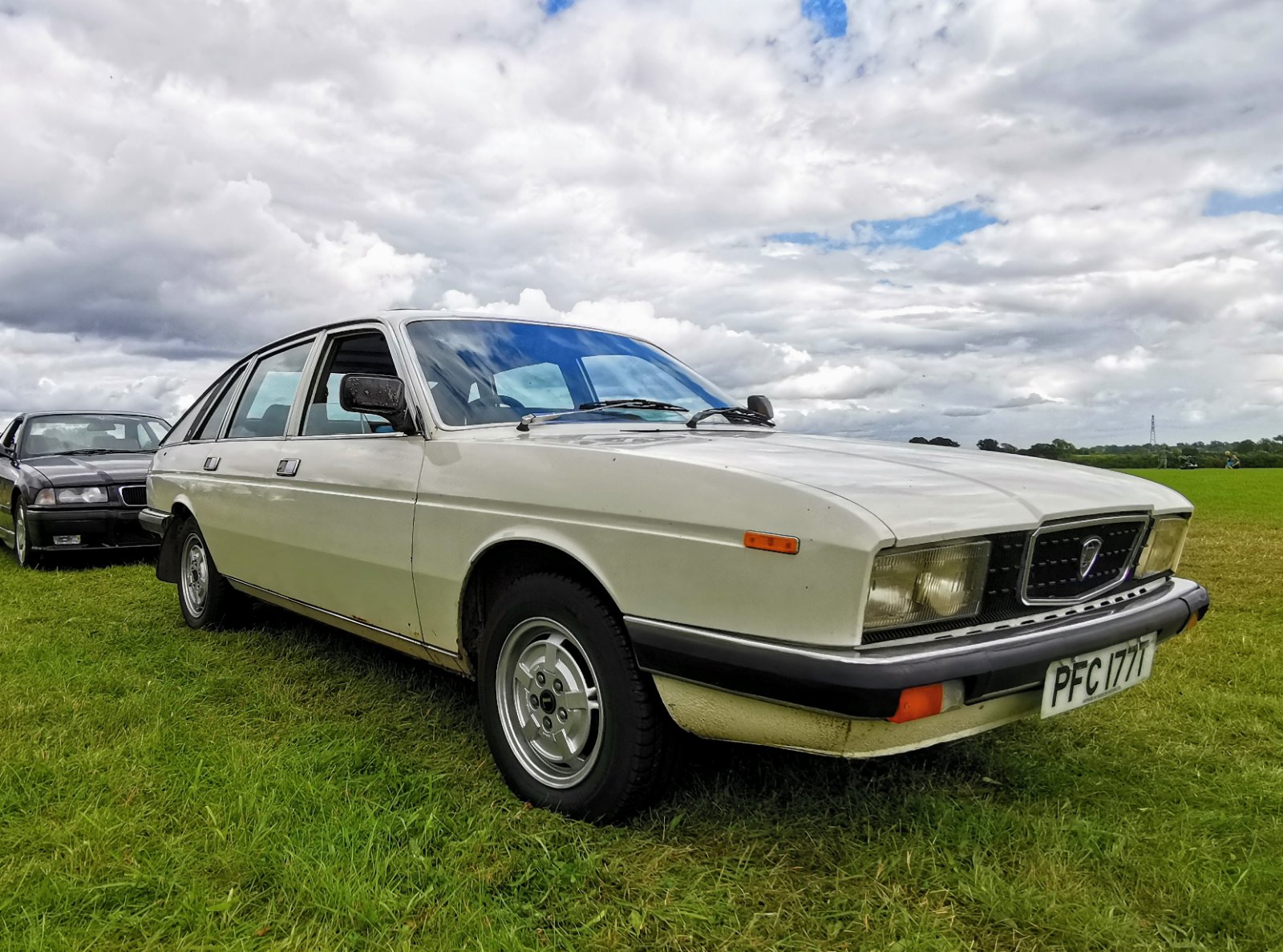

I feel quite honoured that a friend has entrusted me with a very rare bird in need of some minor electrical rehabilitation.
I really miss Lancia from this era. They really were one of those companies who just did things their own way for better or for worse. I've never really had much exposure to them until recently, but between the Gamma Berlina and this one I'm finding myself quite drawn to them. The Gamma is absolutely on my lottery win shopping list in a heartbeat. Never mind how pretty a car it is, it's just so, so comfy. The ride in particular has nearly Citroen levels of waft to it which I was absolutely gobsmacked by.
I want one of these in my life...
So, so comfy...
Nothing too groundbreaking I'm doing here. The biggest complaint is an erroneous bulb failure warning from the tail lights (which also lights a large red "central warning" light which is essentially the equivalent of the "Check Gauges" light on some US car dashboards) which I've already pretty much traced to a dodgy ground. The walkround test pretty much did this as I ascertained that the indicator flash rate on the affected side dropped by roughly half whenever the headlights of brakelights were activated. Looking at it after dark you can see that whenever either of those lights are on, the indicator bulb is also glowing barely visibly. I'm not even going to go hunting the dodgy earth here, I'm just going to clean up and/or reterminate any ground connections I can find anywhere in the vicinity of the tail lights. Given this is an Italian car, never mind one that's been sitting unused for many years, they're all probably going to cause trouble at some point if not fettled.
The other job is to do a blanket replacement of the dash lighting lamps as it's looking a bit sad just now.
There are at least two lamps out and there's a lot of light leakage out behind the "damage report machine" into the area around the dash warning lights which are just below it. I don't know if the switchgear uses the same fibre optic setup as a lot of 80s Fiats to light them, if so I'll probably convert that to use an LED as the light source to bring the illumination level up to better match the rest of the dash. I don't see any need to mess with the rest of it as the dash is actually quite nicely lit and knocking the dash rheostat down to 95% rather than flat out should make the lamps last perfectly fine.
I don't *think* there's actually any illumination of the demist/AC/Off control buttons...but I'll confirm that when I've got the panel out. It's hard to tell just looking at it.

I've had two of those Gammas, well I bought and sold them never kept them for my own use.
One as in your photo and the other a coupe.
The coupe didn't need much prep but the saloon had head gasket troubles, two heads off then discovered both camshafts were worn out, took an age to source used replacements and a right headache to set up the valve timing.
