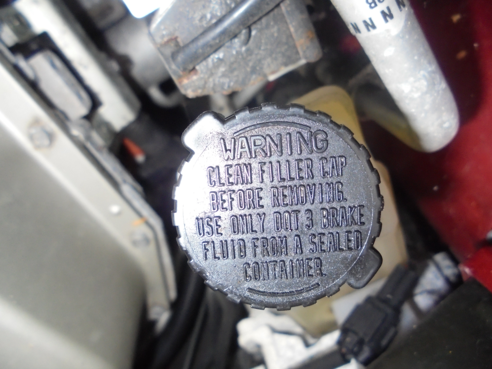

Got the job done on the Leaf, bought new shoes for the disc/drum handbrake combo, but didn't bother fitting them old ones had plenty left, just did a bit of a clean up.
Obvious really, but back off the handbrake adjuster by clicking the cog through the hole for that purpose in the "disc drum" and the disc just pops off without any hammering.
Caliper Pistons were just push in, slackened off the 8mm Bleed nipples after giving the rust at the base where it enters the caliper a bit of rust removal and spray. What are car makers thinking of...8mm Bleed nipples, do they want you to buy a new caliper when they shear off :?: :-D Luckily both sides undid without drama.
The little bit of brake fluid spurted out on pressing the pistons back is hardly worth opening a bottle of the specified DOT3 for and the Master cylinder is still pretty much at Max.
So the first proper maintenance dirty hands job is done on the Leaf. Just like any other car except parts are a touch more expensive than on the bog standard 16 year old BB Micra.
Went with ECP as usual for convenience, but no doubt about it in my recent experience, although to all intents and purposes the same, carparts4less, undercut ECP prices (after disc) for exactly the same parts by a decent margin if you can wait for the free delivery to arrive.
