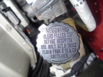

Got the job done on the Leaf, bought new shoes for the disc/drum handbrake combo, but didn't bother fitting them old ones had plenty left, just did a bit of a clean up.
Obvious really, but back off the handbrake adjuster by clicking the cog through the hole for that purpose in the "disc drum" and the disc just pops off without any hammering.
Caliper Pistons were just push in, slackened off the 8mm Bleed nipples after giving the rust at the base where it enters the caliper a bit of rust removal and spray. What are car makers thinking of...8mm Bleed nipples, do they want you to buy a new caliper when they shear off :?: :-D Luckily both sides undid without drama.
The little bit of brake fluid spurted out on pressing the pistons back is hardly worth opening a bottle of the specified DOT3 for and the Master cylinder is still pretty much at Max.
So the first proper maintenance dirty hands job is done on the Leaf. Just like any other car except parts are a touch more expensive than on the bog standard 16 year old BB Micra.

I'm quite surprised they specify DOT 3 fluid, it's a bit old hat.

Gibbo2286 wrote: 02 Sep 2021, 10:05 I'm quite surprised they specify DOT 3 fluid, it's a bit old hat.
Has anyone got round to stripping that rattling transmission yet?
DOT3 and nothing else will do :-D
