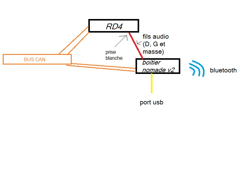

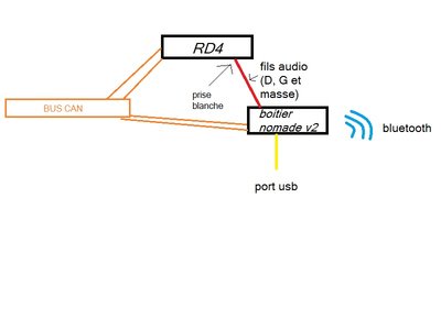

Sorry if I'm missing something here.
On some RD4 cars, the USB is connected to the radio via the Nomad box, this box acts as a virtual CD changer and therefore connects to the CD changer part of the Quadlok. I assume the RT6 has it's own USB controller on board therefore a different USB socket is required that connects directly to the RT6.
Unless you have and actual 6 CD changer, nothing should be in the part C of the RT6.

Xantippa
- Posts: 490
- Joined: 05 Feb 2012, 15:51
- x 29
Re: C5 X7 2-in-1 navigation tutorial
Second plugs directly into RT6! I would just buy that set and replace your existing usb plug with that and connect it directly RT6. No need to worry about location of that nomad-box.
I think that nomad-box was workaround to get usb- and bluetooth support for RD4 and that's why it connects differently. So you cannot connect RD4 usb and RT6 usb same way.

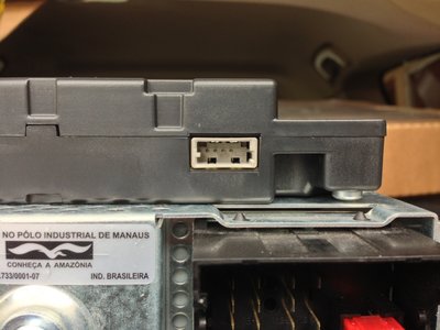

Look what I have just found. Seems that this is the nomade module. And it has two connectors, the small one is for usb and aux. what do you think, is this the same with usb connector from RT6?
vlad2004v
- Posts: 88
- Joined: 27 Sep 2017, 13:30
- x 2
And for me seems these are exactly the same. So what I have to do is to find the nomade module and unplug the usb connector, and plug it into rt6. I think the same I need to do for microphone but who knows which are the two wires....and where to link them.

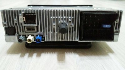

Here is the RT6 pinout
Look for microphone, Pin 3 and Pin 9 of "CC" is the microphone, you may habe to run a new cable (I did)
Throw the Nomade box away and connect the USB socket directly to the RT6.
