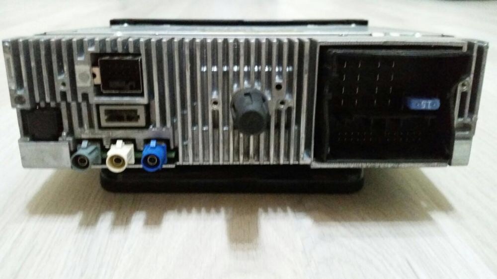

On some RD4 cars, the USB is connected to the radio via the Nomad box, this box acts as a virtual CD changer and therefore connects to the CD changer part of the Quadlok. I assume the RT6 has it's own USB controller on board therefore a different USB socket is required that connects directly to the RT6.
Unless you have and actual 6 CD changer, nothing should be in the part C of the RT6.

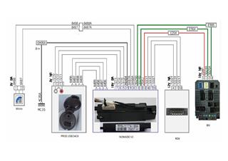

Where is this Nomad Box? Perhaps the cable from my hand rest USB port is plugged in into that box. If I can find it, I can unplug the grey conector and plug it into RT6 directly.

As you can see here,
http://m.aliexpress.com/item-desc/2041304339.html
This USB Port has one cable,probably like mine. One side is plugged into USB Port, the second into......... where?

Second plugs directly into RT6! I would just buy that set and replace your existing usb plug with that and connect it directly RT6. No need to worry about location of that nomad-box.

I think that nomad-box was workaround to get usb- and bluetooth support for RD4 and that's why it connects differently. So you cannot connect RD4 usb and RT6 usb same way.

Look what I have just found. Seems that this is the nomade module. And it has two connectors, the small one is for usb and aux. what do you think, is this the same with usb connector from RT6?

And for me seems these are exactly the same. So what I have to do is to find the nomade module and unplug the usb connector, and plug it into rt6. I think the same I need to do for microphone but who knows which are the two wires....and where to link them.

Here is the RT6 pinout
Look for microphone, Pin 3 and Pin 9 of "CC" is the microphone, you may habe to run a new cable (I did)
Throw the Nomade box away and connect the USB socket directly to the RT6.

Well done guys, that sounds like it and makes sense. I could see from my earlier posts and diagrams that there was a aux mulimedia block, so no doubt it is this that is providing the bluetooth and the music using the CD changer wiring. I struggled to see how the USB can be wired into part C.
