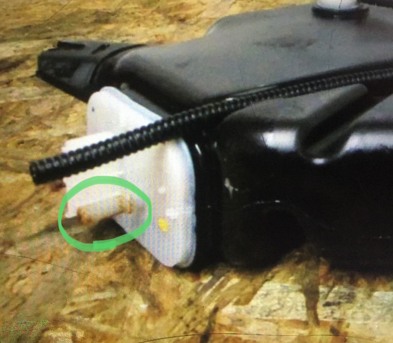

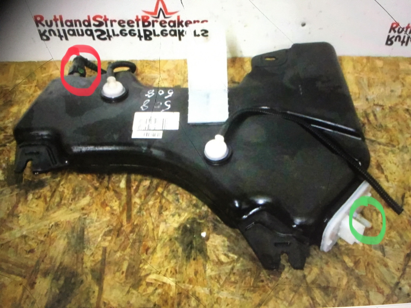

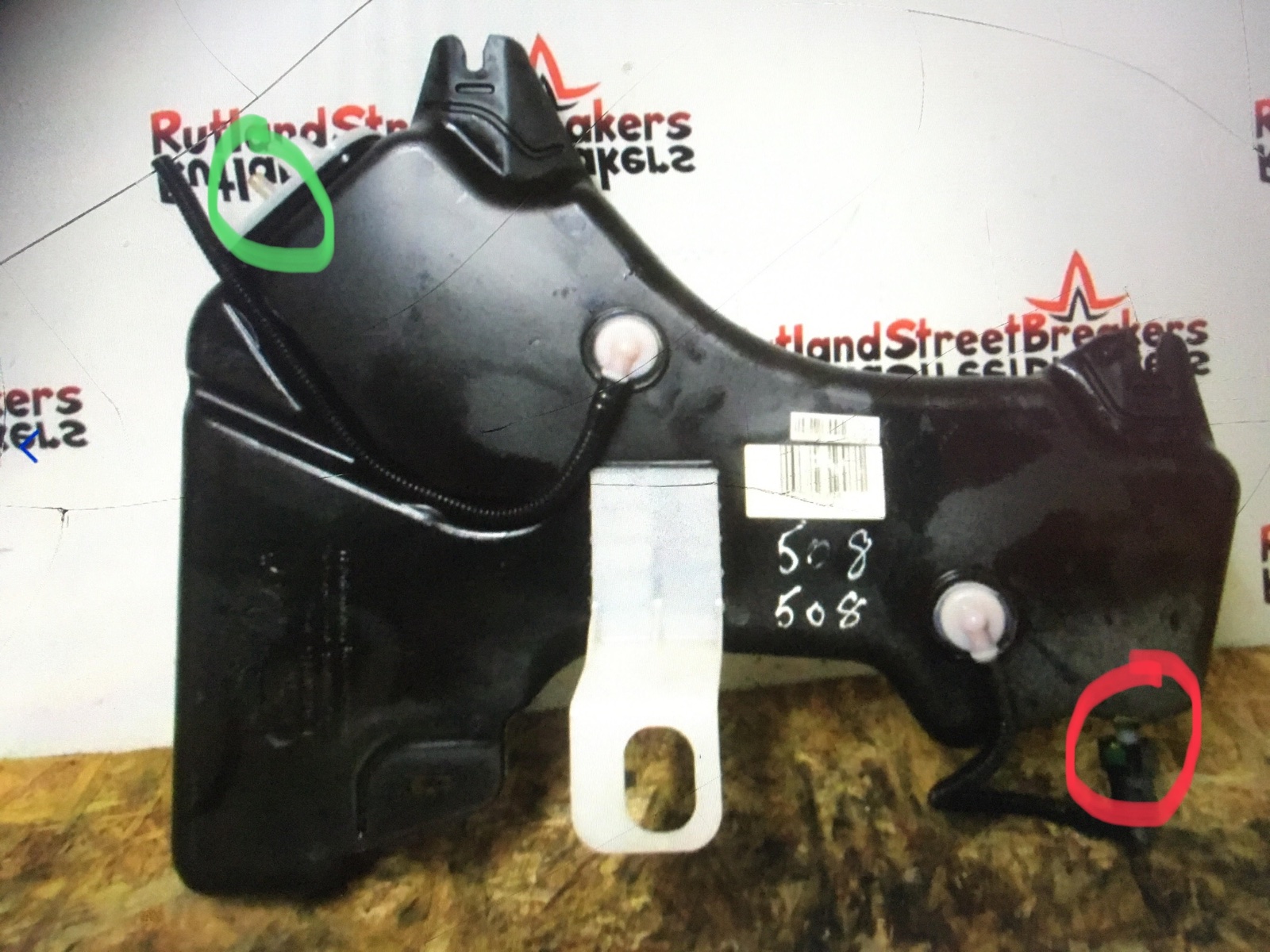

Hi Marc, and thanks again for the help on this. I have watched all the available videos on YouTube, but the tanks are all slightly different depending on the car, and there is no video for my C5.
I found some photos of a second hand tank on eBay, and have attached the photos, my big question is does the fluid go in via the placement marked in red or the one marked in green ? And if it’s the one marked in red, is it via the “male” part, that’s part of the tank or the “female” connection that’s removed ?

Re: Eolys?
In your 1st picture you disconnect the flexible pipe & fill it through the actual flexible part, the plastic bit that is left sticking out is the bit it over flows out if you add too much.
Your kit should have a male-male adaptor in it to allow the filler pipe to fit into it.

Re: Eolys?
Thanks wheeler, so just to make sure in not missing it ( I’m so nervous with this car) in disconnecting it and it’s going in the direction marked below. I must sound like a complete idiot but I just want to make sure.
Many thanks again
