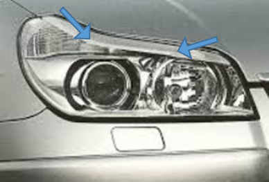

Thanks Marc. Any idea why I get no side lights at the front of the car but they seem to.work at the back. I've checked for little sidelight bulbs at the front they just don't seem to be there. The sidelight setting in the car on the left stalk only. Lights the dials the radio panel and the rear sidelights. Am I missing something or doesn't the exclusive have front sidelights? Sorry to be a pain but this kind of important what with winter dark days. Cheers Nigel. PS maybe they did away with them in the facelift exclusive?

Yes the sidelights are there Nigel - they are not immediately obvious, as they are incorporated along the inner / upper of the boomerang lamp where the headlamp plastic tends to change colour and it takes an H6W.
In the picture below, the side light is almost like a strip arrowed. There is one bulb for this in each headlamp. If it is not illuminating the front then it's bulbs for sure.

Thanks again Marc. Are they easy to get to lifting the bonnet they don't look easy to get toGiveMeABreak wrote:Yes the sidelights are there Nigel - they are not immediately obvious, as they are incorporated along the inner / upper of the boomerang lamp where the headlamp plastic tends to change colour and it takes an H6W.
Strange that they should both go together. Thanks regards Nigel.
