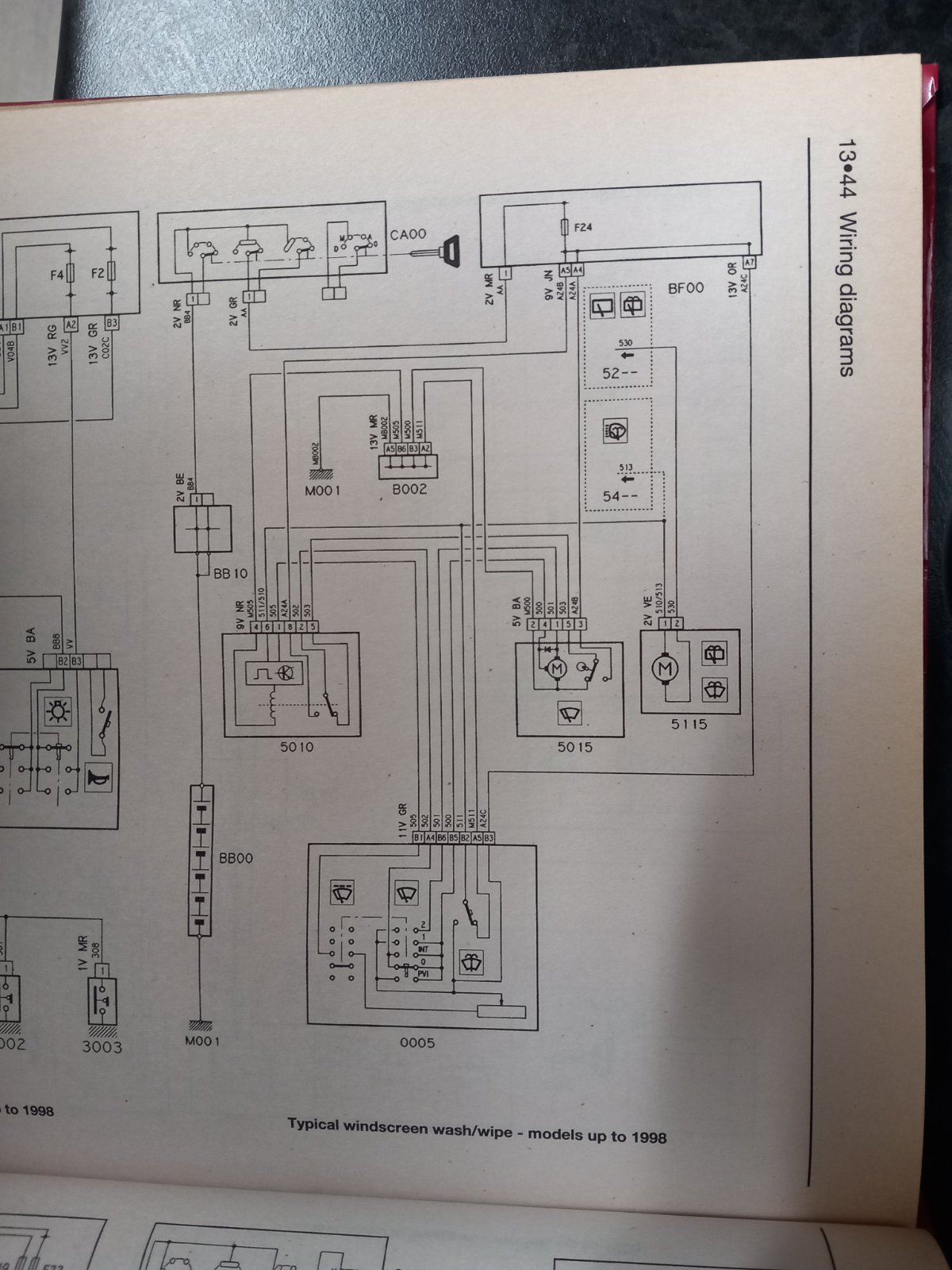

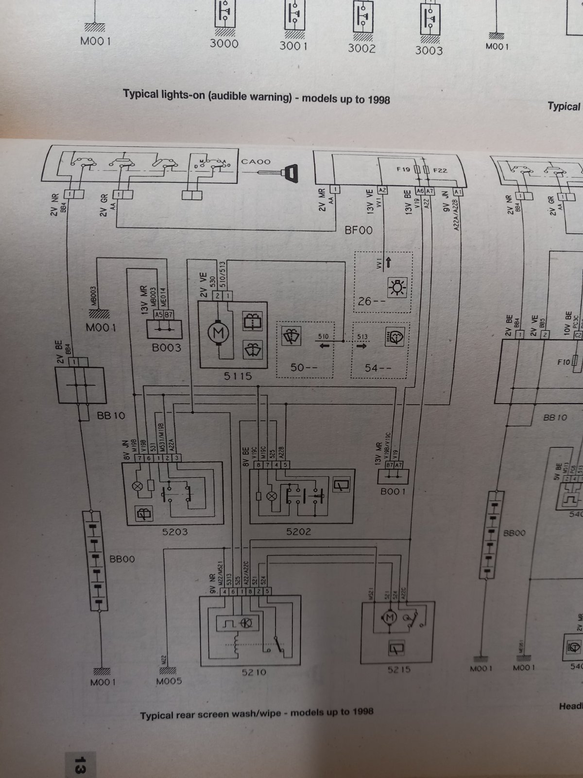

Here's the relevant wiring diagrams:
The washer pump is item 5115...

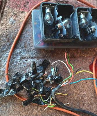

and I was wondering why the lights on my "new" trail board (came with the car) were not working well.....
Re-wire time !
Re-wire time !

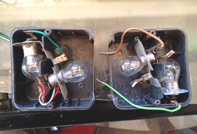

They do Matt....I do not think they have been under water. The car was owned by a very experienced "sailor" and naval engineer.... I expect he had the nous to remove his light board before dunking his boat in the water.
All cleaned up, contacts on the bulbs buffed (they all work !), earths and live connectors tightened etc....all works on the bench power source........will re-make the main cable and rewire these to it with new end fittings next.
