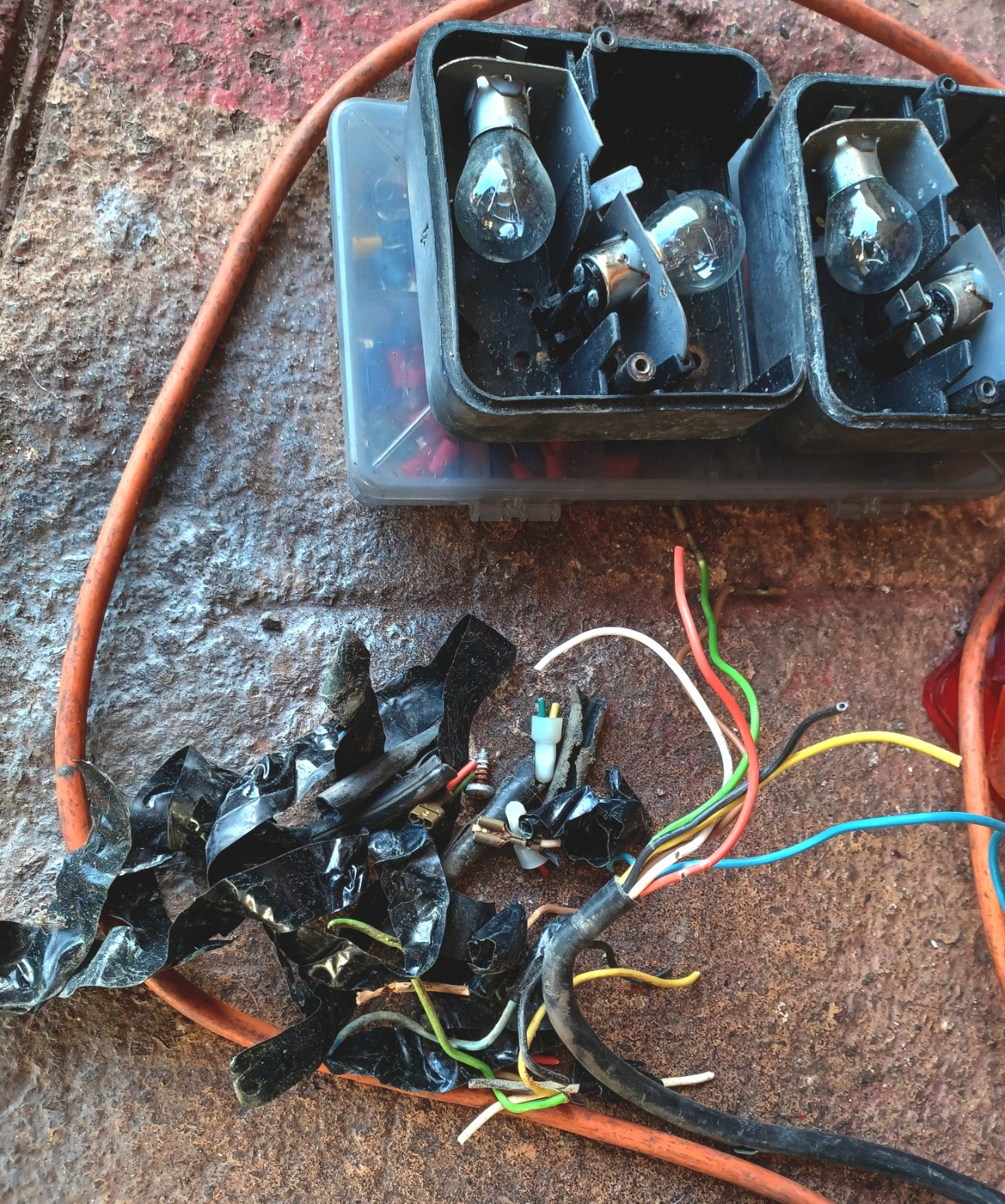

and I was wondering why the lights on my "new" trail board (came with the car) were not working well.....
Re-wire time !
Re-wire time !

Re: Xantia 1.9TD....wake up and back on the road after 10 Years
Spaghetti junction!

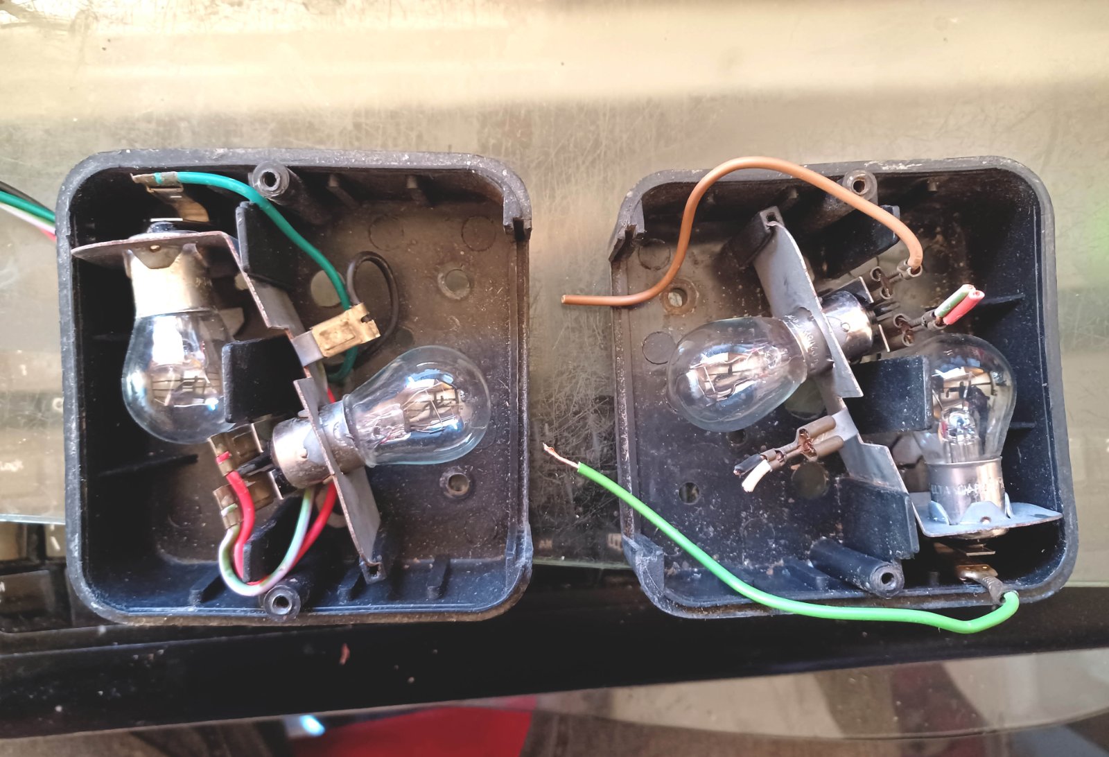

They do Matt....I do not think they have been under water. The car was owned by a very experienced "sailor" and naval engineer.... I expect he had the nous to remove his light board before dunking his boat in the water.
All cleaned up, contacts on the bulbs buffed (they all work !), earths and live connectors tightened etc....all works on the bench power source........will re-make the main cable and rewire these to it with new end fittings next.
Back board lights all working now....there is even a "bleeper" to warn me when I reverse ...that thing is coming off ASAP, bloody annoying ! WHY !!! ??
