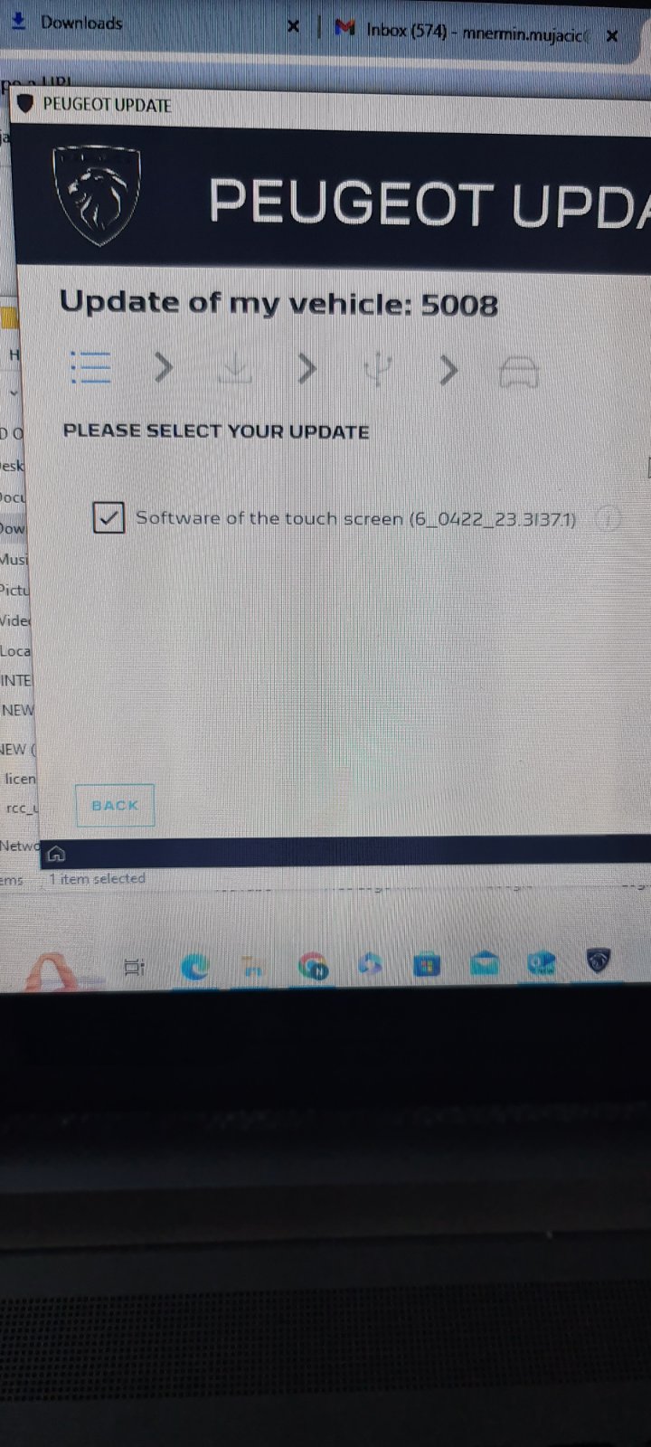

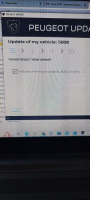

I try to update my peugeot 5008 softwer touch scren thru downloading the softwer and putting on usb, but cant install it , update come to 54% and black screen shows and start again. What is the problem how to install it now. Any help please...
- x 6945
Re: PSA NAC RCC Updates
There are issues with the update app. If you need help with a manual update, I'll require your VIN. Please post your VIN in full without spaces - it will be automatically masked from public view after submitting your post & will only be visible to staff.
