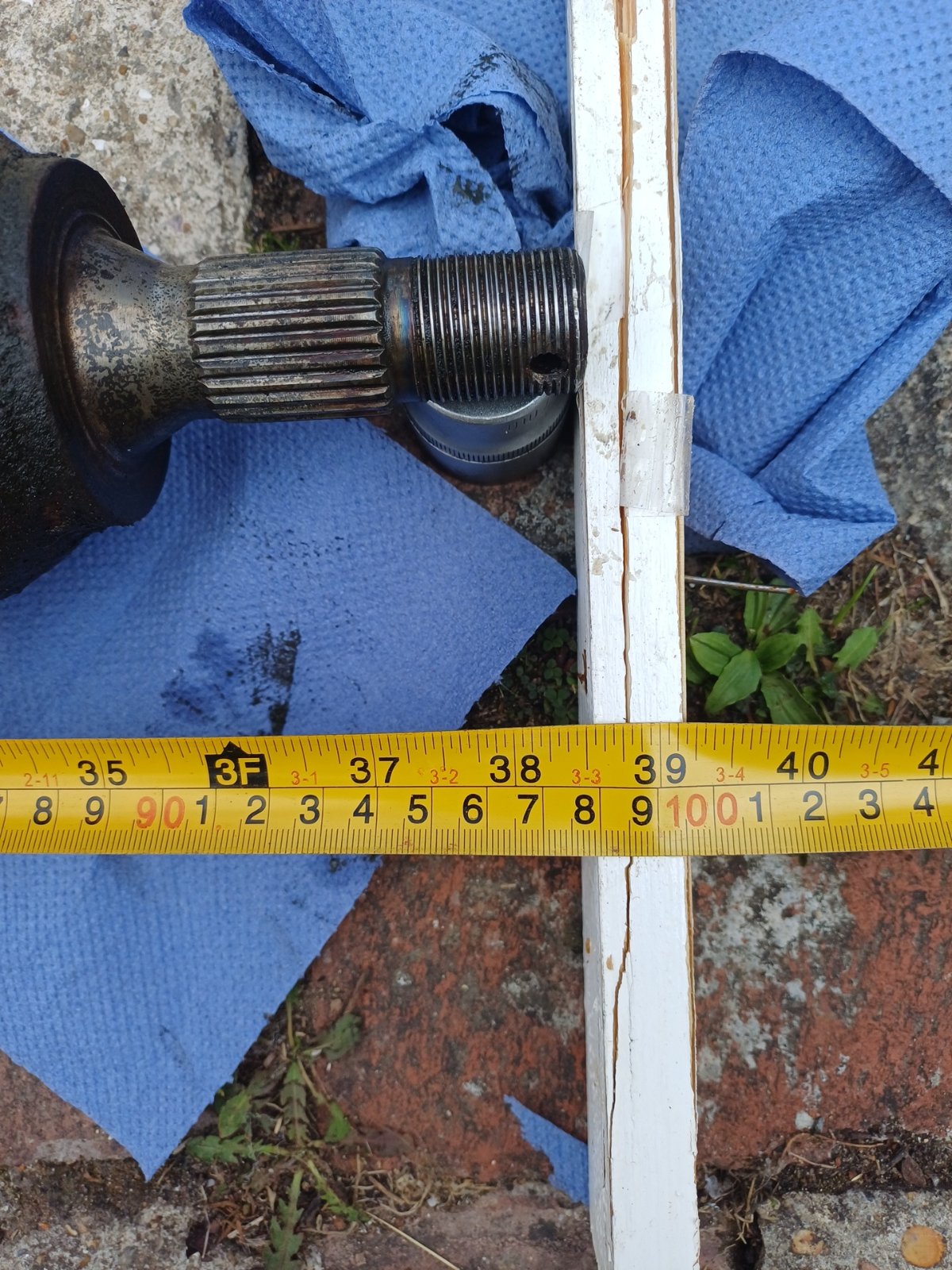

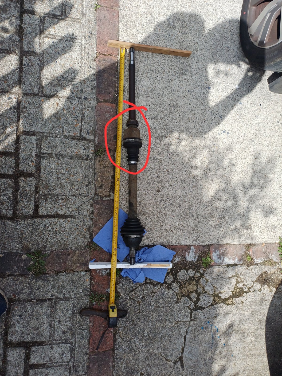

So just thinking about the measurement of the cars drive shaft and the photos I took, the red circle shows this part which looks like it's not sitting innits correct location , its sticking out a bit so this has made my recorded measurement 980 when it could be 945mm ... we're see what the other parts supplies comeback to me with, thanks to all whom have helped .
