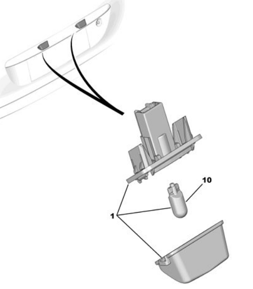

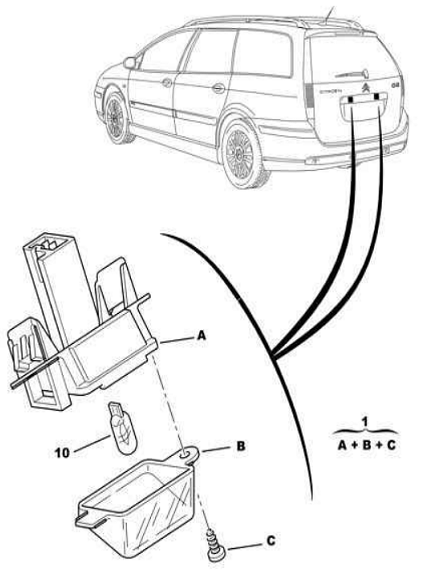

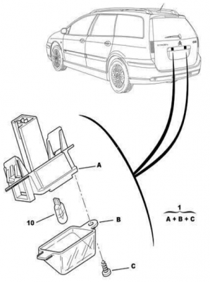

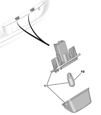

There were 2 types listed, perhaps you have the other one then:Hell Razor5543 wrote: 03 Feb 2021, 13:04 Hi Marc. There are no screws on the lenses on this C5 unfortunately.

Thanks Marc. I have managed to get the bulb swapped. If I had done a search before I asked I would have found this thread;
viewtopic.php?t=45975
But I was being lazy (my apologies for that). I used a plastics tool to pivot the lens down, and it popped off cleanly.
