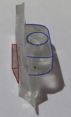

I had capless bulbs as spare parts from my previous car Xantia. Using a very small screwdriver I tried several times and I was successful at the end. The lens popped up in one piece :) Replaced the bulb. Cleaned the lens and pushed the lens in place. Clipping sound from both sides can be heard easily.
I decided to change the other one as well and it cracked almost at the first attempt. I replaced the bulb and it doesn't have a lens yet. I have to buy new ones (one for spare).
I took close-up pics to see how it's clipped.
In this pics below the red marked part is the clipping, thickness is about 1 mm at the end.
Blue part is on the outside of the lens where screwdriver should fit.

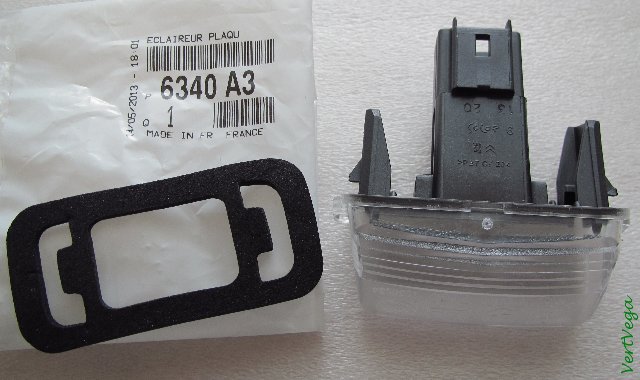

Can't buy the plastic on its own... it comes as a complete unit with the holder for the bulb, the bulb itself and plastic cover, and costs ~£3 from the stealers.
It's a lot easier to pry the whole thing away (on mine there's a bit of felt between it and the car or so to help protect the paint), disconnect the cable, and plug the new one in and reseat it :)

(Edit 16.9.2013) Update: I bought the part and here's a pic where the part number is also seen.
Removed the soft material to get a better pic of the nails. It should be easy to remove the complete set. Not tried yet. I think it is not a good design :roll:
