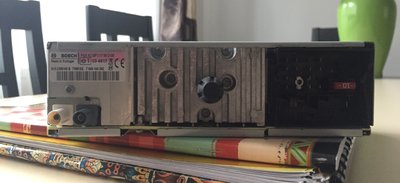

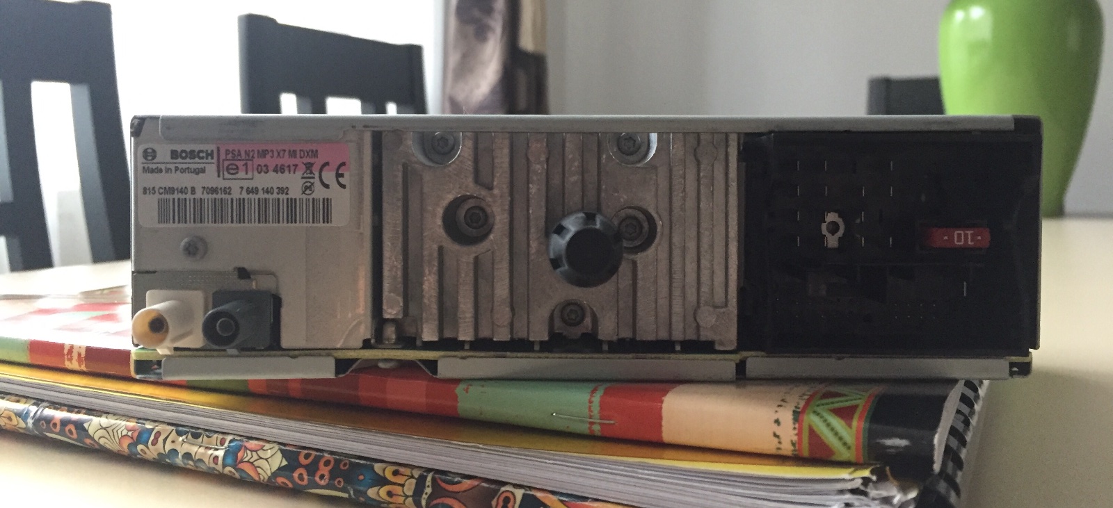

The parking sensors were working from the beginning, but regarding the usb, my unit, which was a RD4 N2 by Bosch, has not that connector. So I don’t know how my USB port from hand rest was linked to the player. In the photo it’s my old player.

- x 6945
Re: C5 X7 2-in-1 navigation tutorial
Ok, can't see the back for connections, but if you say it isn't there it isn't there!
Re the parking sensors - with this system you should get the visual and audio differently - visual on large screen and audio output from the speakers - and possibly, like mine, the speakers output the sound and volume based on the obstacles rear / fron / left/ righ / middle etc. That's what I meant.
- x 6945

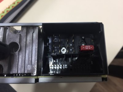

Vlad - just seen you added the picture - any chance you can get a clearer shot of the quad lock pins - the big black section with a bit of light so I can see the connections clearly?
