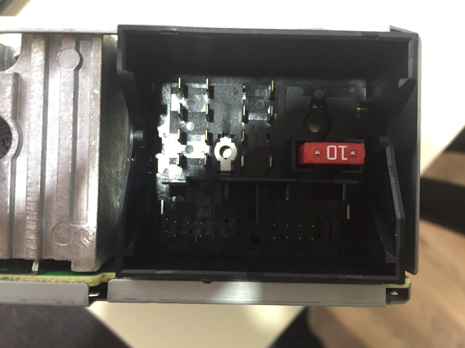

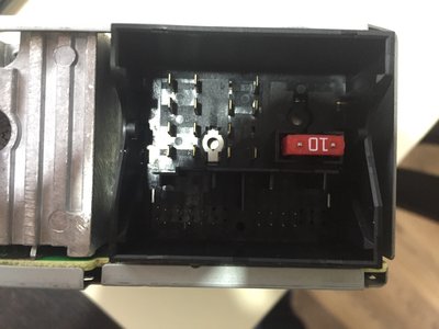

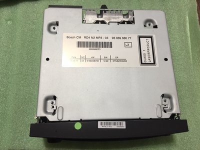

The parking sensors were working from the beginning, but regarding the usb, my unit, which was a RD4 N2 by Bosch, has not that connector. So I don’t know how my USB port from hand rest was linked to the player. In the photo it’s my old player.

Ok, can't see the back for connections, but if you say it isn't there it isn't there!

Vlad - just seen you added the picture - any chance you can get a clearer shot of the quad lock pins - the big black section with a bit of light so I can see the connections clearly?
