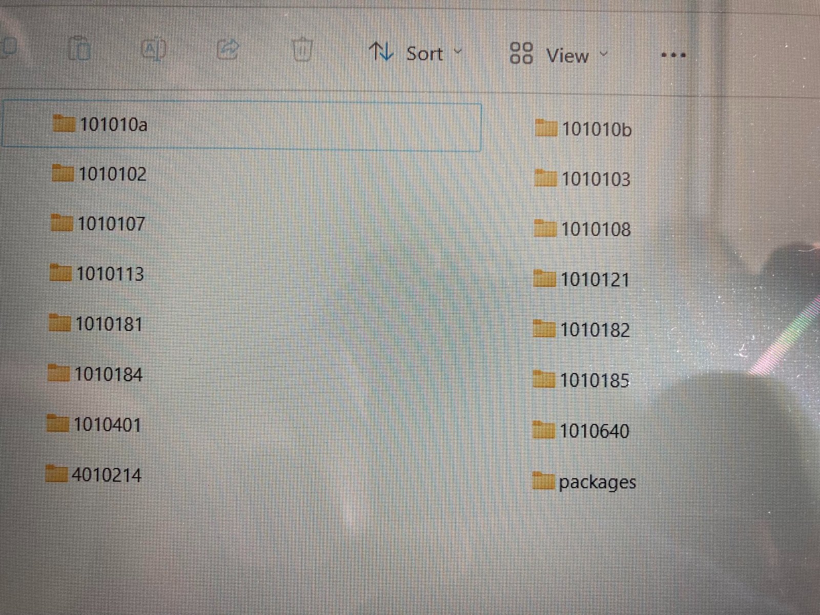

Ok, I downloaded the Firmware and unziped it, then transfered the entire download to a usb stick. there is about 5.5gb. Is this then plugged into my car usb?
A bit confusing as when I followed the app instructions it says to copy map and firmware at same time.
If I had a good dealer nearby I would take to them, I have no confidence in my local dealer and next nearest is 1 1/2 hours drive away.
Steve
Steve
- x 6954
Re: PSA NAC RCC Updates
Just ignore that and update the firmware first.
If you have a screenshot of the USB Route file contents, I can check to make sure it looks ok.
Hi Marc
when I open the usb folder I get
1st File folder SWL
Open that I get: 001315031675246547
Open that I get
Certificates
Firmware
Media header
Hash list
Open firmware and I get the firmware list
Hope this makes sense to you
Steve
1st File folder SWL
Open that I get
Certificates
Firmware
Media header
Hash list
Steve
- x 6954
Yes, that's ok. As long as you have the SWL folder - and there should also be one other file in the route directory of the USB called updateInfo.xml:
