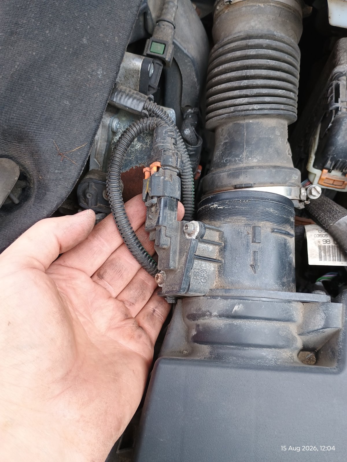

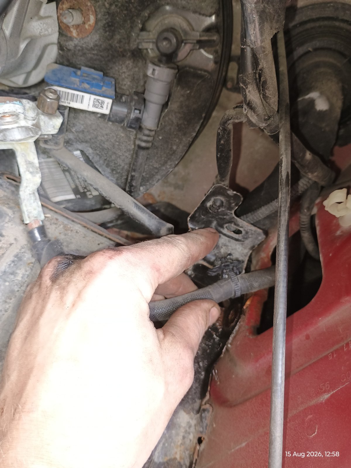

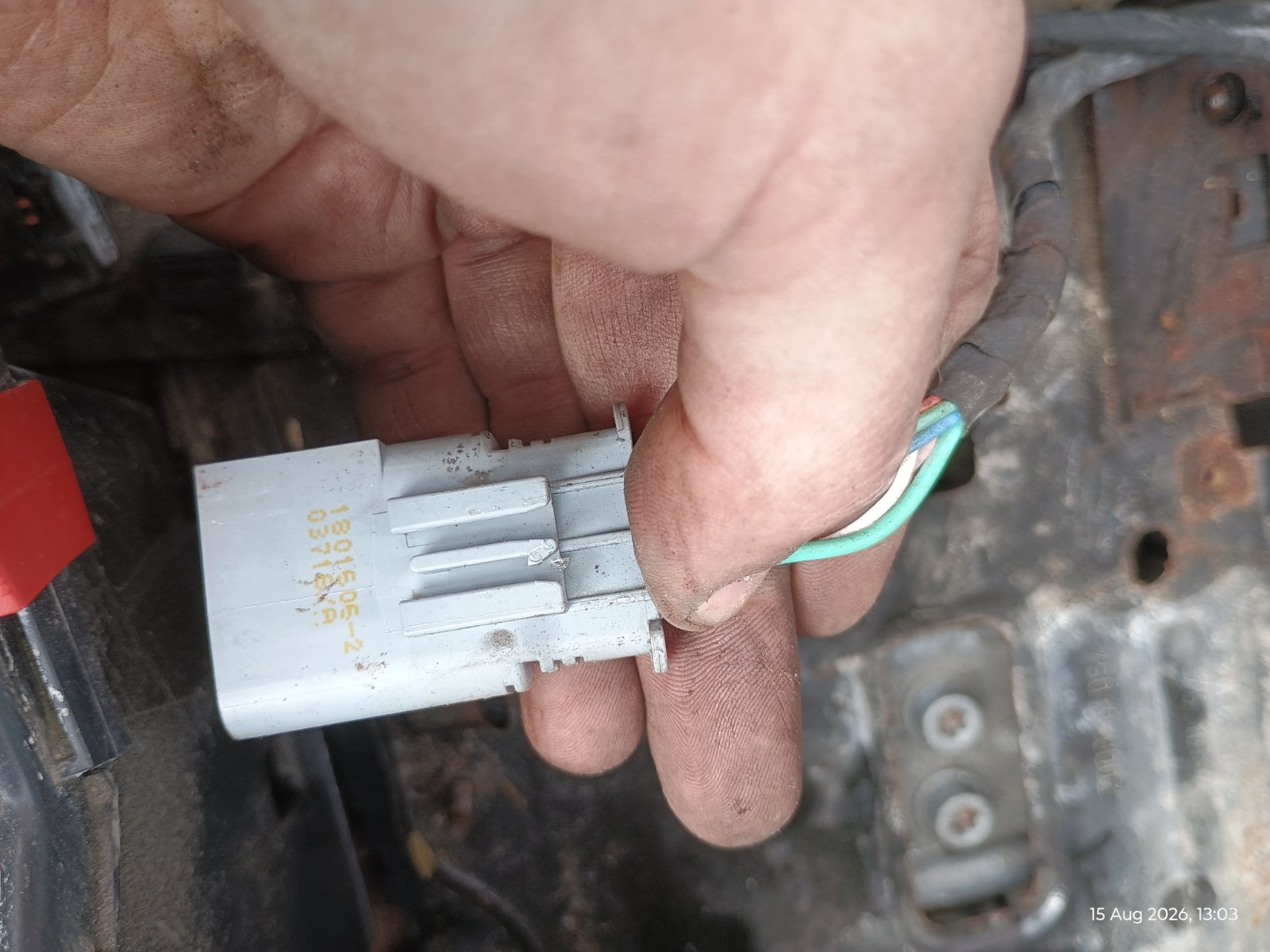

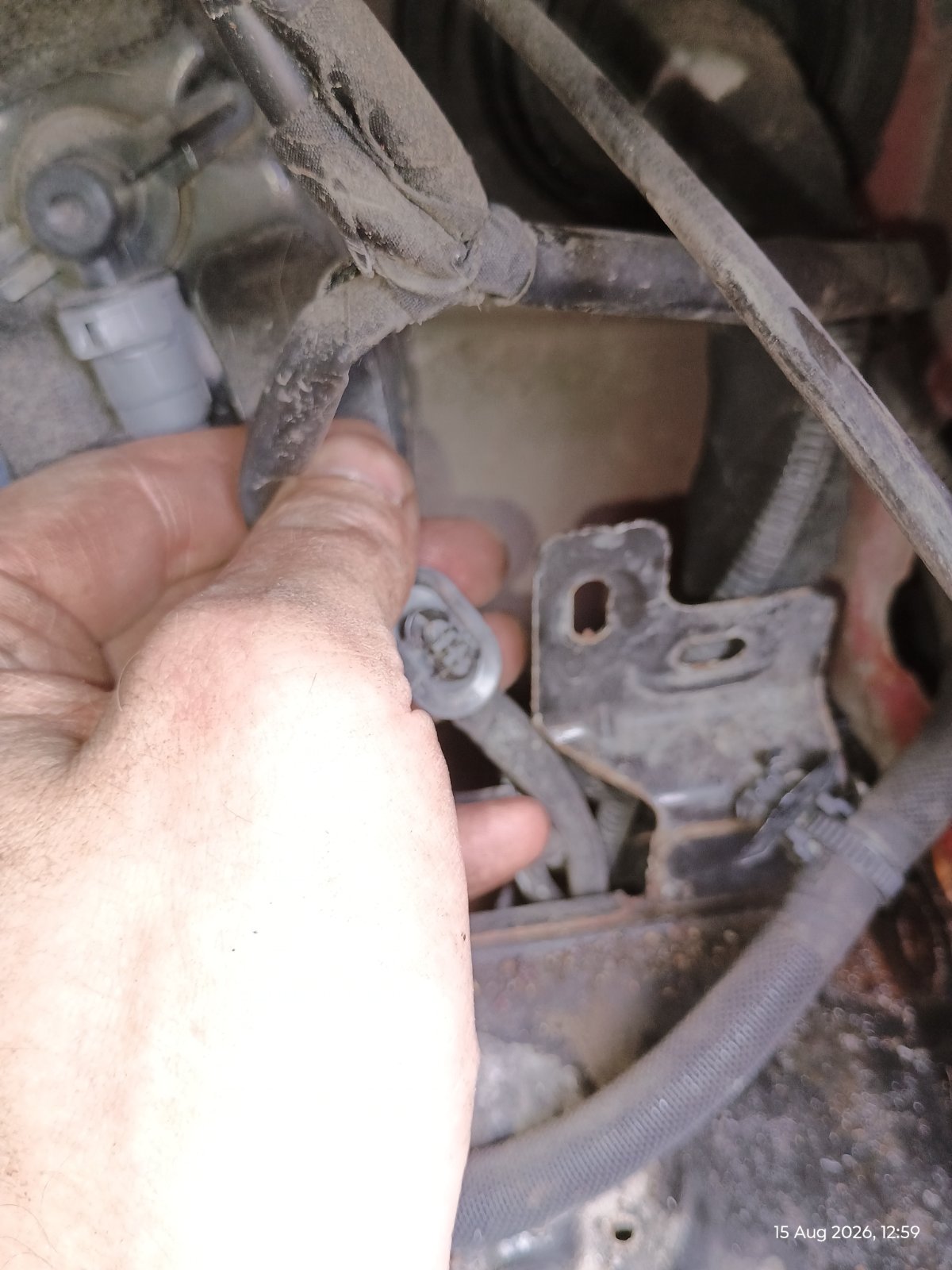

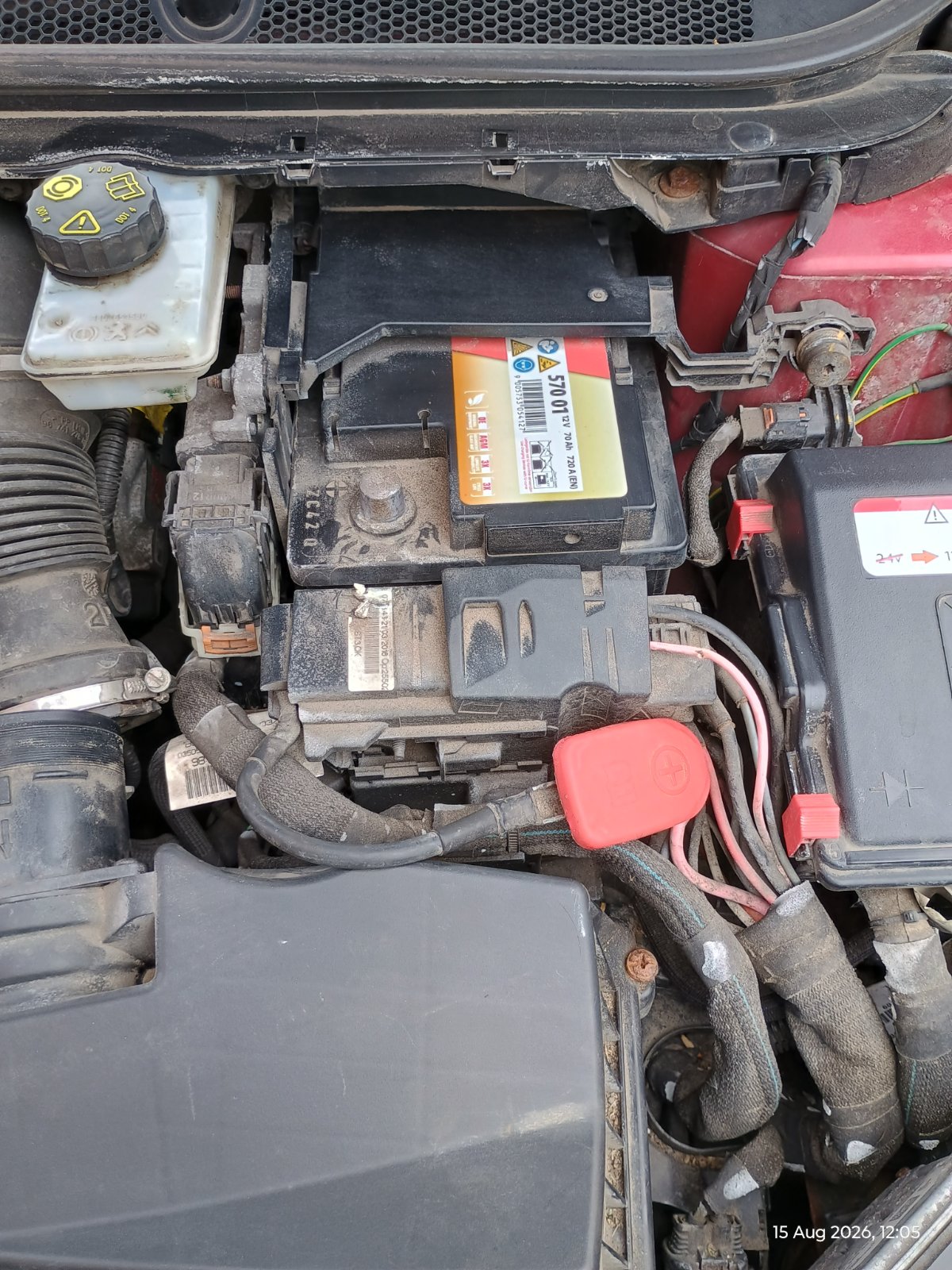

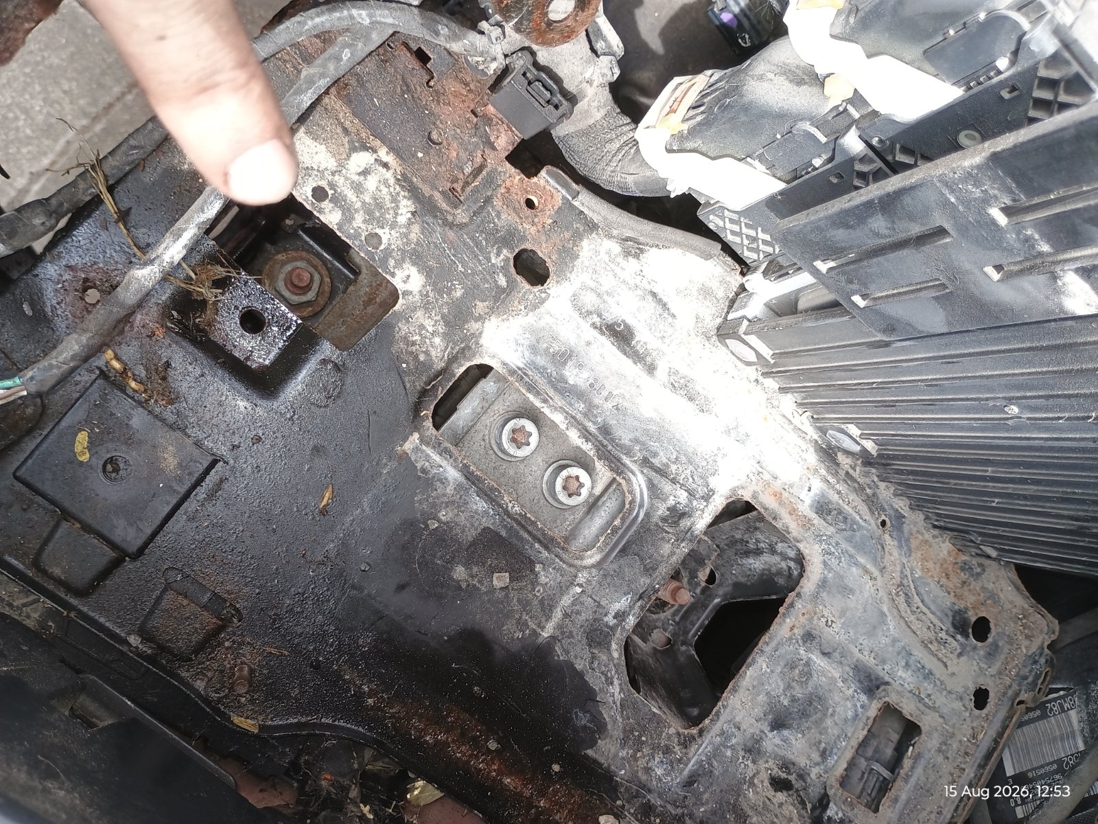

Job one, done:
Reason: Image rotation corrected

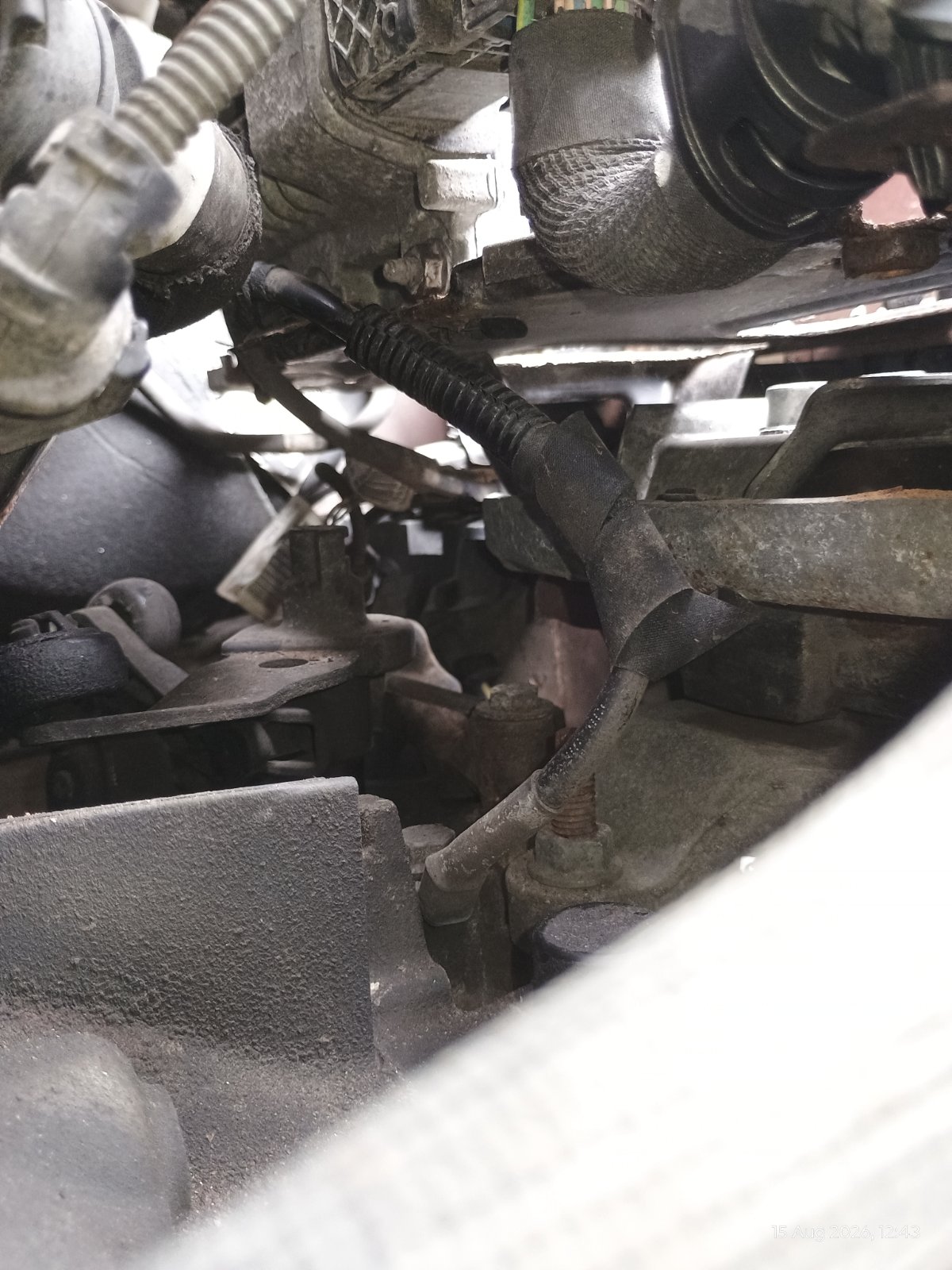

Posts: 5308
Joined: 25 Apr 2022, 09:03
x 2341
Unread post by MattBLancs »

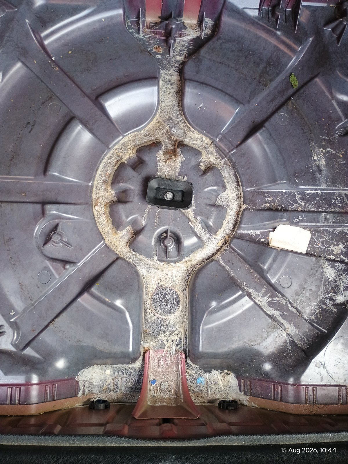

Pumped a tiny a little bit more red stuff off the top, minimal.
Underneath the spare wheel Adblue crystal central!

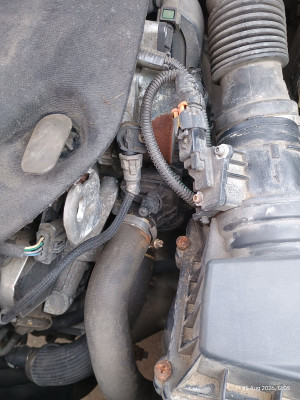

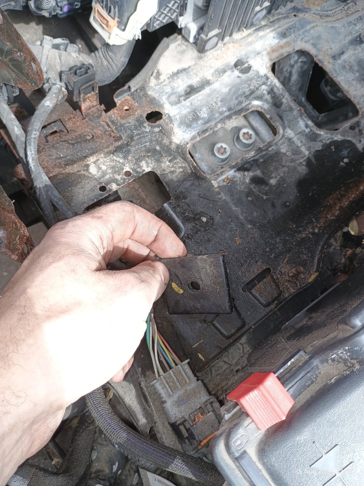

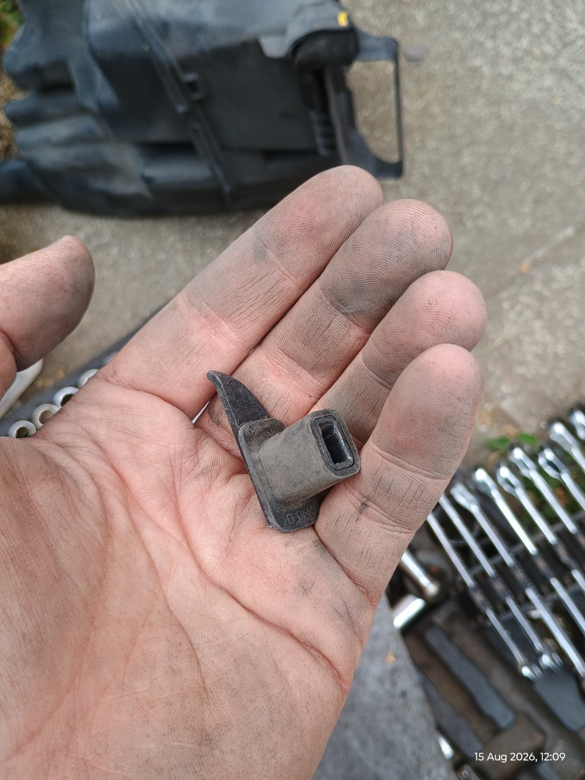

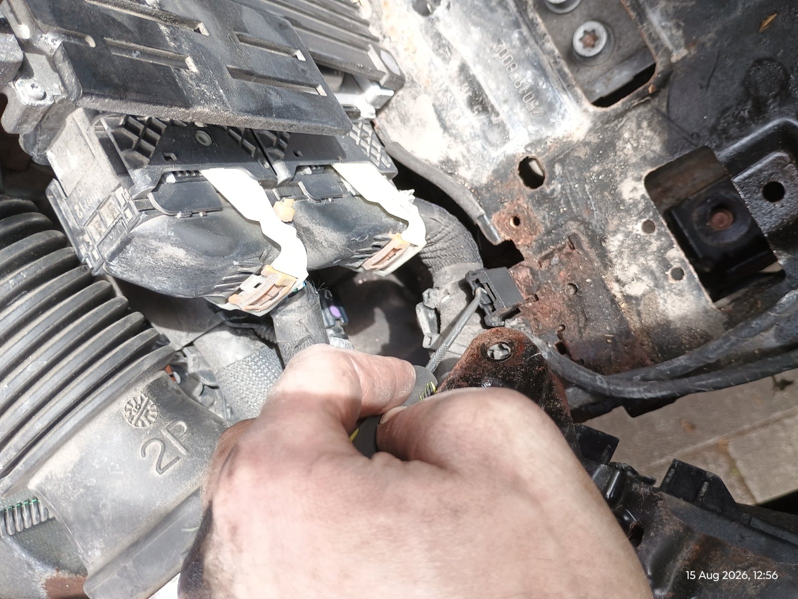

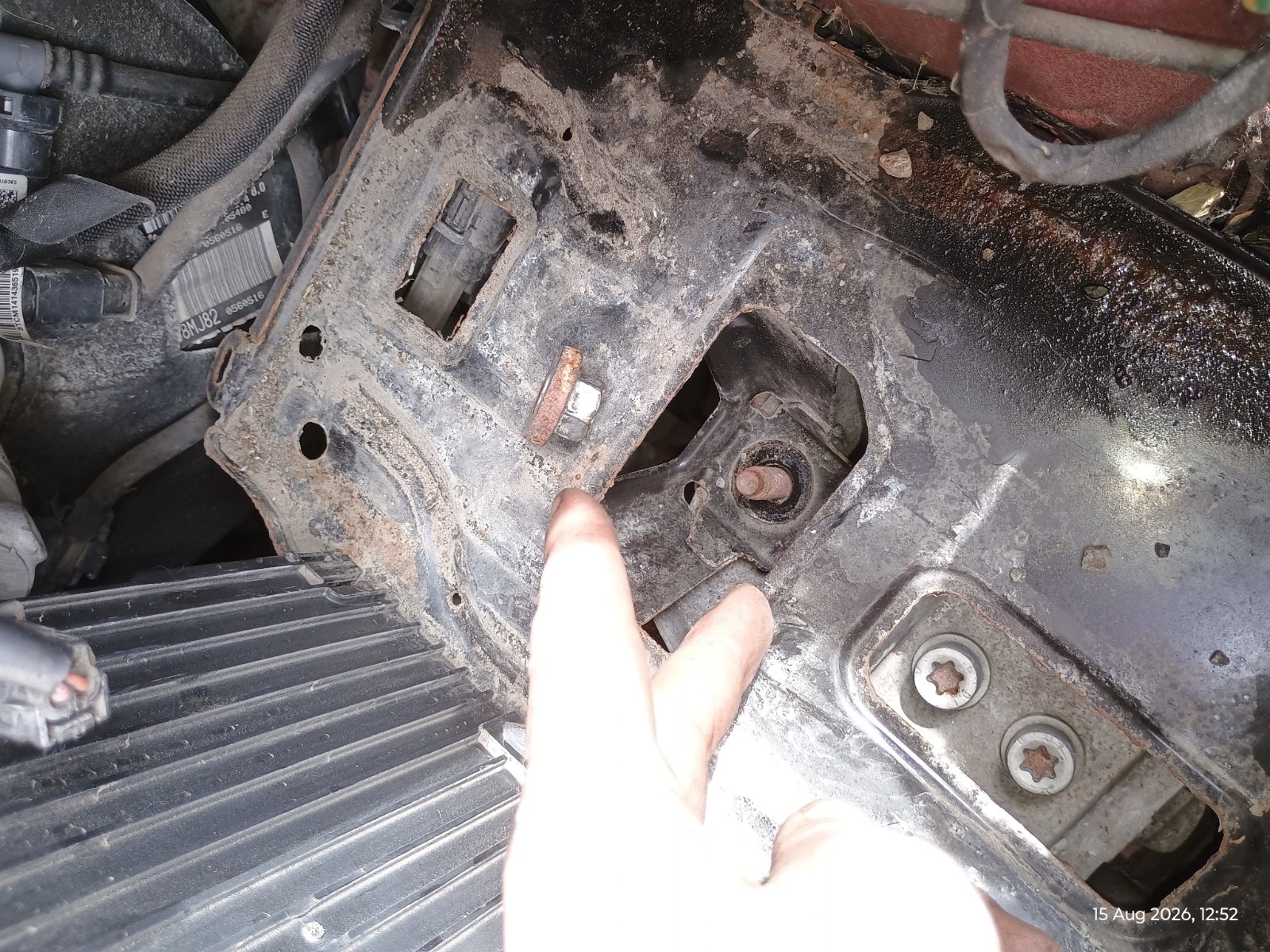

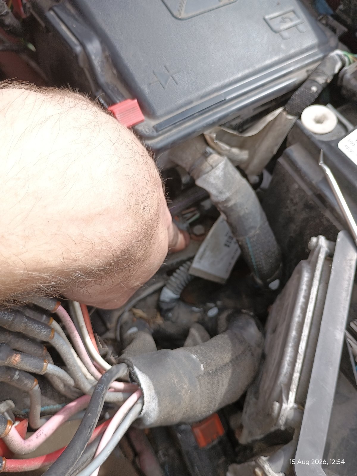

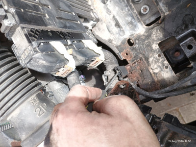

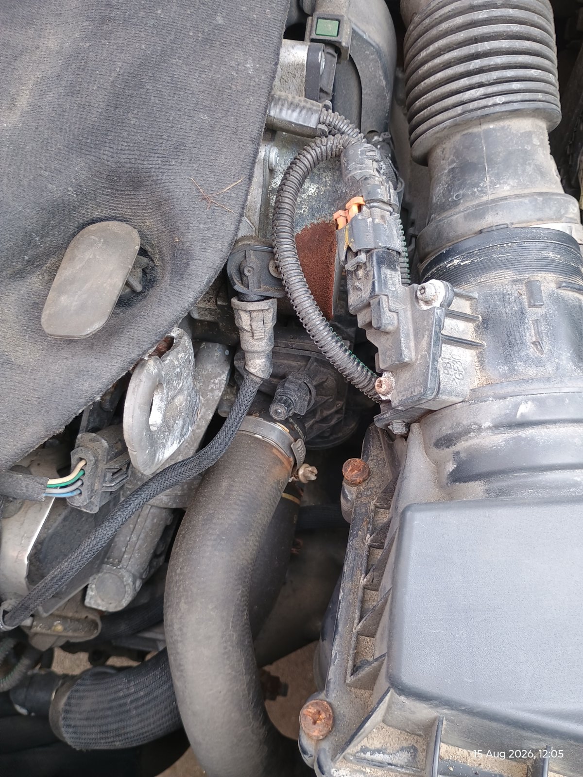

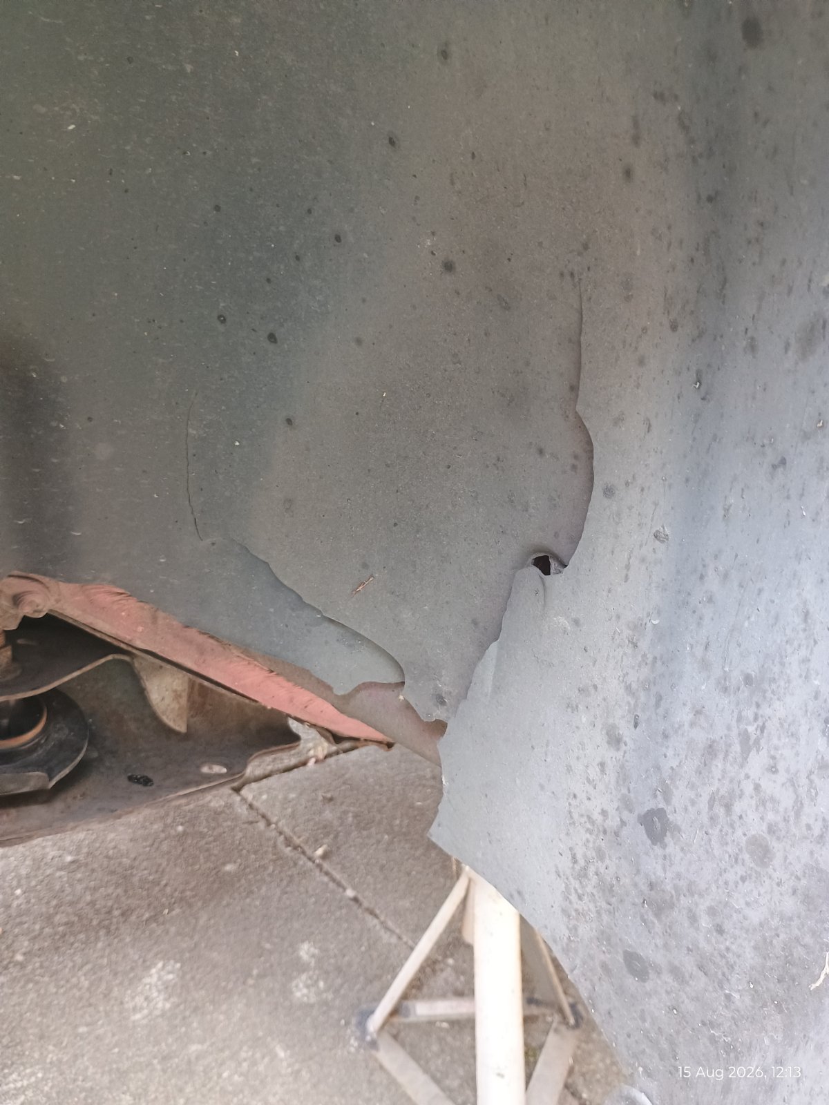

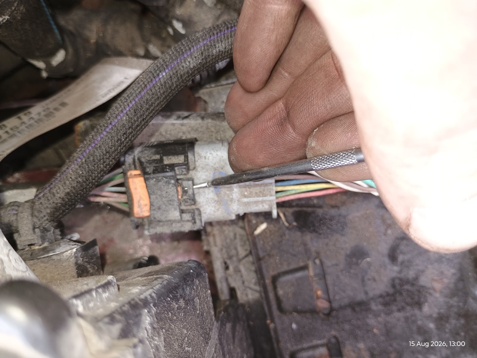

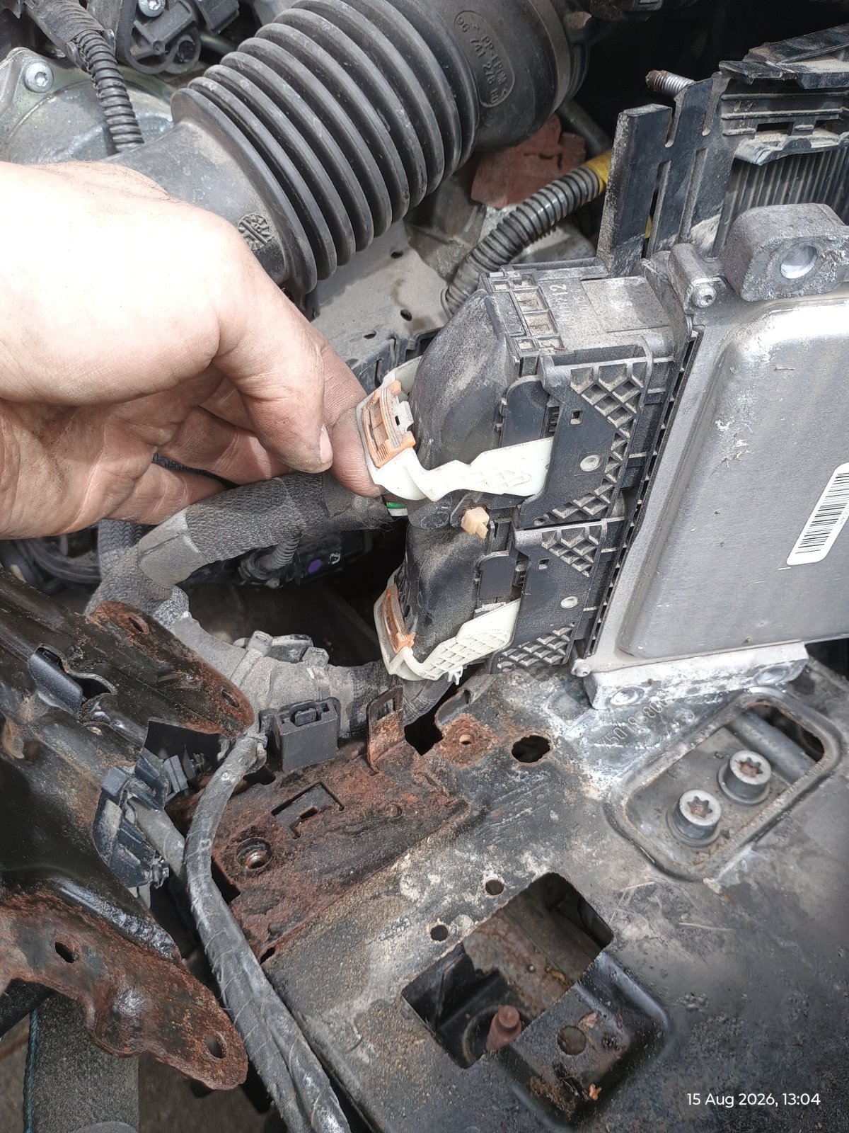

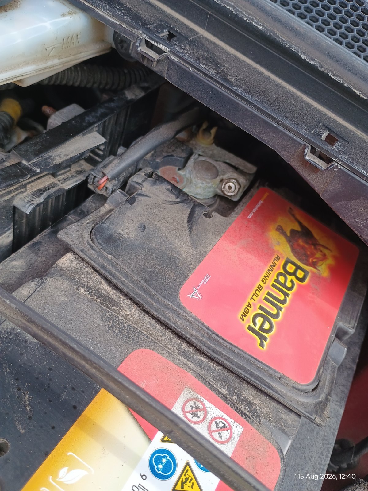

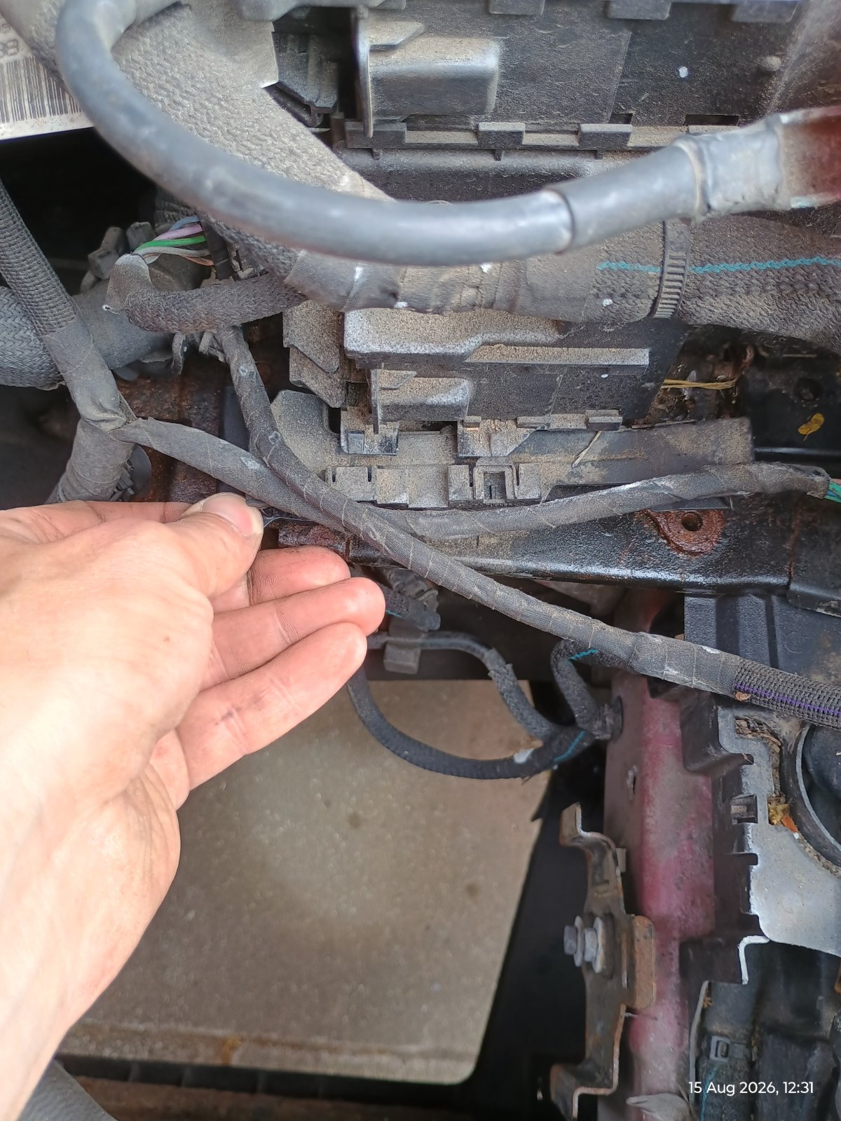

Quick dump of photos text to follow. Quick summary:
quite a lot of surface rust underneath (surprisingly worse than the also 2016 and more mileage blue 308 SW was!) so a clean up, rust treatment and repaint on the cards.
Both front arch liners have had it.
Every fixing bone dry, not a hint of copper grease on the whole car!
Hub nuts did not argue with the meter long 3/4" breaker bar. 32mm socket.
Bolts and bracketry under bonnet fairly rusty heads but have come out, so far. Arch liners looking like it'll be a different story.
All that Adblue crystal mess removed from the boot well.
CV boots (MOT advisory back in May) look less awful than I'd have guessed (one new one on order, a stretch boot to try (new done it that way before!) but likely look out for some of the harder plastic type as longer lasting.

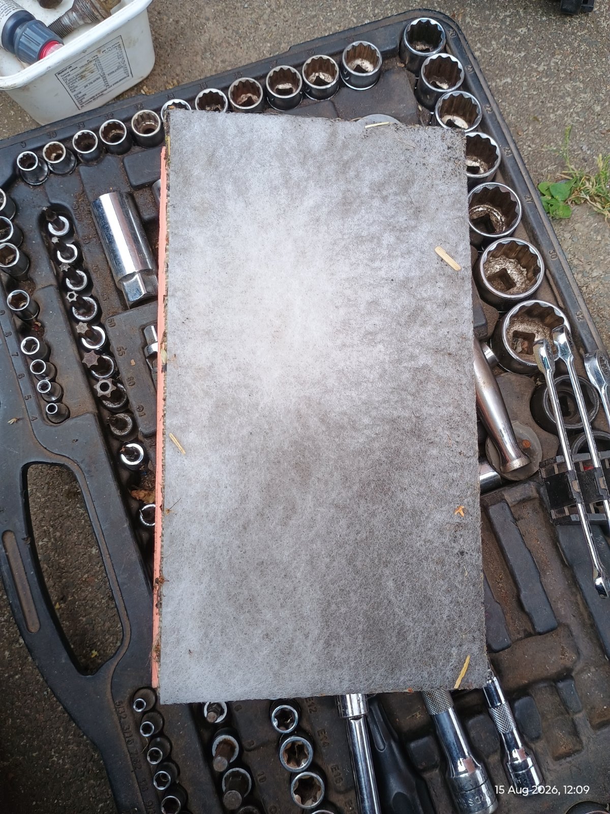

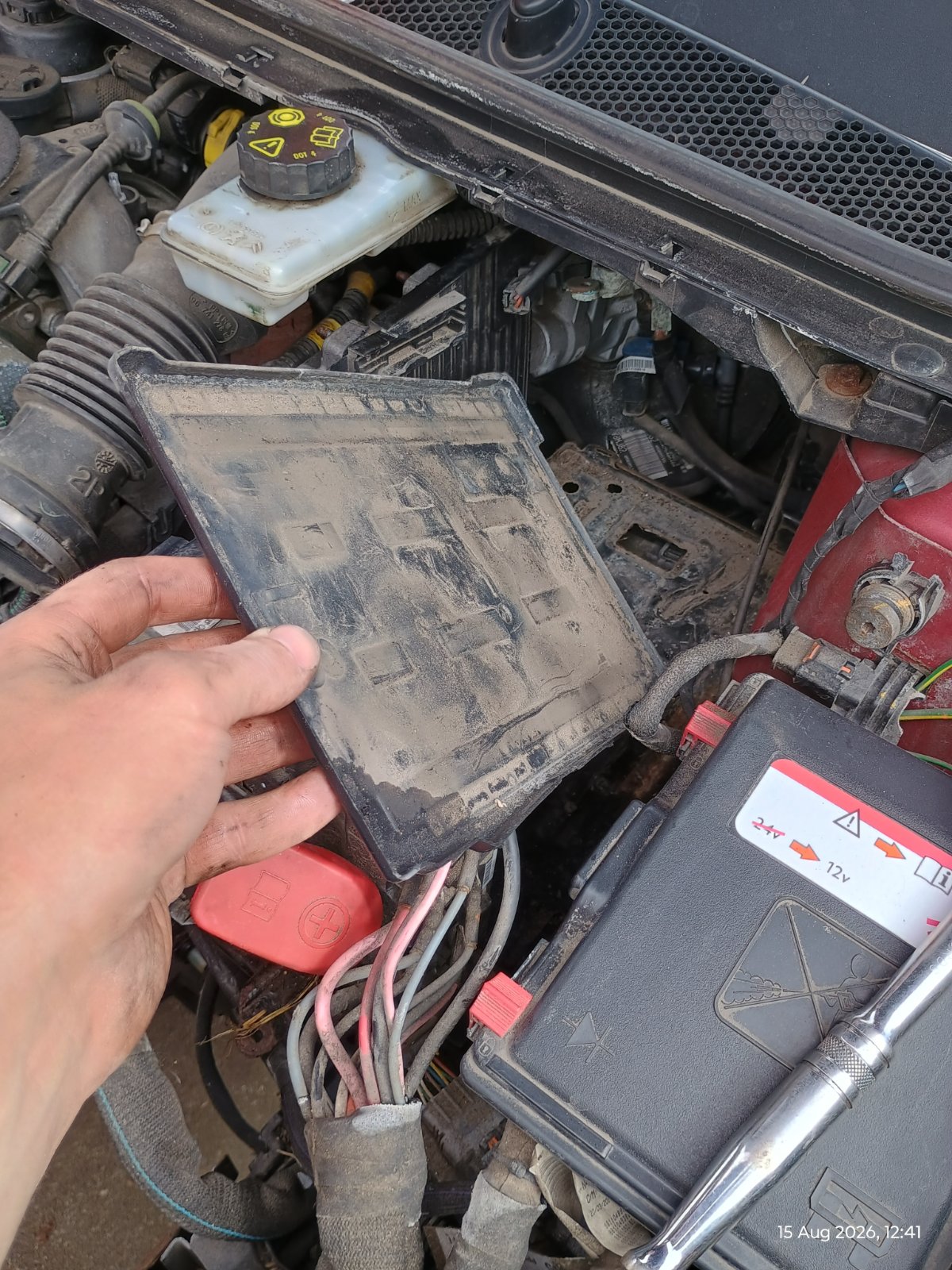

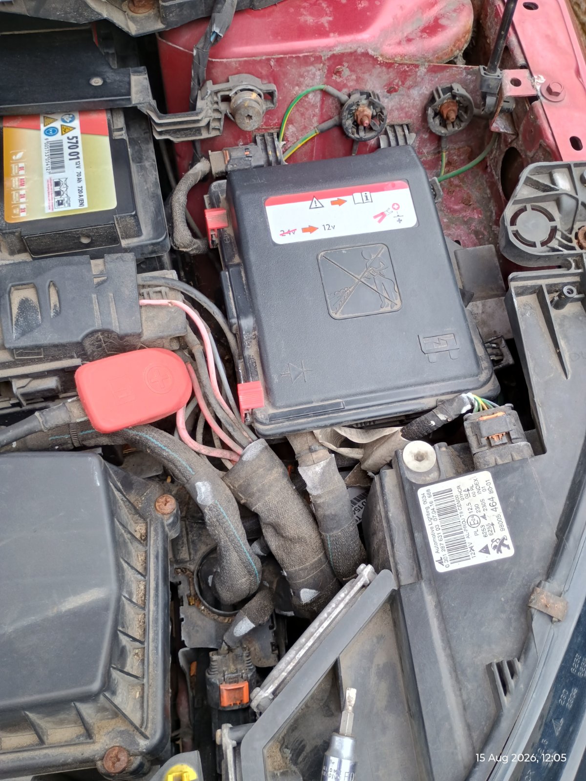

Air filter looking decidedly old, that'll get changed.
