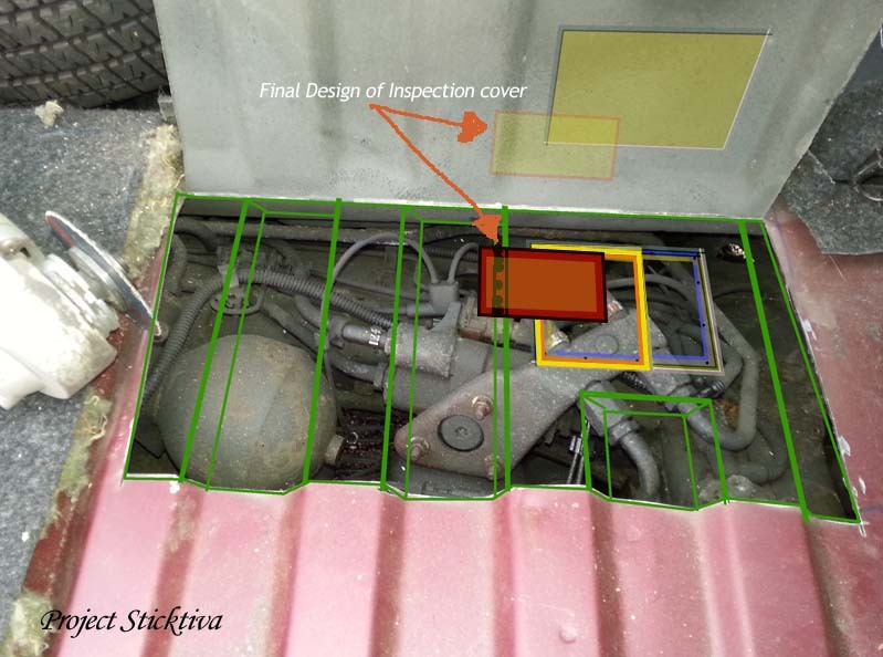

As per ?....I would round off the corners however to prevent any stress fractures forming and the loads to flow
Looking at it I would also like to keep inside the flat area and not extend into the pressed edges.....is that correct for max strength ?

A or B for me ....but made out of perspex so we can see the flux-capacitor working 8-)

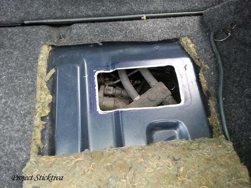

Final shape
one way of stopping LHM on next doors gravel :)

I actually quite like the entire thing cut out! Easy access to all the suspension bits. Make a nice access panel to go over that, plenty of bolts and I bet it wouldn't affect stiffness that much. The Xantia isn't the stiffest car in the world anyway so I doubt it'd be even noticed.

Stickyfinger wrote: one way of stopping LHM on next doors gravel :)
I like... A lot! :-D

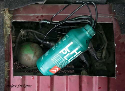

That might do Sticky but do check LHM resistance first.
Get hold of one, drop it into a jar full of LHM and leave it for at least a week to see if anything happens to it such as hardening or softening.

:roll: the plumbing is even worse back there than I had thought. Definitely engineered by someone that had the sub frame in front of them, but not the shell :lol: (or just didn't give a flying ...)

You can get to a fair bit from under if you take off the spheres, this will allow you to avoid stripping down and dropping the frame to get to the ram hoses and the leak off connector mainly....so to me well worth doing

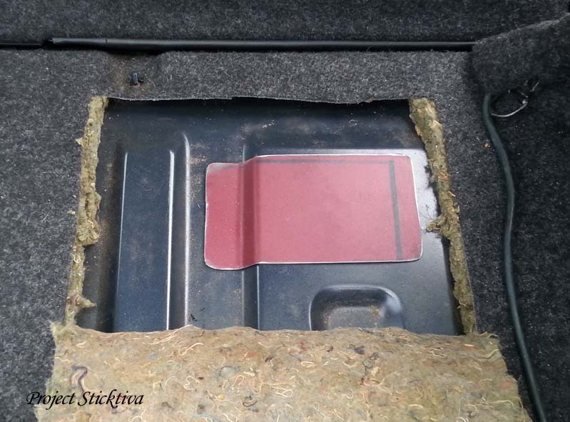

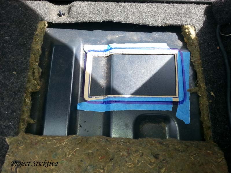

Max area
Template
Cut Out

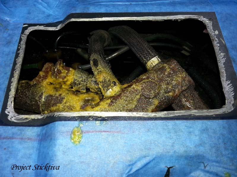

FINISHED, Fixed and NOT leaking............FFS Citroen !
Anti corrosion wax applied....good protection for Aluminum as well apparently but designed for truck electrical connectors.
