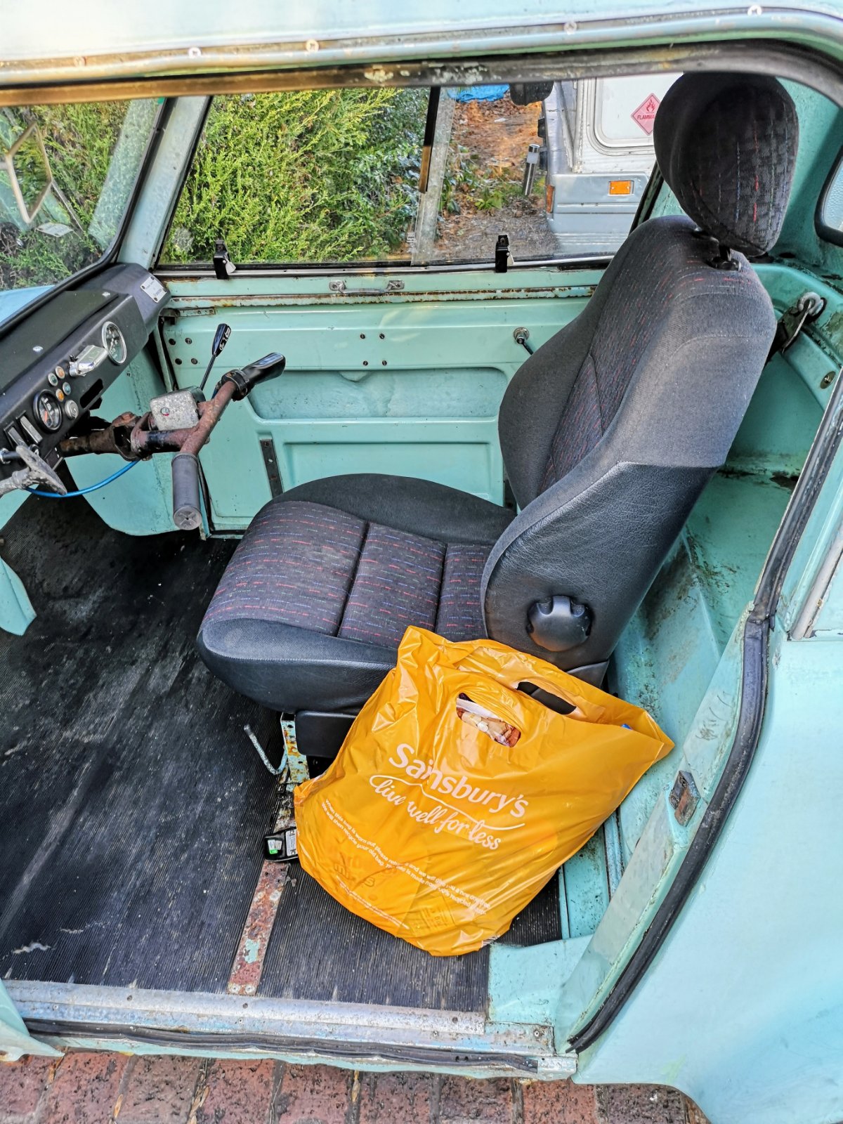

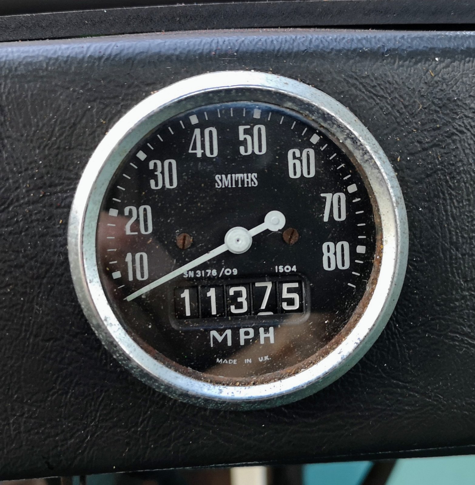

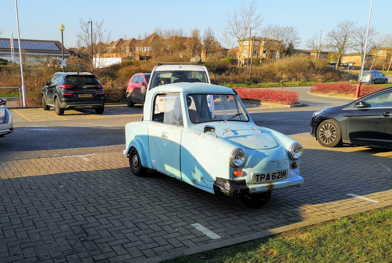

So in addition to the photo taken out and about in the Sainsbury's car park (a whole 0.8 miles from home!) earlier, here's the rest of the update from today.

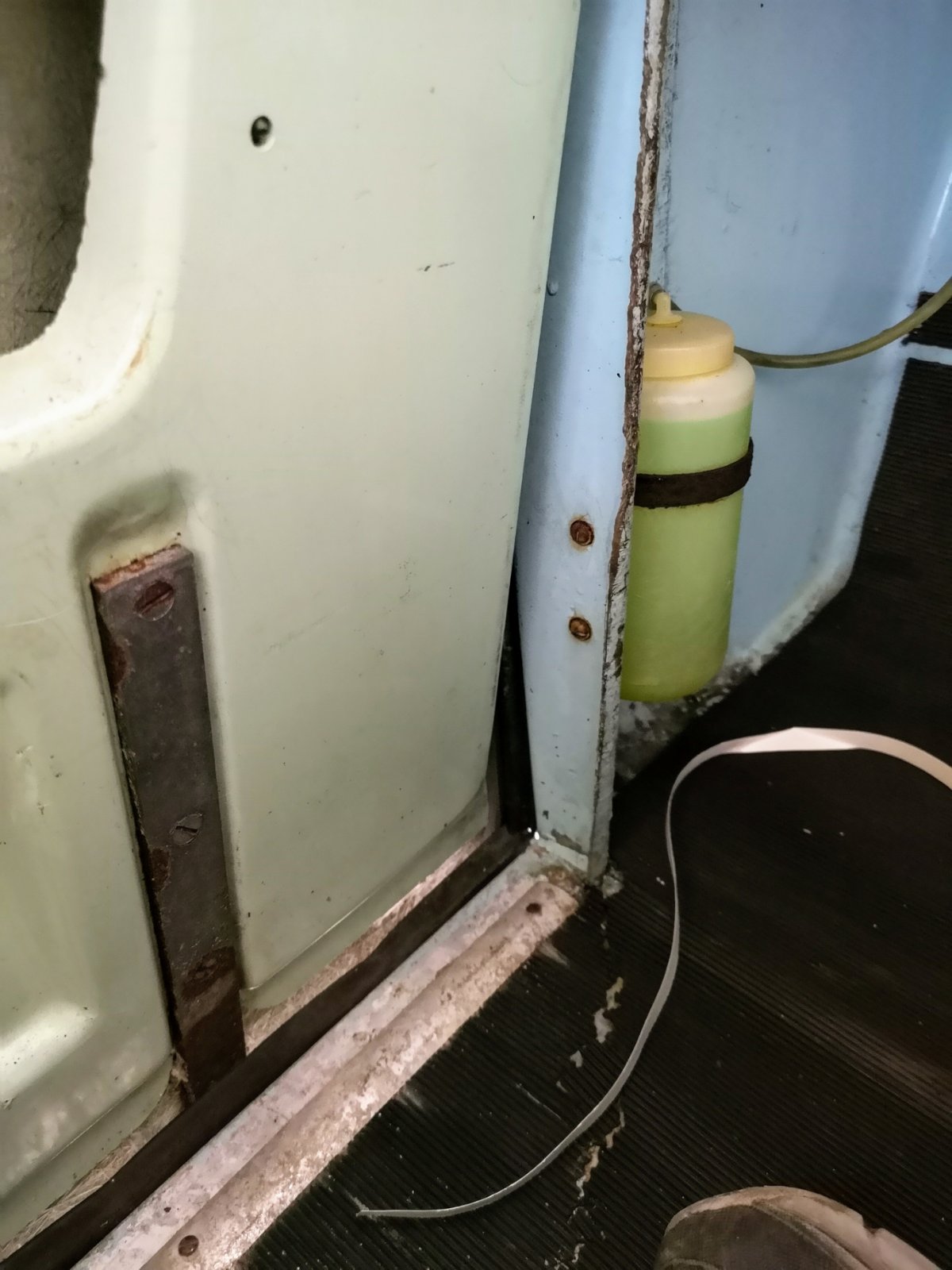

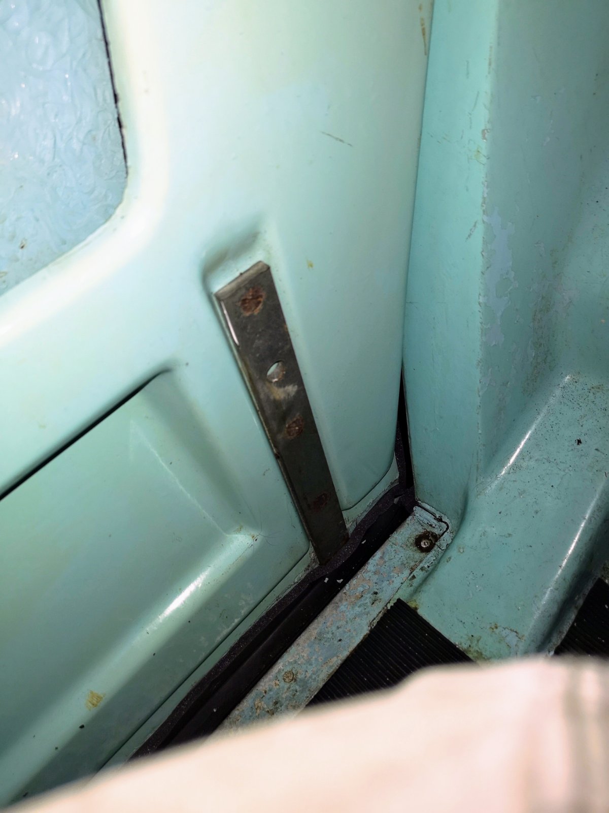

Continuing with the general theme of ticking one little task at a time off, I attacked the door runners and latches with grease.
Main hope there had been that it might help the offside door slide properly as it has a tendency to stick on the runners. Sadly it still does, though not quite as badly.
While I was there I securely reattached the door seals at the bottom of that door.
Though I always feel that I should use quotation marks around "seal" when referring to those around the doors of an Invacar given the degree of daylight that you can see around them. Reminds me of a Series Land Rover...
I reckon that if I find myself using the car I may well look to install a slightly wider seal as these are pretty useless.
The heater during the first couple of runs out (despite my efforts to clean it out) had thrown finely atomised rust all over the cabin, so it was time to hit it with the vacuum cleaner again.
Much better. I suspect this will be a regular task for a while.

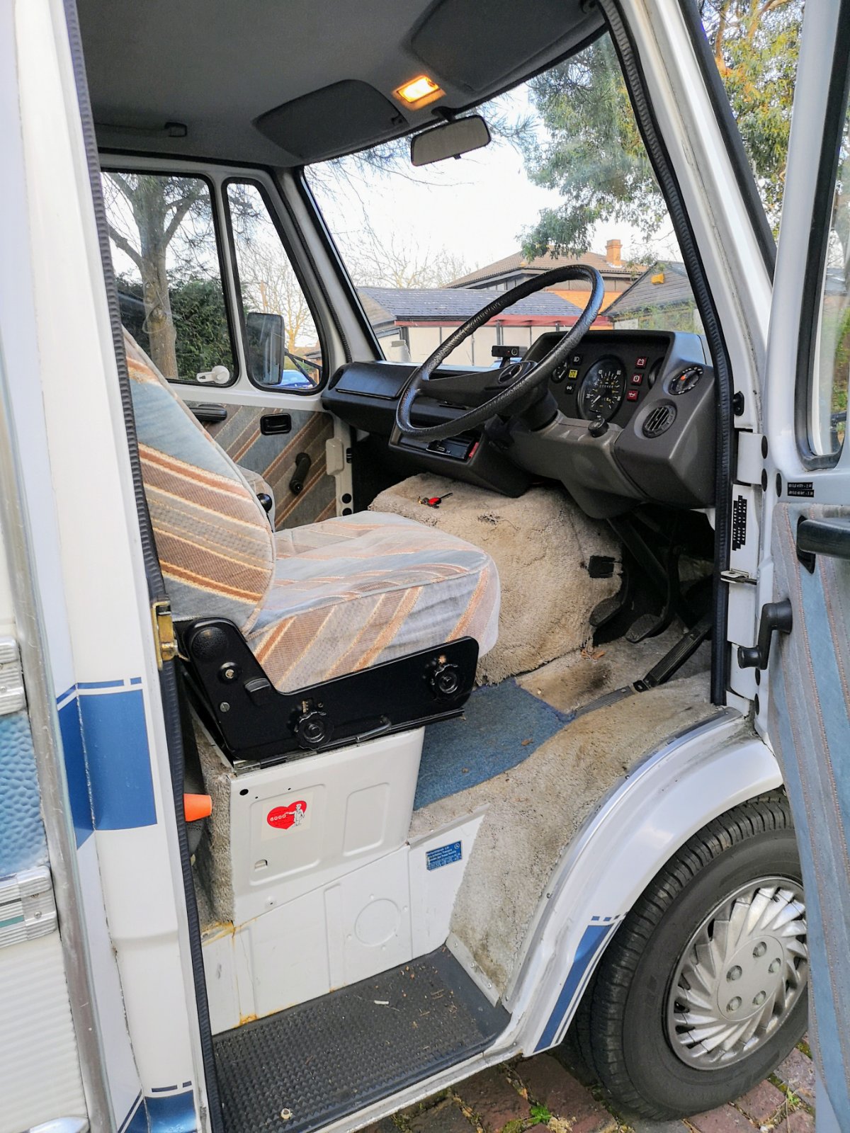

Enough of this faffing around though...a car is meant to be driven, and I'd been trying to kick myself into taking a brave pill and actually taking TP out of our neighborhood and going somewhere...
On the way home from Sainsbury's I stopped by my GP surgery to pick up a prescription - I have to wonder if an Invacar has been parked up here before?
Back home, another five miles covered.
Oh, and some groceries retrieved...wonder how many years it is since she last actually did useful work...
Glad to report that she didn't miss a beat. Only gripes were the rear service hatch coming loose (again - hence my plans to improve the securing arrangements), and that there really is far too much free travel in the brakes. Think for the sake of £50 odd I'm just going to pick up a new master cylinder. This one came with my original Invacar and was "NOS" - but looked to have spent quite a bit of time stored in poor conditions, and has never felt quite right, and as such I don't think I'm ever going to fully trust it. Not as though I'm driving around with no brakes mind, she's more than capable of locking all three wheels up, and the handbrake is also more than capable of stopping the car quite rapidly. I'm just not keen on the size of the dead zone before braking starts to happen.

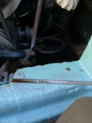

Checking the oil after the trip out today, glad to see that it is still nice and clean.
Hasn't used any either I'm glad to see.

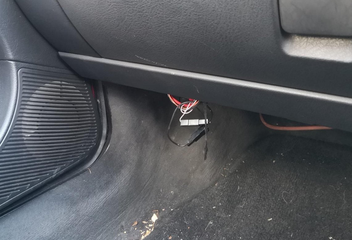

With regards to the rest of the fleet, tidying up the heater wiring in the Activa had been on my to do list ever since the blower motor was changed - about a year ago! This has been poking my OCD ever since.
Much better.
Much better.

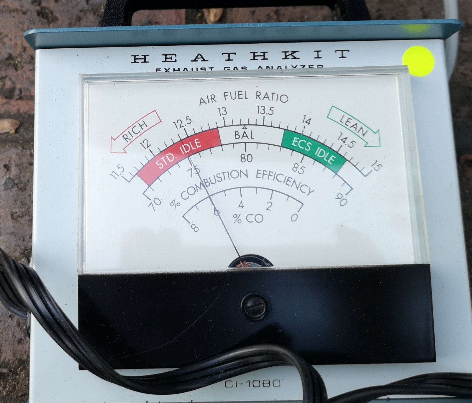

Annoyingly no photos to show for it as I forgot to take my phone with me, but she's been out to the pharmacy again and stopped at Aldi on the way back (to grab a hole saw to allow me to refit the number plate light) without any issues.
When I got back, before putting her back in the garage I hooked TP up to the exhaust gas tester. Before the actual test drives started, she was pegging the thing off scale high at idle for the CO % reading.
Today?
Pretty good indication right there of just how much better an engine can run after doing a bit of actual work.
If all goes to plan tomorrow I will be able to get her out for a bit again, and I think the plan will be for a few high speed runs to confirm that nothing will fall off. If all goes well there, I think I can start considering actually making runs out to a few places around town beyond my local supermarket.

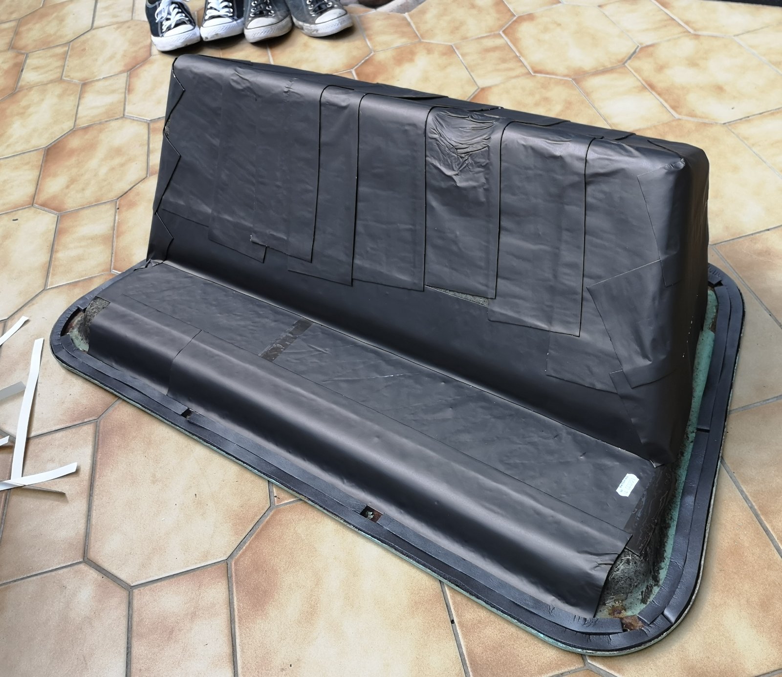

One thing the Invacar is drastically lacking in is sound insulation. As in there isn't any. At all.
I'm not about to plaster the whole car in it, there are a couple of places where it can be pretty easily added which should help a lot. One in particular is the cover for the transmission service hatch. A large portion of the racket in the car comes from the CVT belt (one of the criticisms the system has faced when used in passenger vehicles).
The cover is essentially a giant bass drum as it comes. This is immediately apparent the first time you put it down on a hard surface and it settles with a reverberating boom.
Adding some flash band to the back of it has vastly reduced the tendency for the panel to behave like a drum, and a fresh seal round the edge should help it seal.
With it back in place it's definitely done something... haven't had the car out since this was fitted yet, but there's a definite drop in noise level when you close the door with it idling now. Before this work was done there really wasn't any difference.
Not going for Rolls-Royce refinement levels, but if we can shave a couple of decibels off driving noise levels that can't be a bad thing and surely will make the car less tiring to drive.

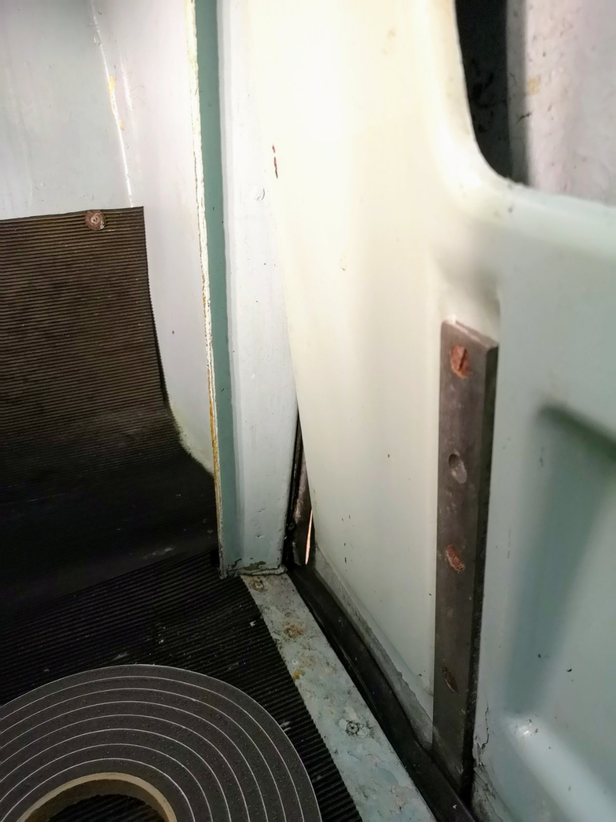

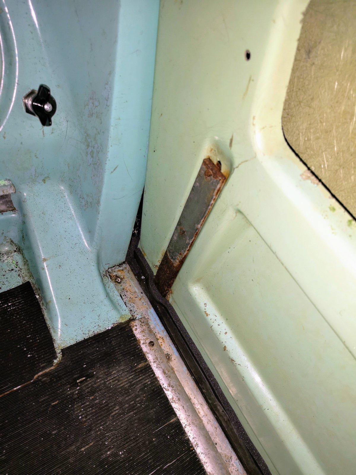

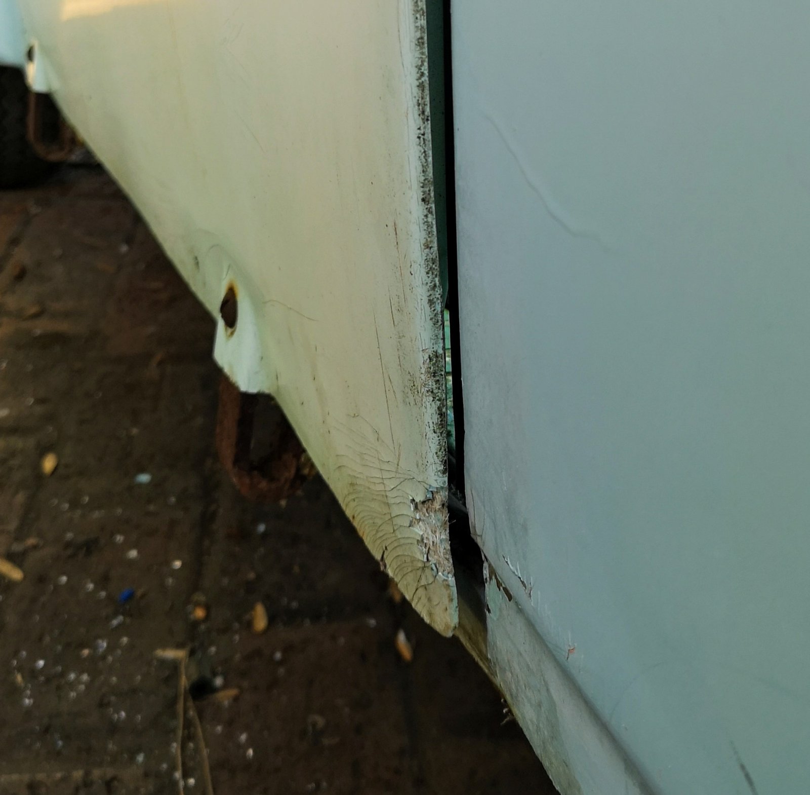

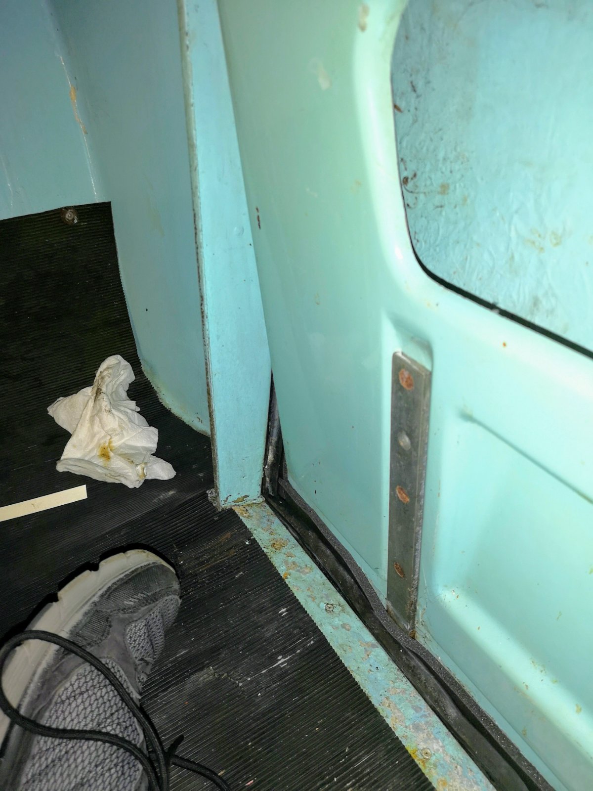

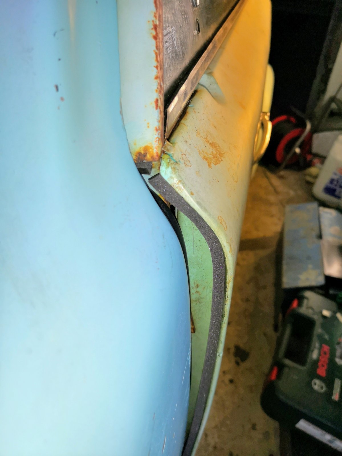

Encouraged by the difference that my sound damping has made to the noise levels I figured I would add to it a bit but not by actually adding more sound insulation as such - but just improving on the frankly laughable sealing arrangements around the doors.
It was really obvious that a significant chunk of the ambient background noise from outside was coming in through the gaps around the doors - especially at the base. The amount of daylight visible makes it obvious - and results in draughts blowing up your trouser legs above 30mph or so.
Nearside Front: Offiside Front: I do have some new seals, but the ones on here while looking somewhat dog eared in a few places are actually in decent condition and replacing them wouldn't really achieve much I reckon. What would would be getting the base of the door to sit closer to the body - but I dontd really see any way to do that which wouldn't make the door foul on the body when opening. The top bit just seems to be an afterthought - relying on the gutters to keep rain out for the most part.

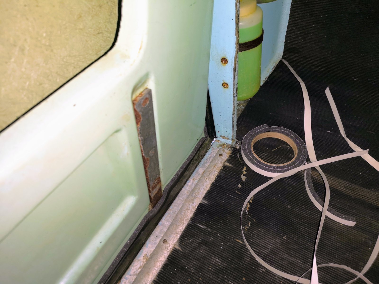

What I did think might help though would be the nice thick weatherstripping I had on hand, which while quite thick when in open air squashes down to pretty thin, and is sort of like memory foam so good at dealing with irregular gaps.
My plan was basically to go over the edges of the doors where it contacts the main door seal, helping to make a better contact with it.
Like so. The results tell the story I think...
Nearside front: (I need to fasten the main seal to the door rail cover at the front properly, hence the bit of daylight still visible there)
Offside Front: Nearside Rear: Offside Rear: Offside upper rear - used to be about a 1/4" gap here. It is really noticeable now that closing the doors results in a very noticeable drop in the ambient noise level from outside now, so it must have improved things to some extent. The other thing it's helped with a lot is reducing the amount to which the doors wobble and rattle.
While I had the weatherstripping out I also put a couple of bits under the front service hatch to stop it rattling, likewise the engine cover. The car is always going to rattle like a cement mixer full of ball bearings, but I may as well do what I can to help.

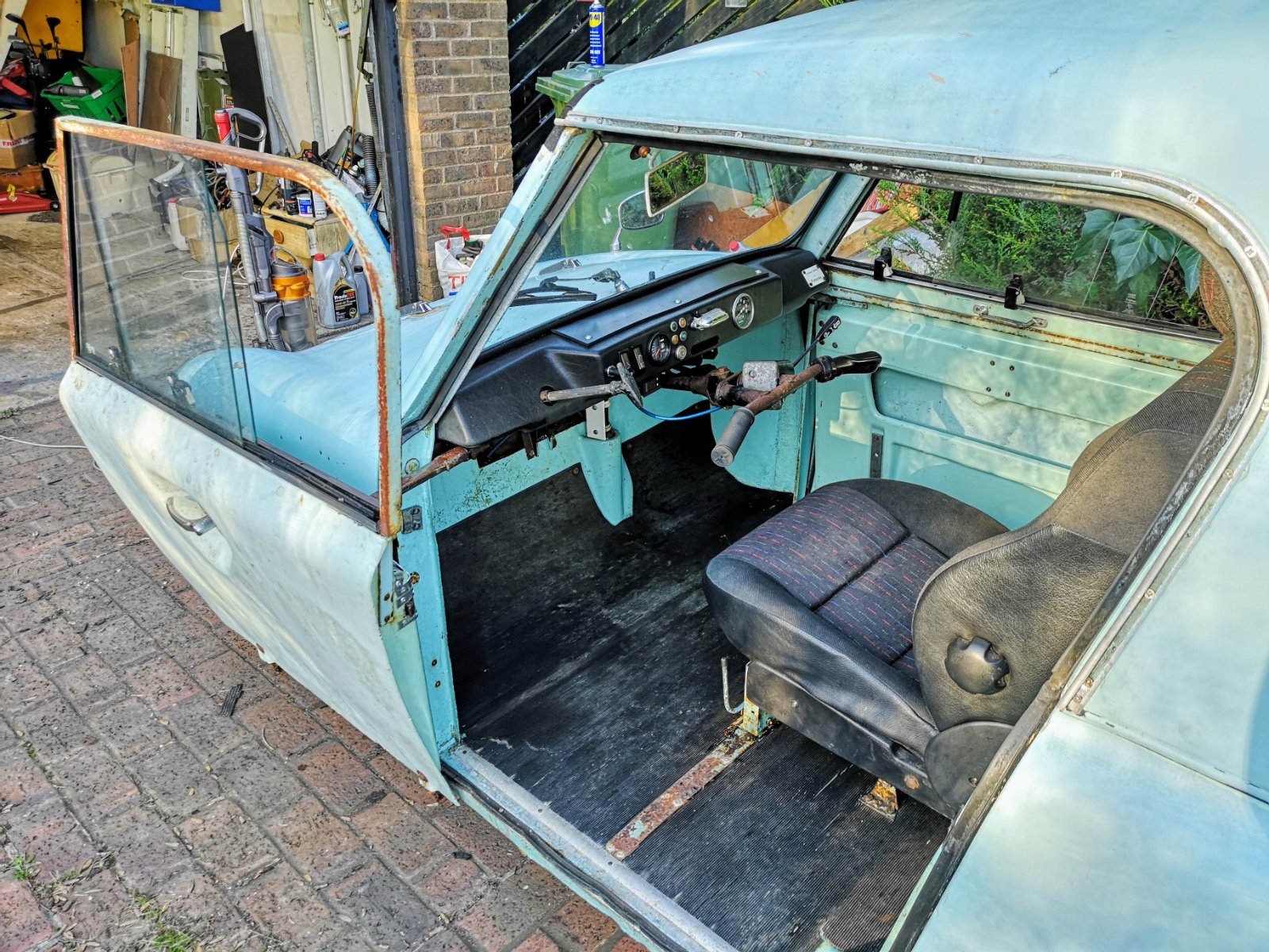

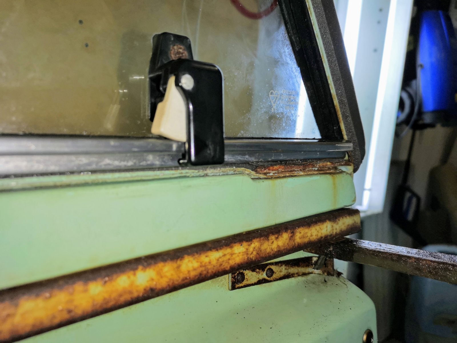

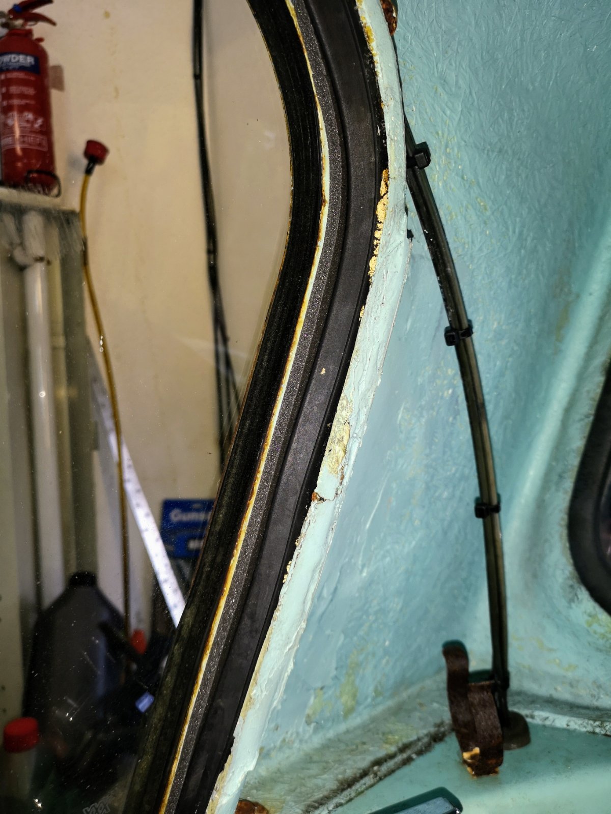

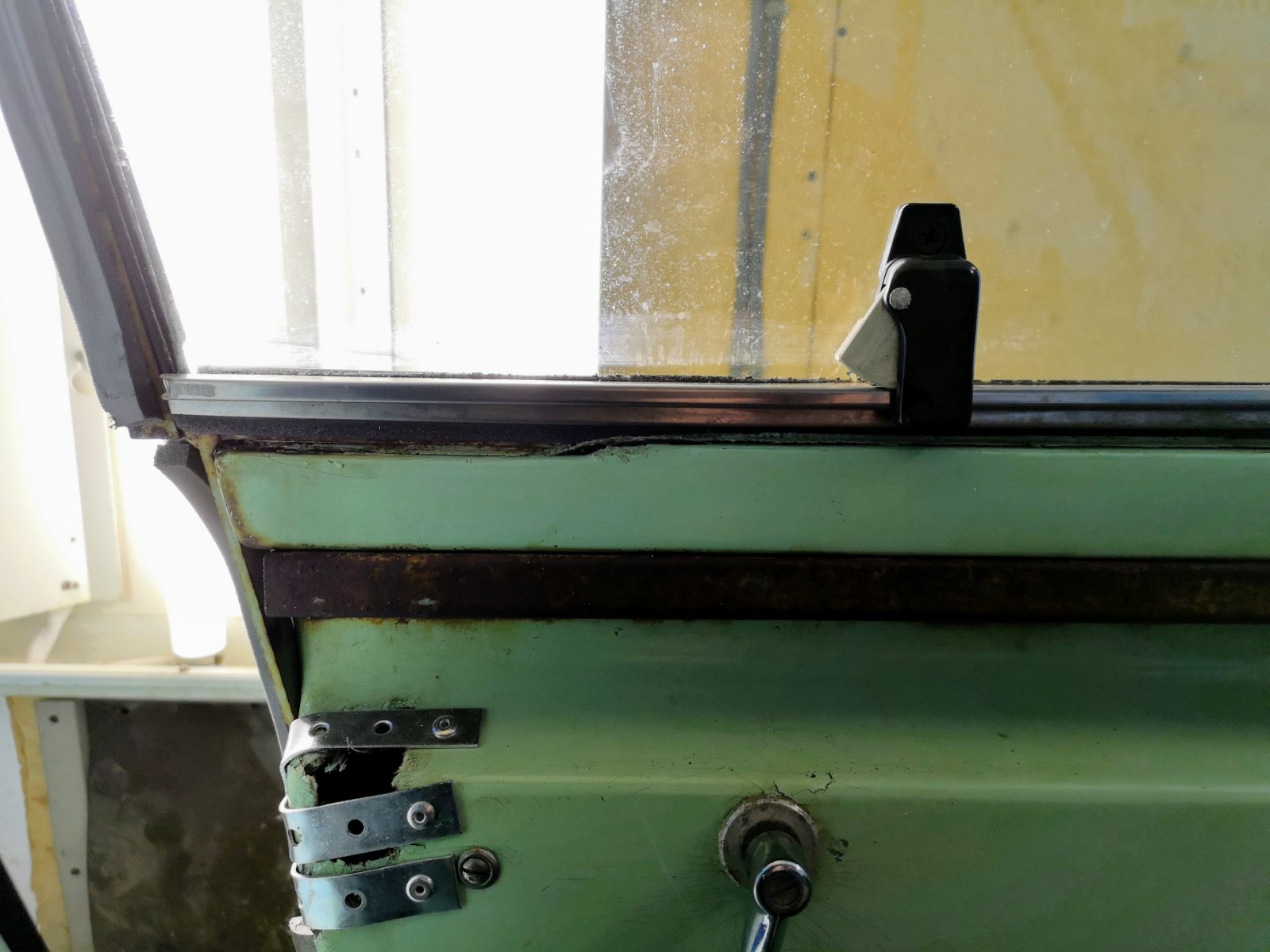

This afternoon I mostly invented several new expletives while referring to whoever designed the doors of an Invacar.
Given I had been improving the weather and soundproofing it seemed silly not to try to do something about the doors.

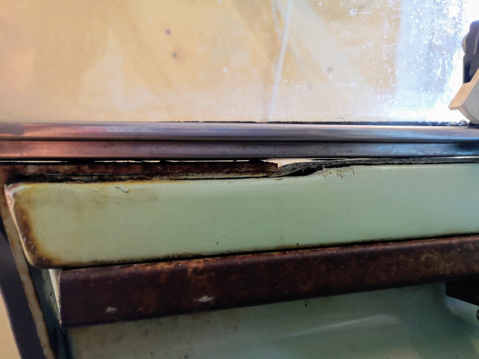

Namely the gaping hole underneath the window runner.
Exhibit A: Having got the actual door seals into a state vaguely resembling useful was to be utterly pointless unless I were to do something about that - which is actually more important as water pours in through that gap whenever it rains.
Roughly two hours later, this is the same area as in the photo above. For completeness, the front of the same door. Originally the window rail was held onto the top of the door by (tiny) self tapping screws. Straight into the fibreglass. These screws, predictably, had next to no purchase - which allowed the rail to lift away from the door. This also allows the inner and outer door skins to move relative to each other.
My solution was to do away with the self tappers and replace them with M5 bolts. Simple enough - though INCREDIBLY awkward where actually threading the nuts onto the bolts was concerned. Hence the fact that the job wound up taking me a couple of hours of swearing to get completed.
The result though is a door which is now mostly weather proof and where the window frame is far more firmly attached to the base than it originally was, plus a door which now doesn't rattle half as much as it used to.
...On the plus side I now have the technique down so hopefully the offside won't take quite as long to sort out. Still no doubt will scrape my arm to bits and give myself as much of a glass fibre rash doing it.

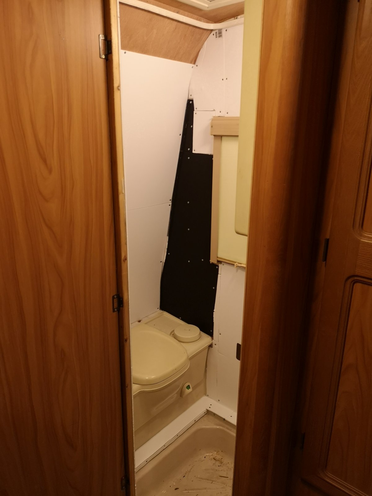

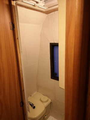

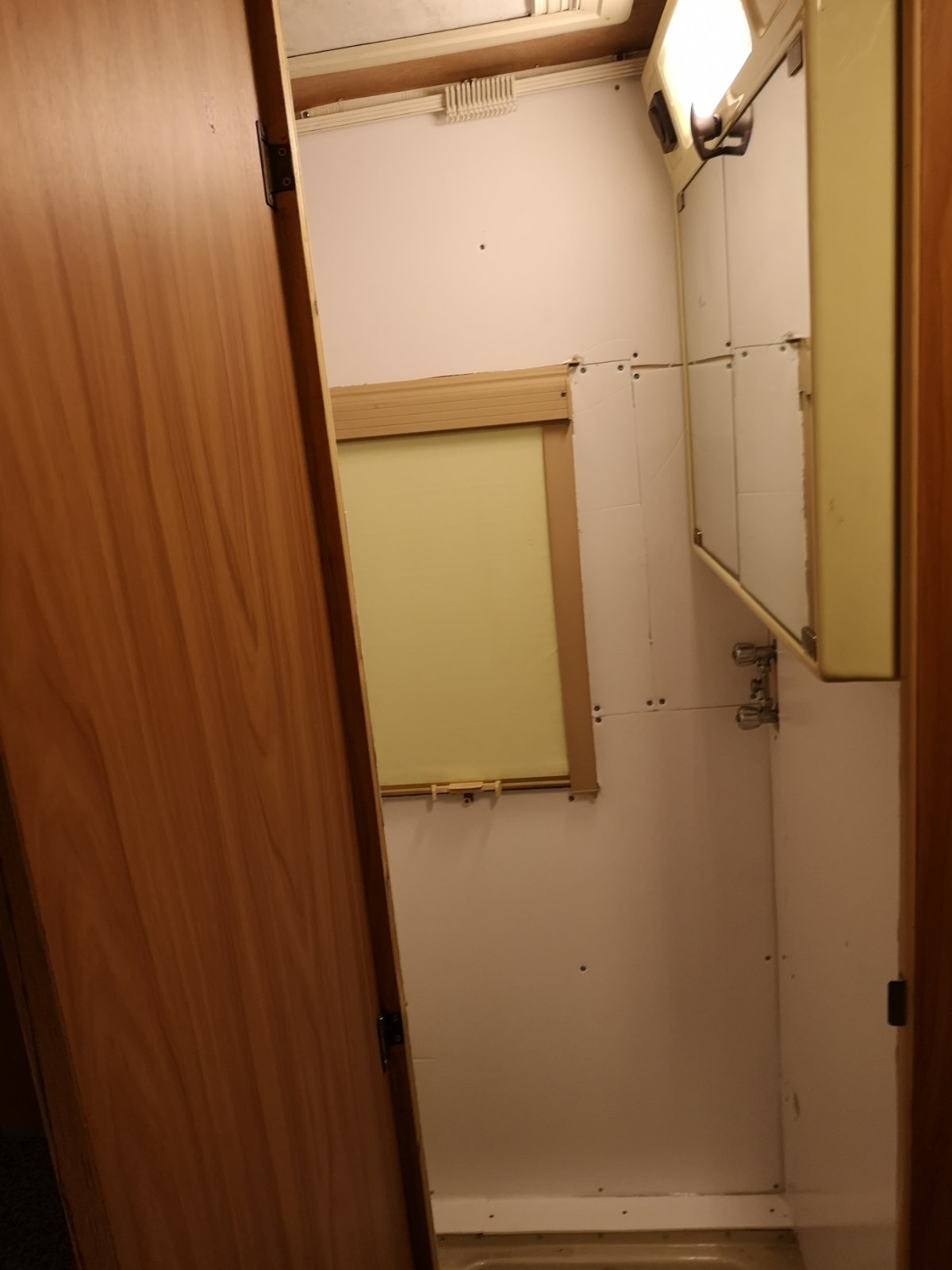

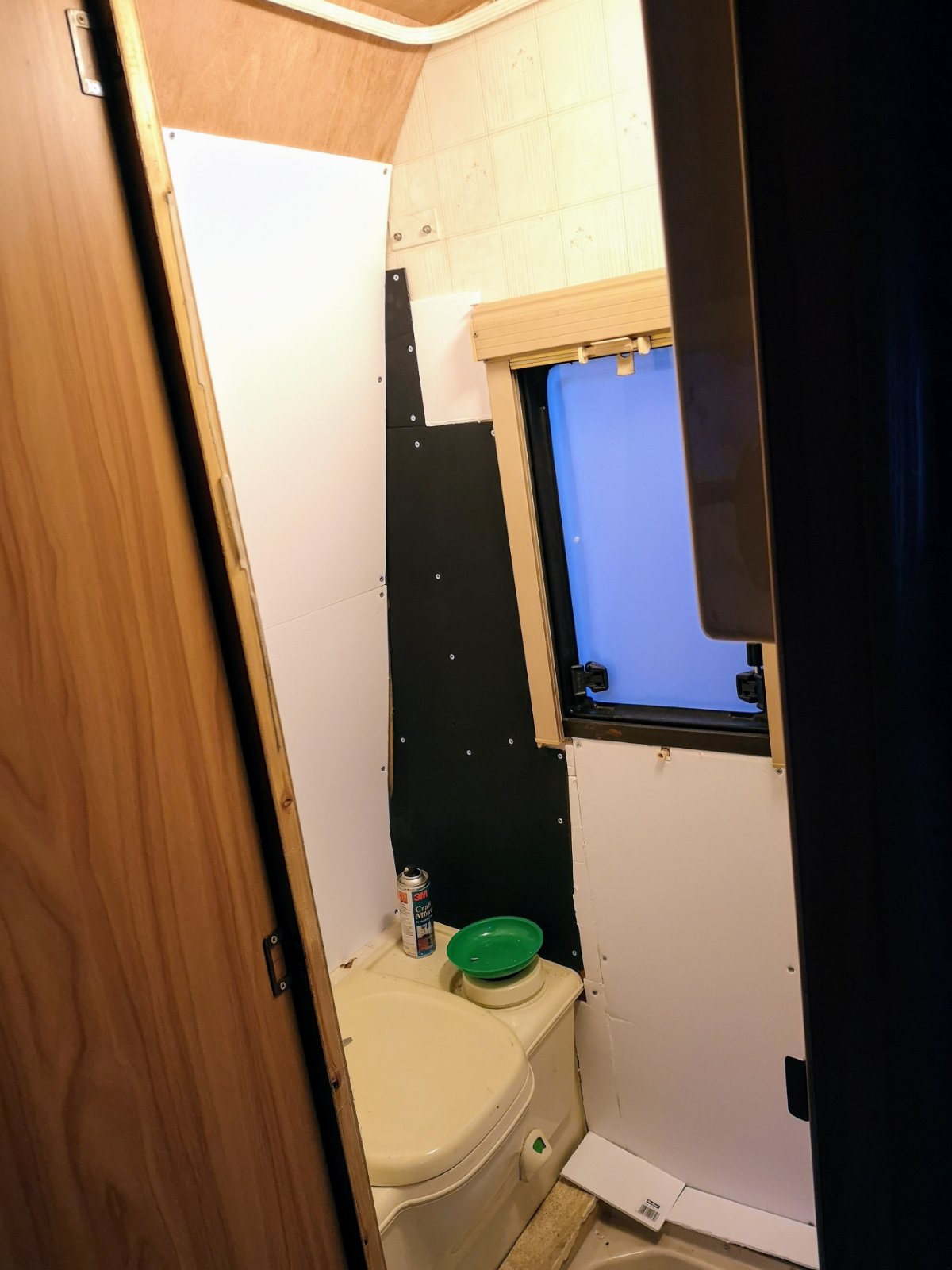

Nothing Invacar related today. Any work in the engine bay requires the garage door to be open, and the wind was blowing rain straight into the garage, so wasn't willing to mess around with that.
Instead though decided to get on with some of the stuff still waiting to be done inside the van well away from the weather.

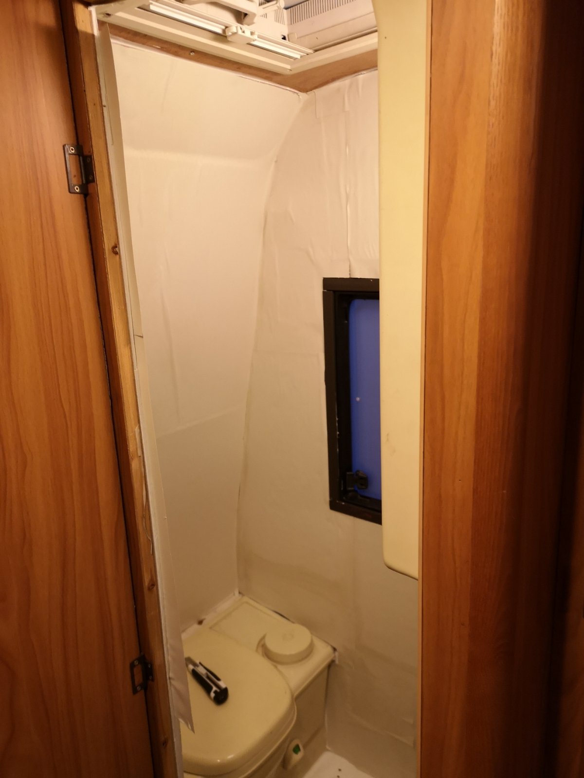

Have now got most of the bathroom panelled in now. Just need to do the last foot or so and around the cabinet and a few fiddly bits. Then have wallpaper to go up (essentially glorified sticky back plastic) and seal the corners and edges.
Still looks a mess - but you can't actually see the innards of the wall any more, and should be fine once we have some decently thick wall covering over it.
Nice to get a bit of work done on this, it's been months since I really did anything on the van and the new holiday season is starting to enter my thoughts now.

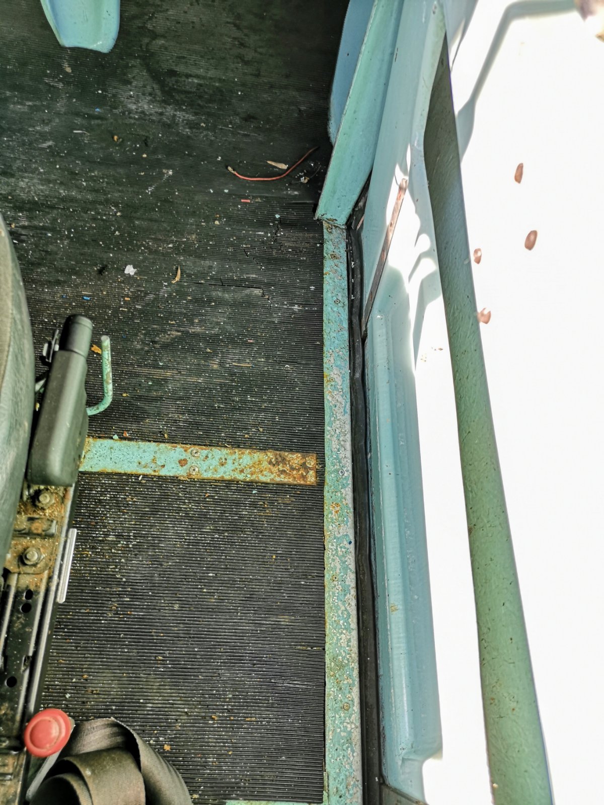

So...the Van (known) MOT to do list...
[] Fit new nearside headlight due to the current one having a tarnished reflector. Already have it, just needs fitted.
[] Replace brake pads (already in stock).
[] Repair or replace the sieve...I mean exhaust.
[] Replace rubber boot on steering drag link front ball joint.
[] Replace the weeping fuel return line.
[] Properly mount the fresh water tank (or remove it for the test).

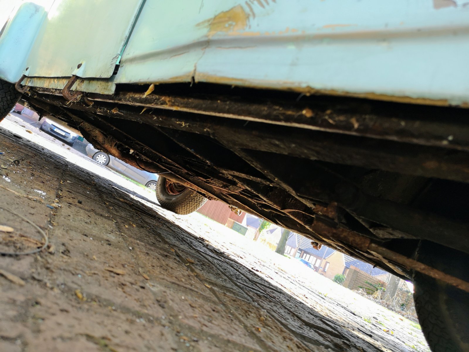

Think that's it for the known MOT stuff. The brake pipes while serviceable are pretty old looking, so I may well get a set of flexi hoses in stock and change them while I have the wheels off to do the pads. I tend to like changing things like that on any new vehicle I get - especially one as heavy as this!

Here is where we were left things today.
All walls are now "panelled" save for the top inch or two because I need to remove the shower curtain rail to do that bit. It's the work of ten minutes to do that tomorrow though. All the corners are now sealed up, as are the edges around the toilet. I still need to actually track down a period appropriate fold out wash basin from somewhere...or just give in and fit something modern.
Worth mentioning that the black bit in the above image is actually identical to the white panels, it's just the remainder of an earlier batch which happened to be black because it was what was in stock.
Next up will be to go over some areas with a quick skim of filler just to smooth out the surface, then wallpaper. Oh, and make a cover to go in the shower tray when it's not in use, hopefully that will reduce the propensity for me to nearly break my neck every time I walk in or out of the room.
It's a room I will be glad to call done as it's so cramped that everything takes twice as long as it needs to and involves at least 50% additional swearing - especially after I've just smacked my head on the cabinet for the fifteenth time.
The room very obviously rattles less now, even when just walking around in the van.
Tomorrow I'll probably finish sealing up the one edge left because I ran out of sealant, then move into finally pulling the carb off the Invacar to get it cleaned up. Have been jumping around between cars a lot this week.

Today I learned a few things.
One, I do indeed still hate wallpapering just as much as I remember. Two, the bathroom in the van is precisely as awkward as I thought it would be to paper.
The reason for this is evenly split between the fact that the room is entirely devoid of 90 degree corners, or truly straight edges and the fact that it's such a cramped space to work in.
To add insult to injury once I did get the paper on the walls it appears to have stretched, leaving wrinkles all over the shop.
Crossing my fingers that things will shrink again and flatten back out a bit when it dries, but I'm not holding my breath.
Granted, it's just lining paper at this stage, so no huge loss if I need to pull it off and start over. The actual wallpaper going in is patterned, and as such is going to be an absolute nightmare to get lined up right.
Oh, while I was in there I took the roof light out and renewed the sealant around it. I'd never seen any evidence of leaks from it while during my ownership of the van, but it has clearly leaked there at some point in the past. For the sake of ten or twenty minutes work I figured it made sense to just ensure it's definitely weather proof.
If the paper continues to refuse to sit right, I may well abandon the whole wallpaper idea and instead to and find some suitably 80s looking fake wood sticky back plastic and use that instead. Planning to install plastic panelling (probably white) up to about waist height anyway to help contain the shower spray.
Really do need to find a proper bathroom sink too...
