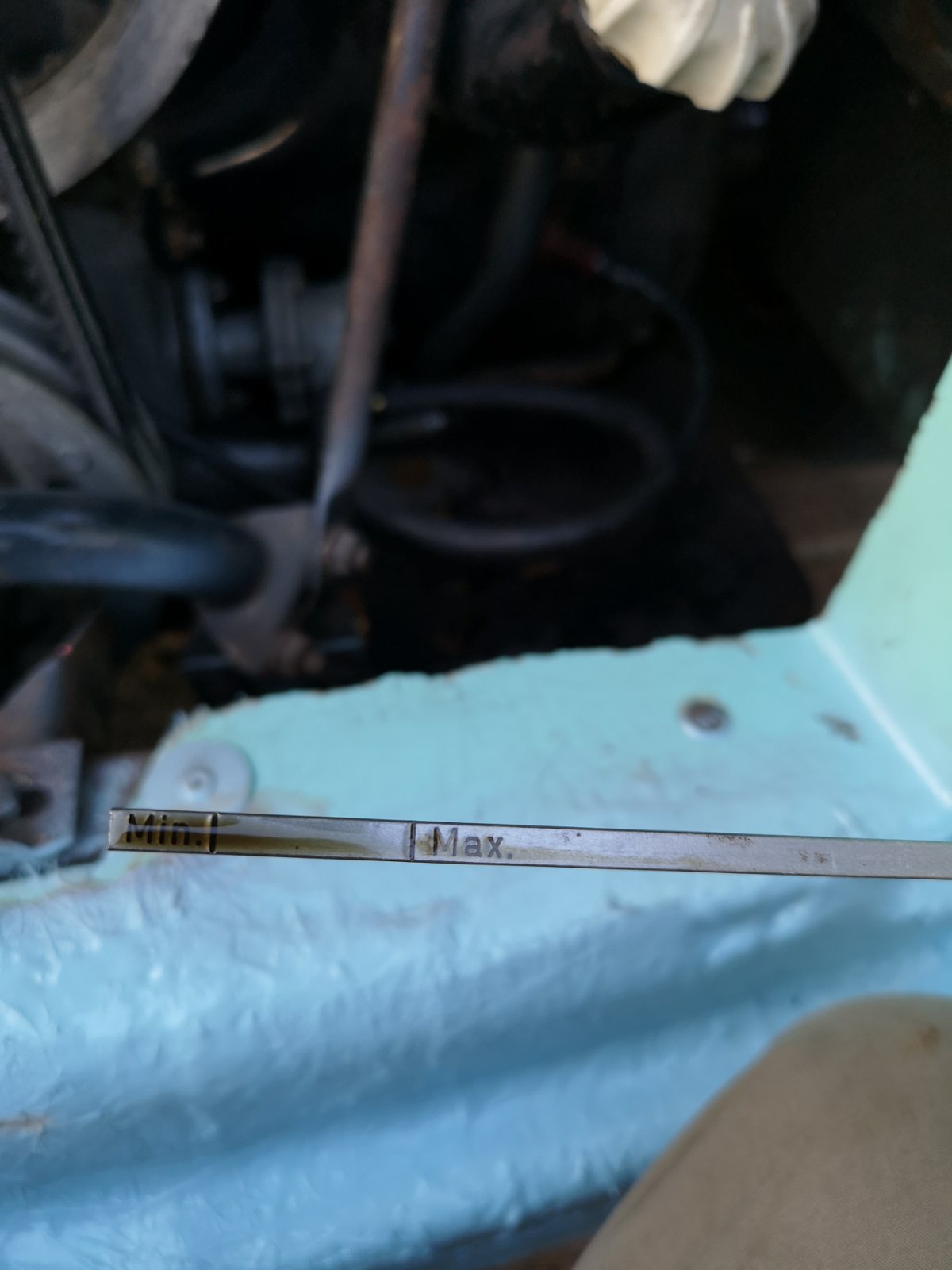

Checking the oil after the trip out today, glad to see that it is still nice and clean.
Oil still nice and clean
Hasn't used any either I'm glad to see.
