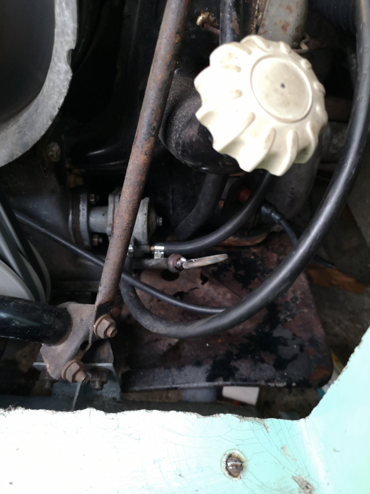

Yep. Annoyingly the dipstick is still weeping. I get the impression that this is going to be a recurring issue...may well see if Steyer have dipsticks in stock as a spare item as it's a minor but annoying issue.

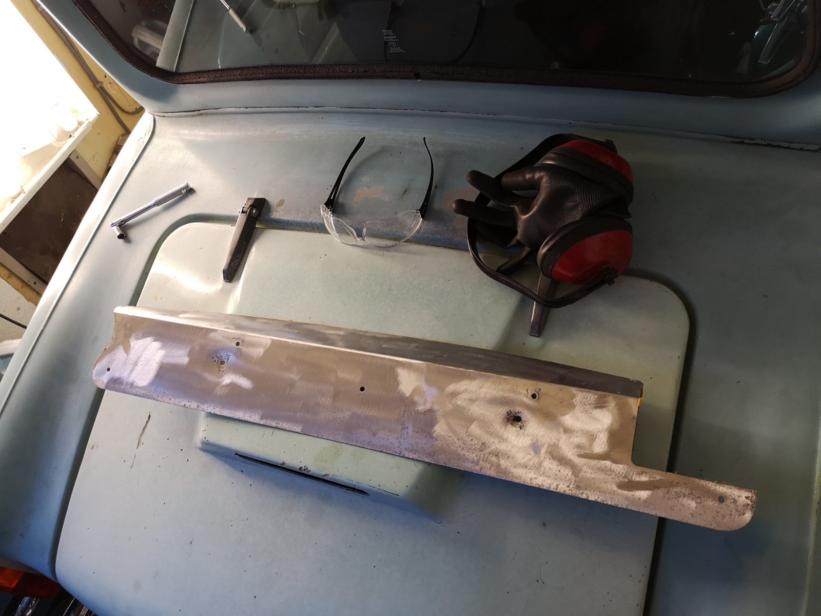

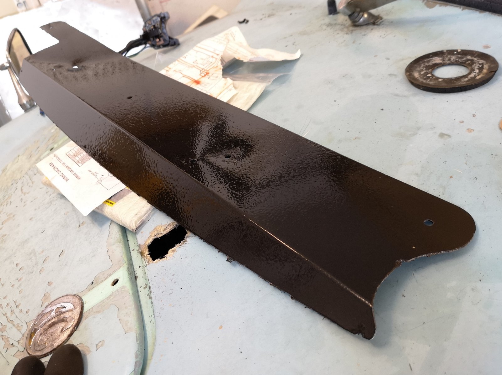

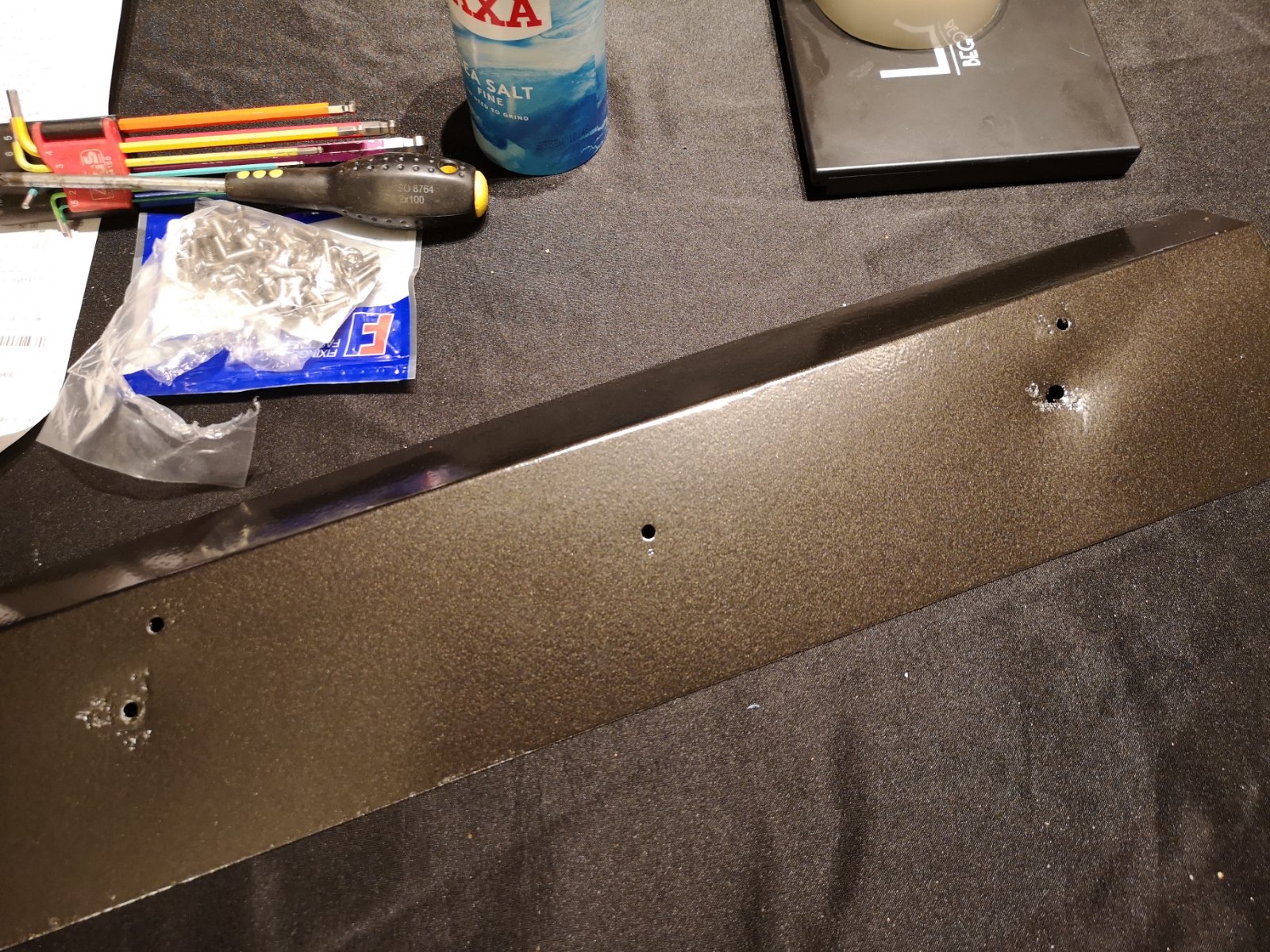

Having finally unearthed the angle grinder which had been missing in action for a while I was able to hit the interior trim panel from above the windscreen with the carbide mop. As I'd hoped the adhesive residue was brittle enough that it came off without much issue.
Quick coat of hammered black paint has it looking rather less scruffy and much more "1960s industrial equipment" which is more fitting with the general aesthetic of the interior I think.

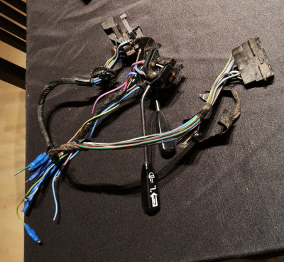

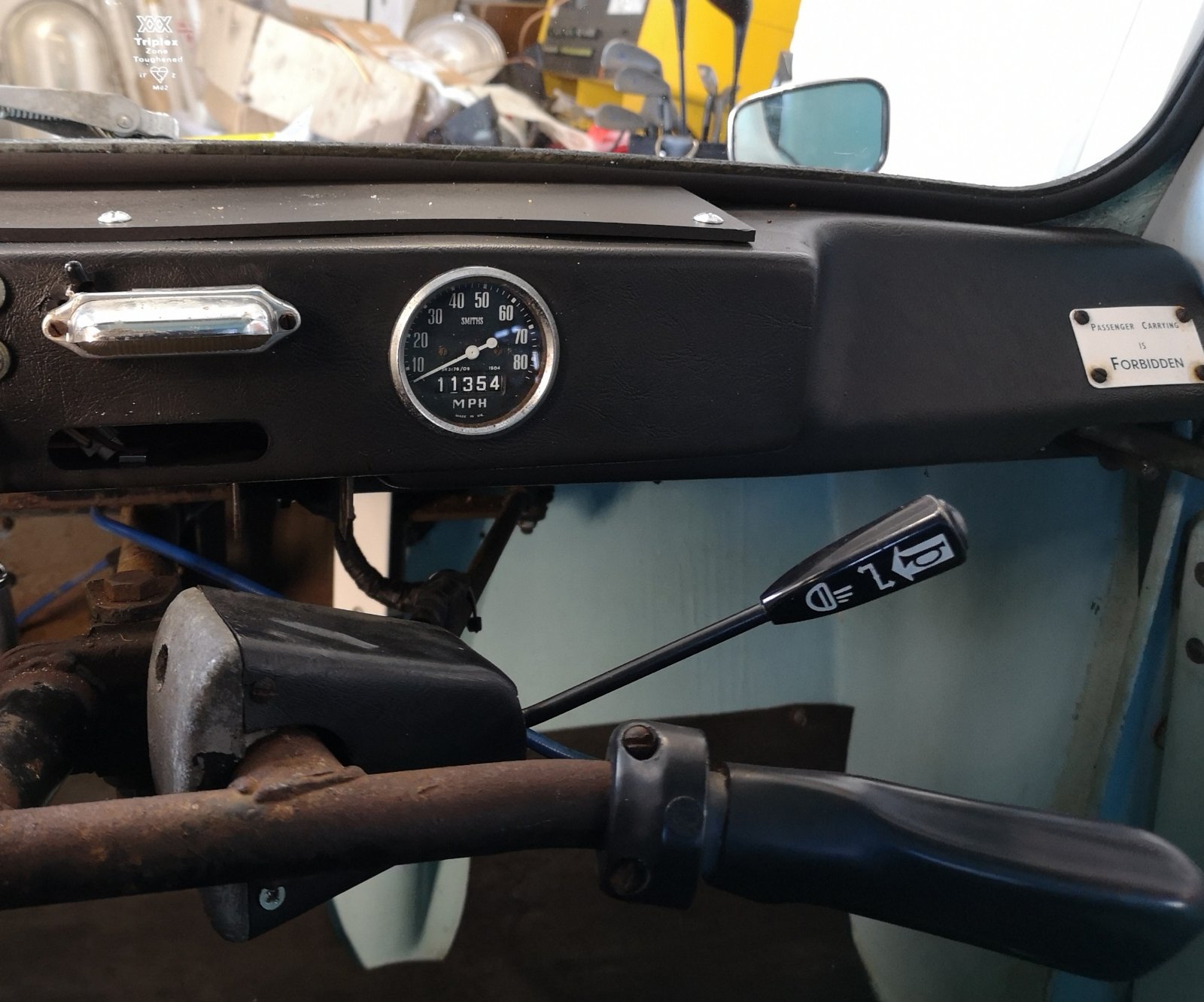

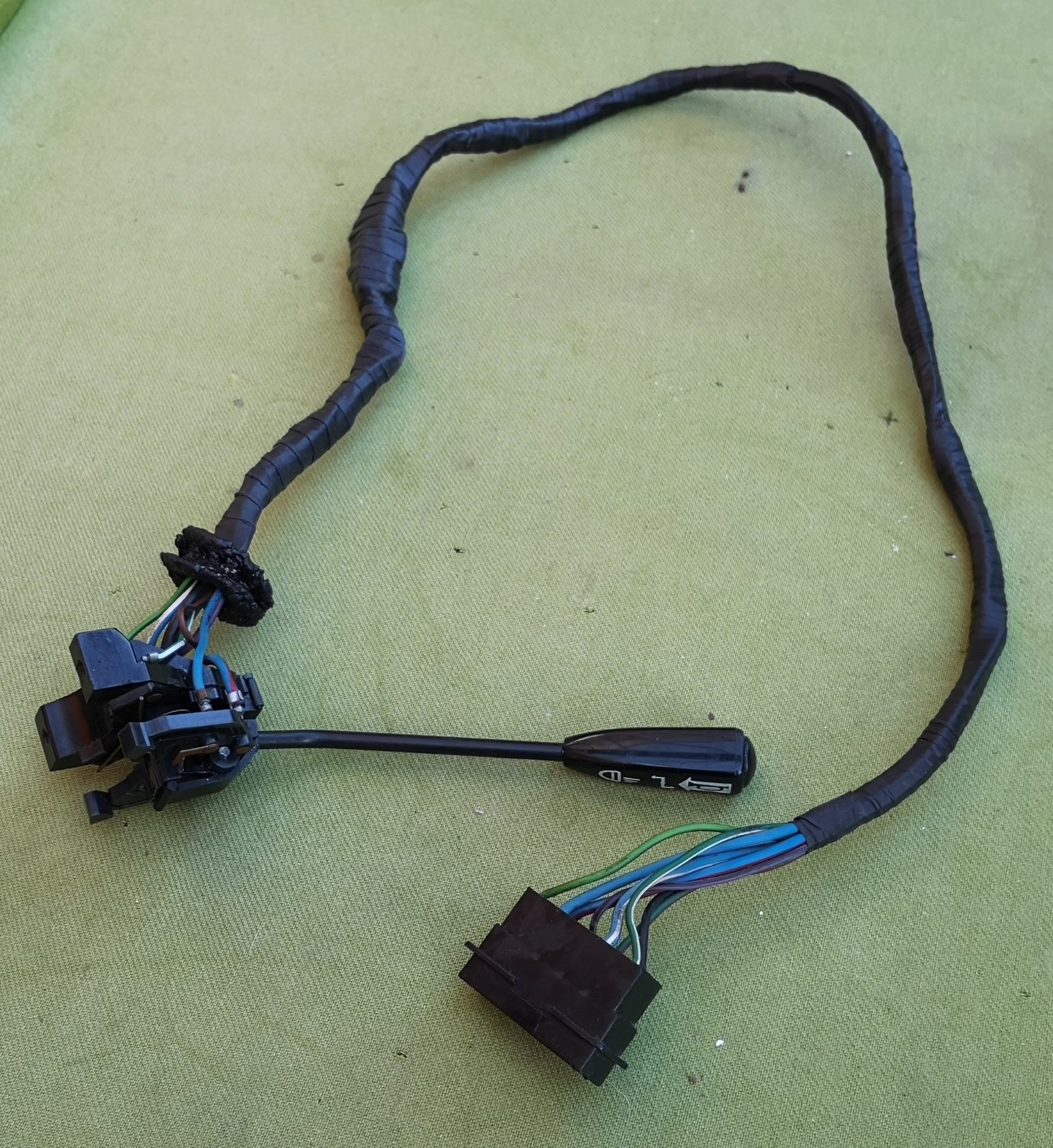

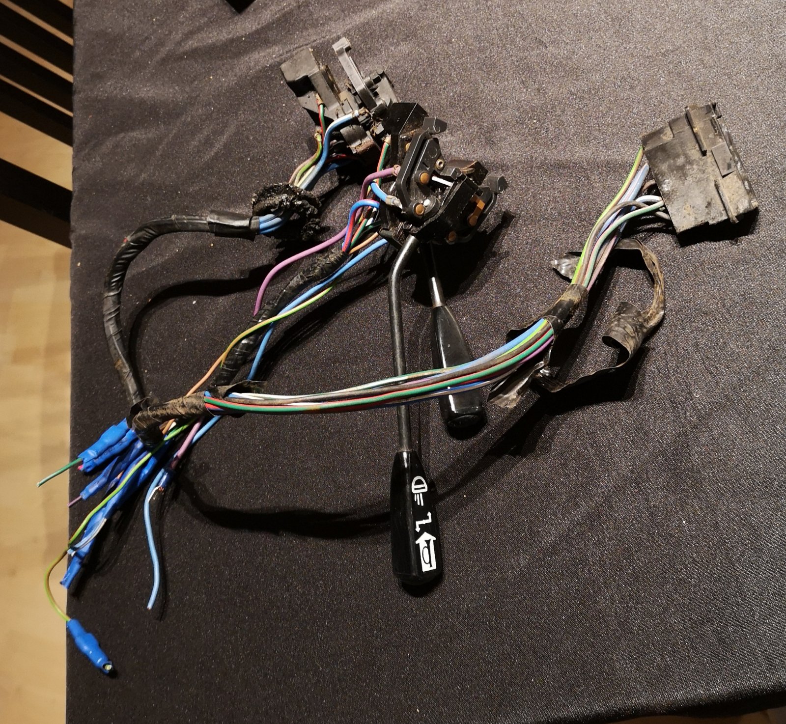

Reliably working indicators are kinda important when we get to the road test, so time to get the old indicator stalk out so I can get the replacement wired in.
That will be this evening's task. I personally prefer the indicator stalk on the right, so this is a good opportunity to swap that over. Given the control layout it makes more sense anyhow as that leaves the left hand free to deal with the stuff on the dashboard.

Didn't take long today to get the new stalk wired up to the existing indicator stalk wiring loom.
Not the prettiest job, but it should be electrically sound. The connections were made with crimp butt connectors which were then also soldered and heatshrink wrapped, before the loom was then re-wrapped. In hindsight I should probably have continued the wrap about an inch closer to the back of the switch itself...but I'm not worrying about that now. I did away with the grommet in the end as it was just getting in the way.
Had to rotate the throttle grip slightly to prevent the indicator stalk from fouling on the cable when signalling right, and the cowling needed the opening made a little wider to accomodate the high beam flash feature which the original stalk didn't have. There was originally only one screw holding the plastic cowl on, so I had to have a bit of a rummage around in the box of random fasteners but soon had it properly secured so it doesn't wobble around like it used to.
The only thing that I need to be careful of is that at extreme full left lock the stalk can foul the dashboard, though I doubt that will really be an issue in the real world.

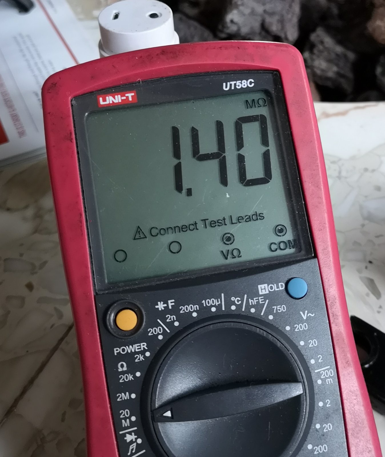

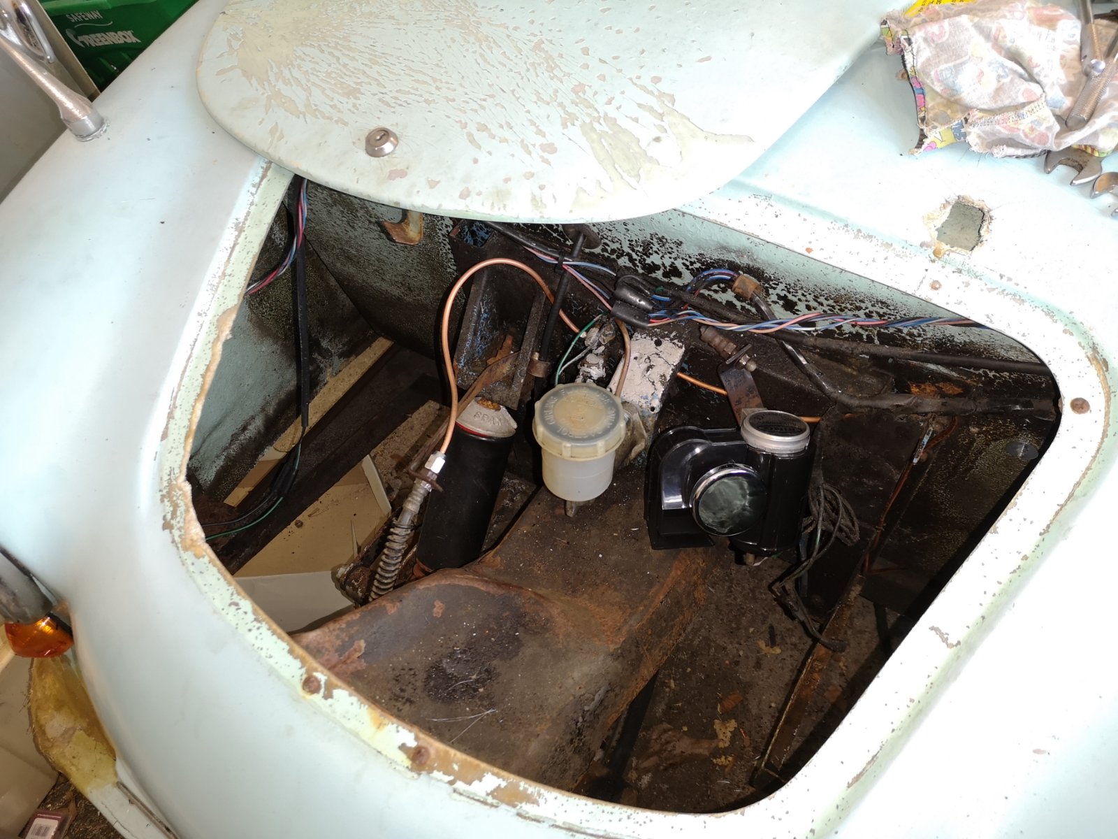

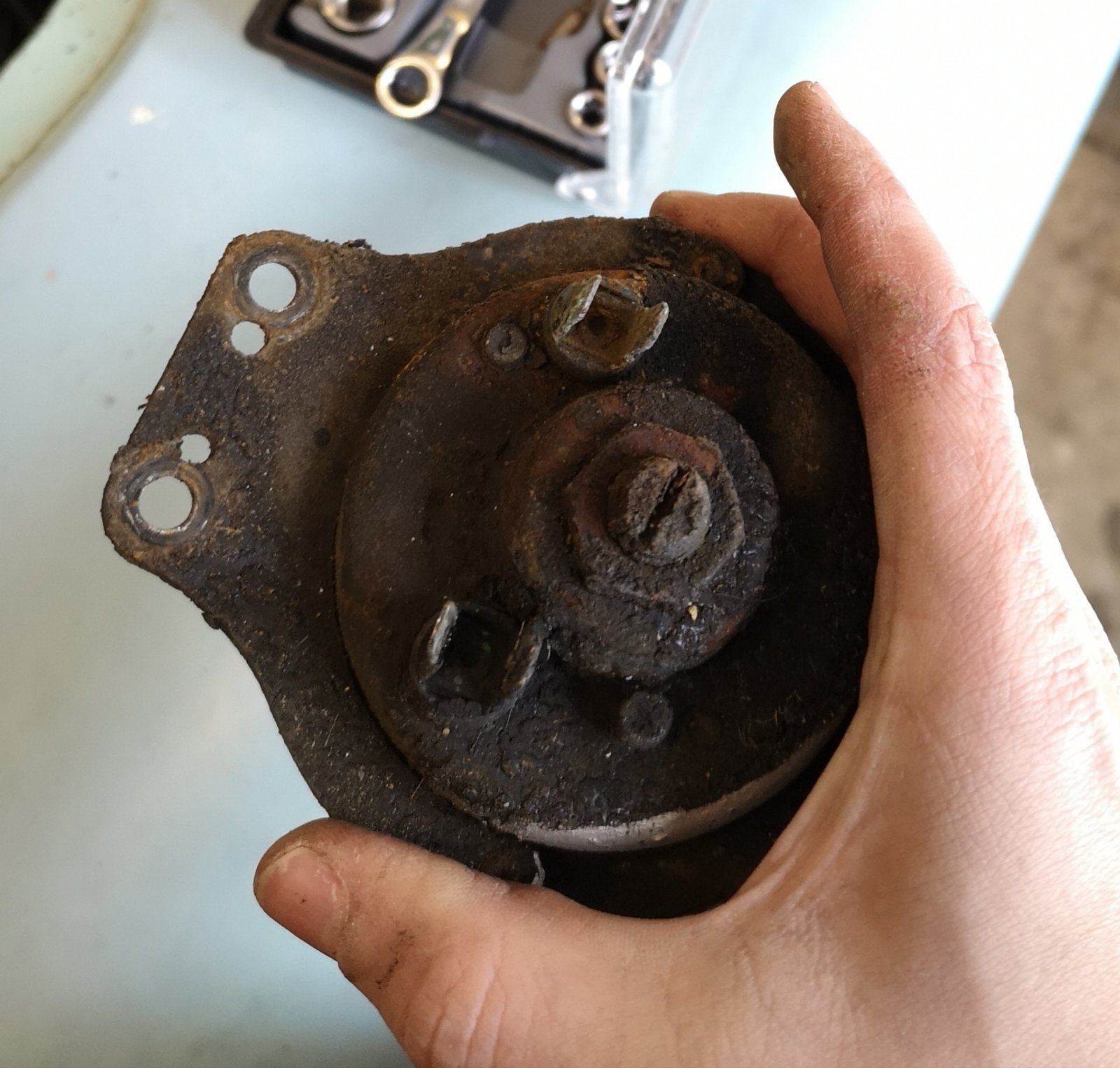

All the lights are now behaving properly again, however still no signs of life from the horn. Given that the front service cover was I believe open for a number of years, it's unsurprisingly looking a bit worse for wear.
Connecting it directly to 12V resulted in nothing happening. Checking with a meter revealed that this does indeed seem somewhat poorly.
Not going to waste time trying to resurrect that or find as close a match as possible. My plan has been since day one to fit something which is rather louder than standard, so an air horn will be getting installed tomorrow. My logic is that a tiny car needs a Very Loud horn, especially living in a city of blind Audi driving maniacs and never ending roundabouts.
Here's how the trim panel from above the windscreen has come out.
The visor has now been reattached and hopefully I'll get it reunited with the car tomorrow.

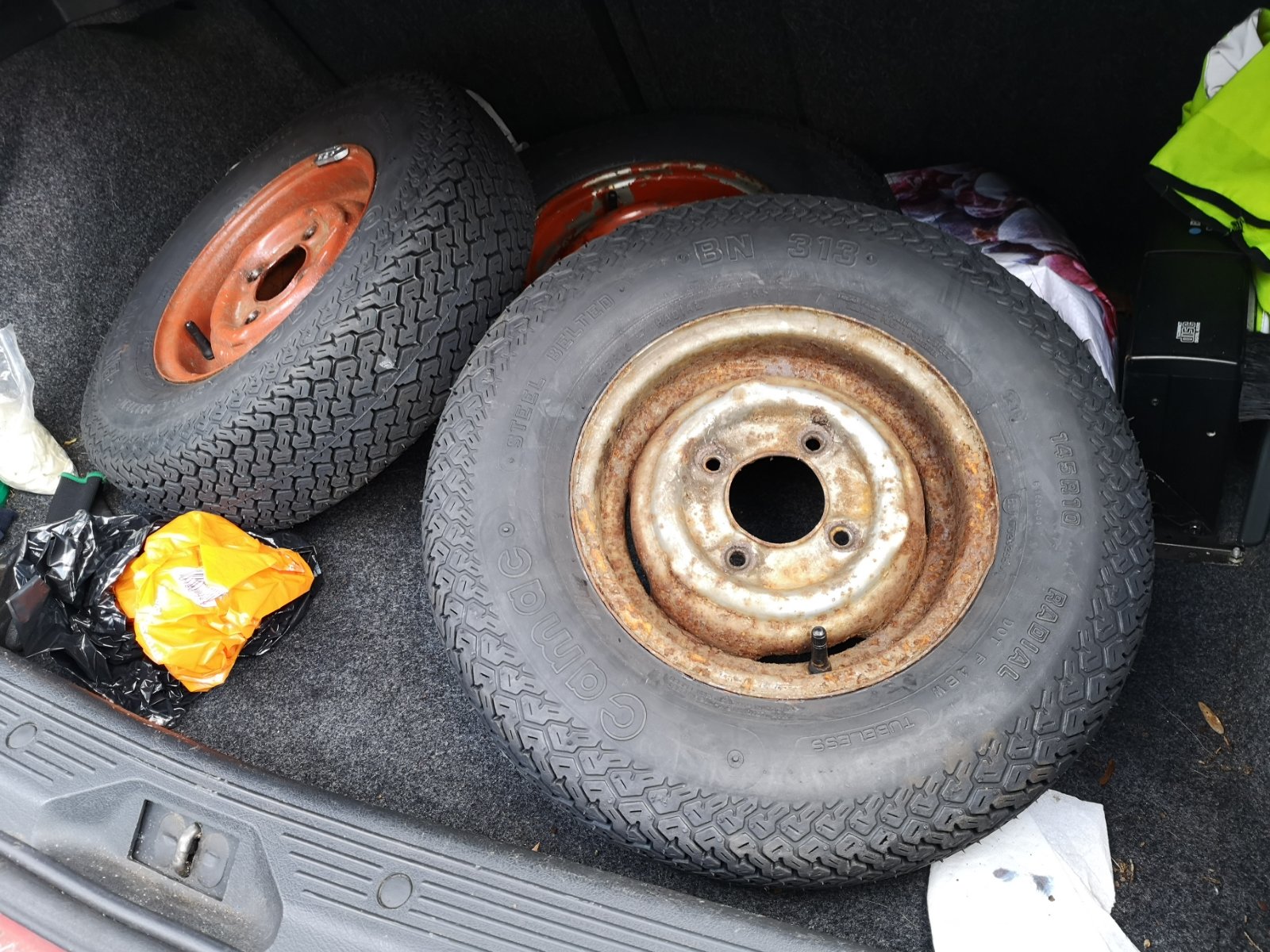

Tomorrow I'm going to head over to speak to Vintage Tyres and get that item on the to do list checked off with three new tyres. If they don't have them in stock I'll get it booked in for a home visit.

The wheels from the Invacar are currently at Vintage Tyres in Bicester, and should be ready to pick up with new tyres fitted in the morning.
A moderately deep level excavation of the loft turned up the air horn I'd bought a while ago for another project.
A slight problem turned up in that it couldn't fit on the original mounting point as it was too big. Cue some brief improvisation.
I still had a bracket in the front compartment which had originally been a support for the front brake flexible hose. However I had not been able to convince the end left over from the original hose to unbolt from it. However as KP used a different bracket I'd swapped that over and just left the original in there, it didn't really get in the way or anything. That bracket however was exactly what I needed to act as a spacer to attach the new horn.
So started a three quarter of an hour fight with it to try to remove the ferrule from the original brake hose. Between penetrating oil, brute force, having the whole thing glowing red hot... eventually the blasted nut threaded itself...and still won't come undone. So it's still there for now!
I'll just chop it off with the angle grinder next time I have it out. Just one bolt to get it off the car after all. I'm not worrying about it for now. I'll need to wire up a relay to provide power for it as well, but being virtually next to the fuse box (it's about six inches away on the other side of the bulkhead) that won't exactly be a chore.

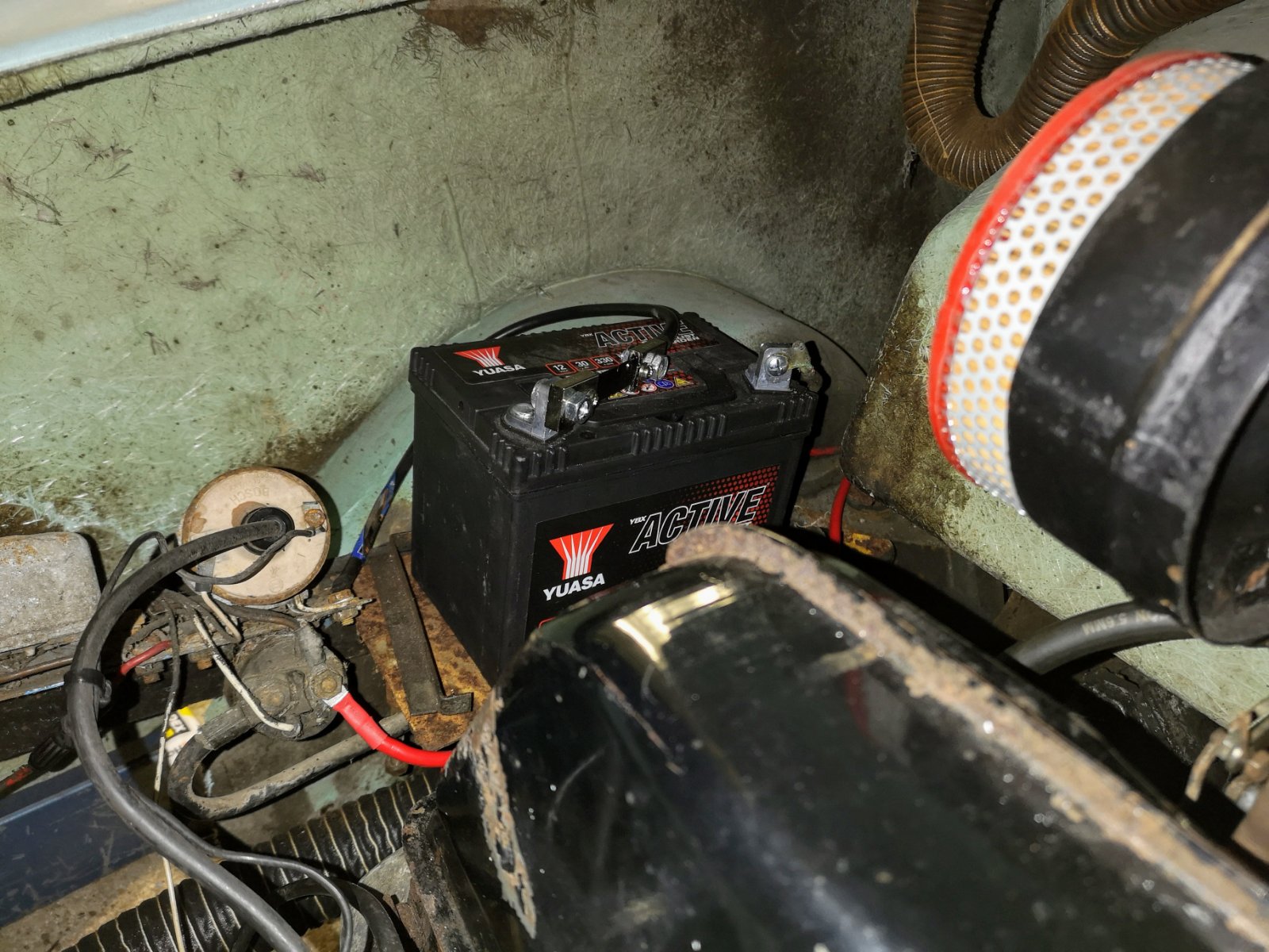

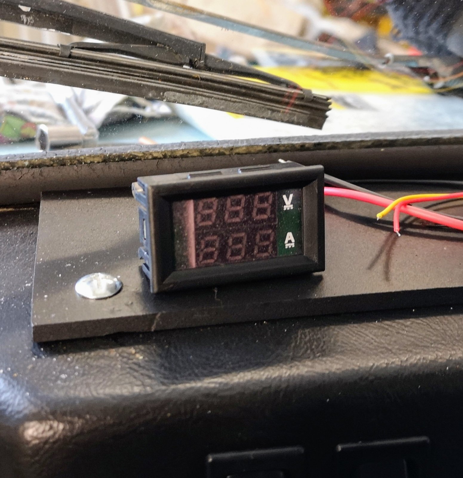

Speaking of electrical stuff, this tiny little combined DC voltmeter and ammeter turned up today.
This obviously won't be a permanent addition to the dash as it's so out of period. However during the initial shakedown period I'll take as much information from the car as I can get - it did spend 15 years dumped in a field. The charging system is worthy keeping an eye on too as any glitches with the voltage regulator (which is mechanical) can destroy the battery and the Dynastart unit itself...so if it plays up I want to know about it.
The shunt which was supplied with this is rated for up to 100A continuous, and given that the starting circuit is fused at 50A this meant I could just stick it directly in series with the battery feed (and I wanted to change the ground lead as it was somewhat dog eared anyway). Version 1.0 has the shunt just attached to the battery.
I don't like this. Even though it's not a permanent addition... it'll be getting moved to a better supported and tidier location tomorrow, probably either under the battery tray or on the tray the coil, solenoid and voltage regulator live on.
I hadn't spotted how manky the battery to lead connection on the positive side was until looking at these photos, I'll get that changed out for a new one tomorrow.

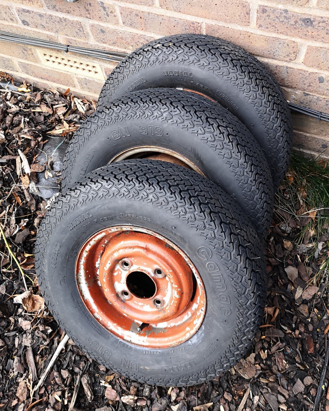

While I didn't actually have the opportunity to do anything to the car today, two very important parts have now arrived.
While my wallet may now be £200 lighter, I've got three nice new tyres on the wheels.
I'm really happy with how in period those tyres look.

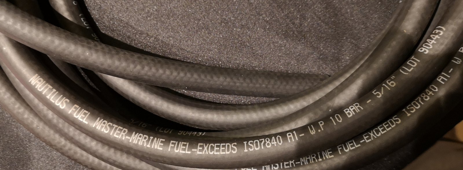

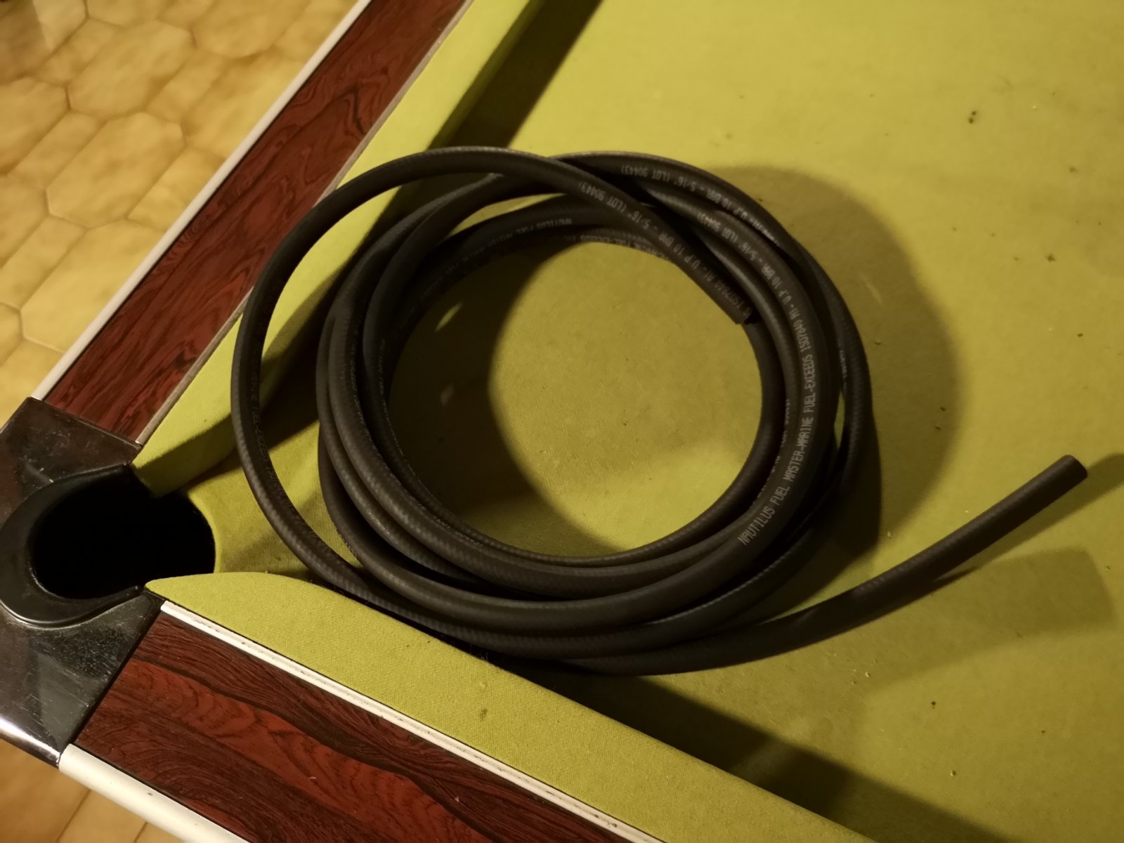

The other thing to turn up is this bundle of fuel hose.
It's worth noting that I've kind of lost patience with hoses starting to disintegrate virtually as soon as they're fitted, so I may have resorted to slight overkill.
Let's see how that lasts shall we? Only downside is that with the pipe walls being about twice the thickness of the ones on there I'm going to need to get a bunch more hose clips.
I'll get the wheels back on tomorrow (she's currently sitting on three very flat tyres) and get the fuel hoses routed properly so that's all ready for the fuel tank when it turns up - which should with a bit of luck be in the next couple of days.

Nope...the horn is resolutely dead. It's been dropped, whacked and smacked with a hammer...dead as the proverbial dodo.
The eagle eyed among you may have noticed the mistake with the fuel hose. Yep... they've sent me 5/16" hose - not the 3/16" I ordered. The seller has been really polite though and replacement is already on the way. These things happen.

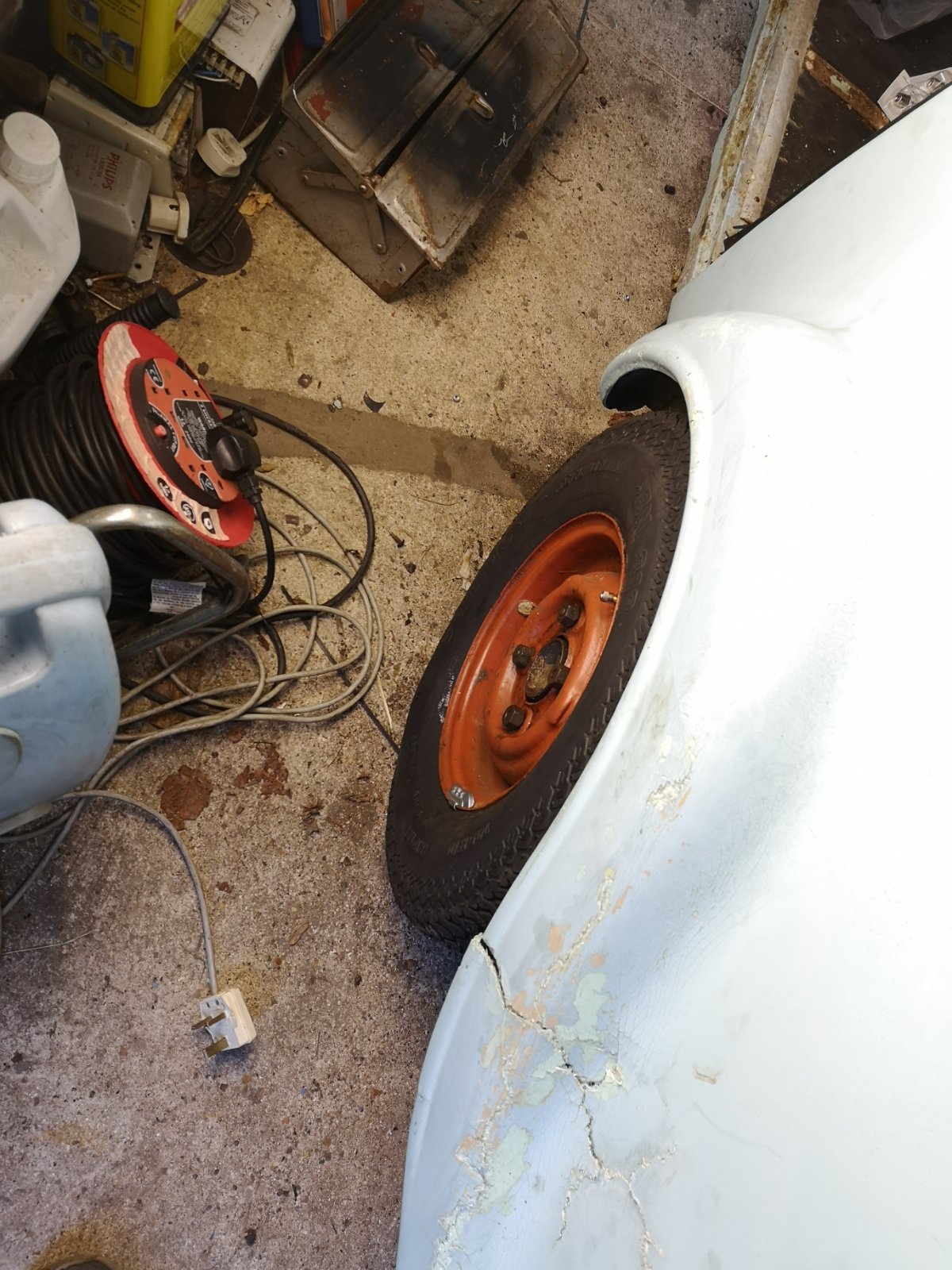

Well firstly these obviously needed to be fitted to the car.
I'm getting far too much enjoyment from how genuinely like something you'd have seen this car roll out the factory wearing back in 1973 these look like, despite the December 2018 production date.
While I had the wheels off I set about checking the shoe adjustment, sure enough the one I'd not had totally to bits had a heap of slack in it. Nipping that up has greatly reduced the amount of dead travel.
Hard to show how the tyres look on the car as it's really cramped in the garage.

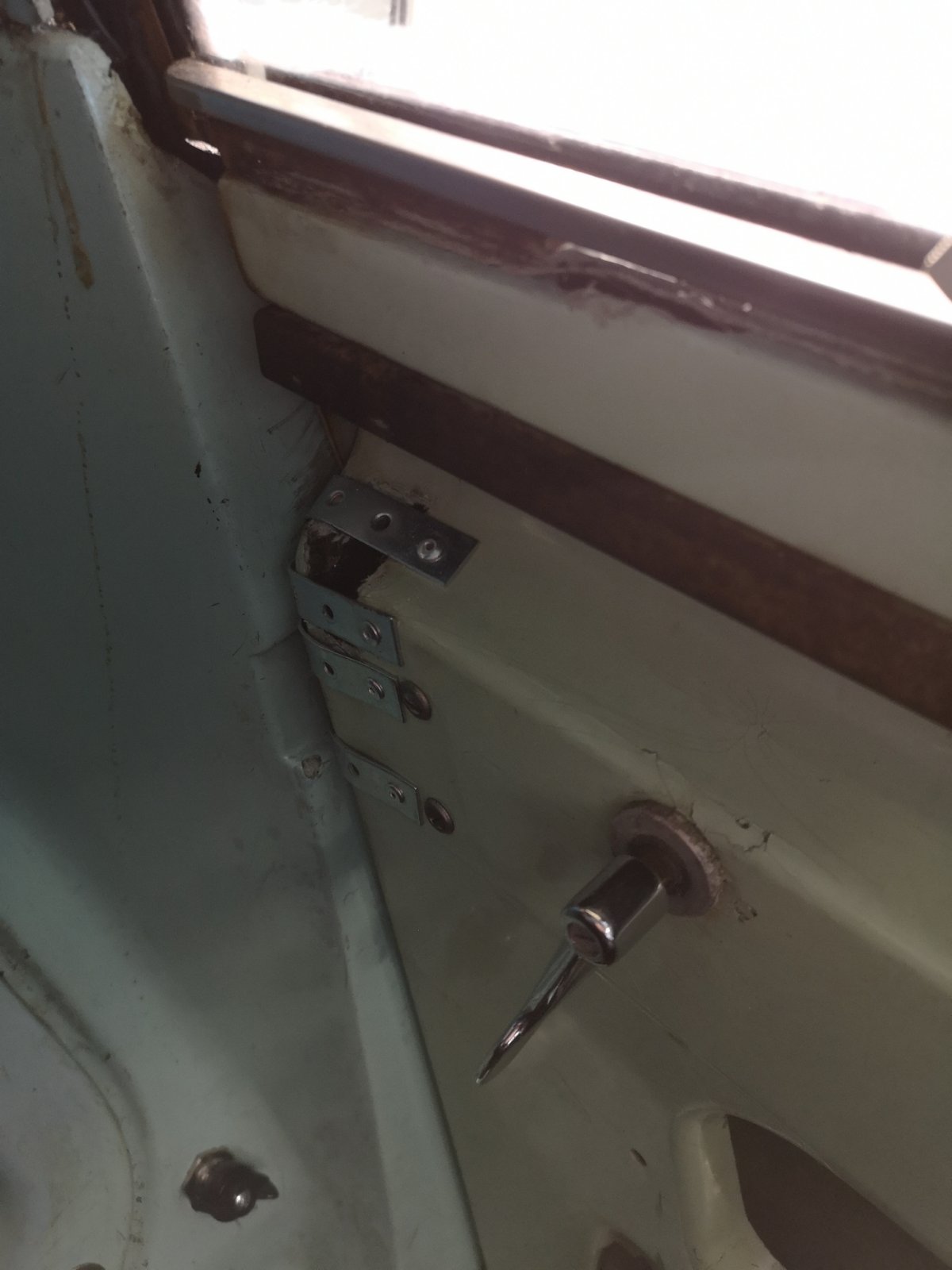

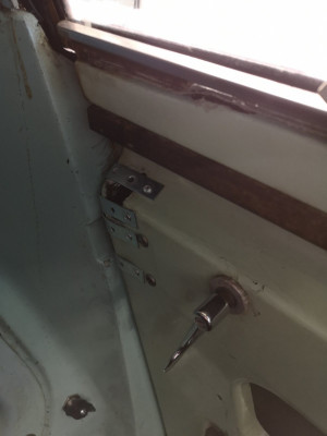

Final task on my list for today was "shore up NS Door.". Some of you may remember from the interior photos that there is a hole in the interior surface of the nearside door to the rear just below the window. My guess is that somebody at some point has shut something in it.
Now if this wasn't so close to the latch I would probably just have ignored it for the time being. However as it was so close to the latch it had a serious effect on the rigidity of the door in that region. As such I needed to tie each of the surfaces involved back together again. This is a job I'll probably get a body shop to do at some point as it will require a bit more finesse than I possess. However this has vastly improved matters from a functional perspective...
It's particularly noticeable in that the door closes with a slam now rather than a hollow rattly click, basically because there's no longer about 1/16" of lateral movement in the latch itself.
