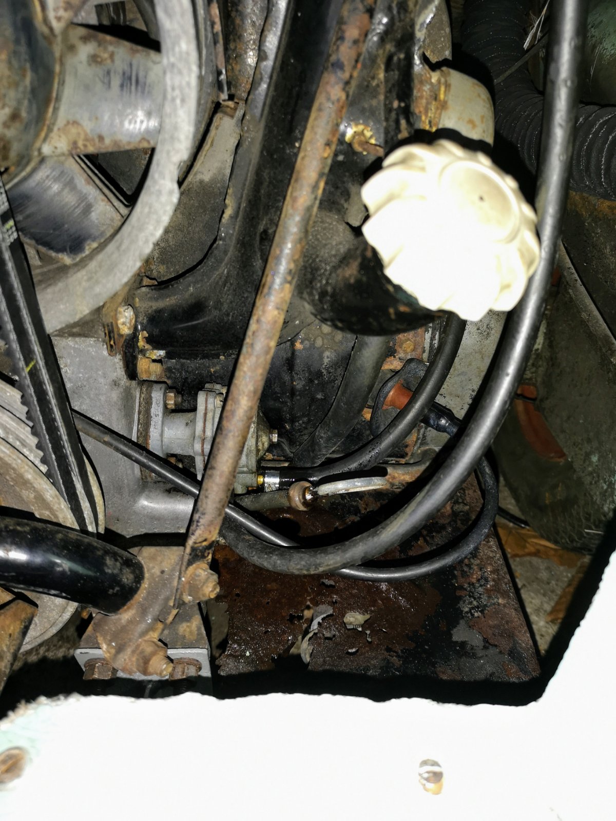

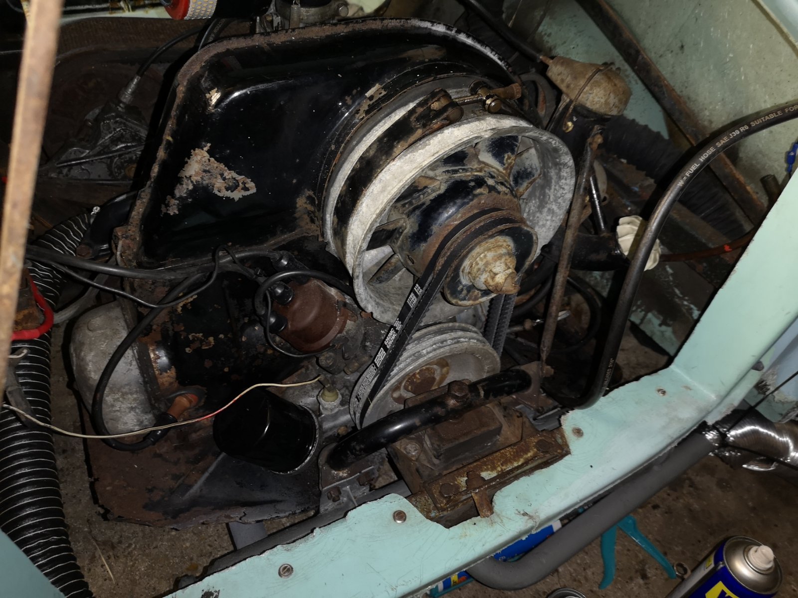

So first task of the day was to get the new belts fitted. Ten minute job, and the tension even seemed to be right off the bat, though obviously I expect that to change once the engine has run.
10x813 is the belt size in case you wondered.
Attempting to *do* that was foiled by the thing refusing to start again. I'm willing to bet money the offside cylinder has flooded and fouled the plug again. This seems to be an issue after a series of very short runs, and I'm hoping will resolve itself once I'm able to get it a proper run. I decided after it started on one cylinder to just file this under "come back to later as I've better things to do just now."

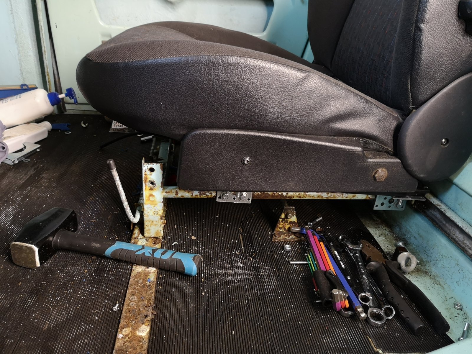

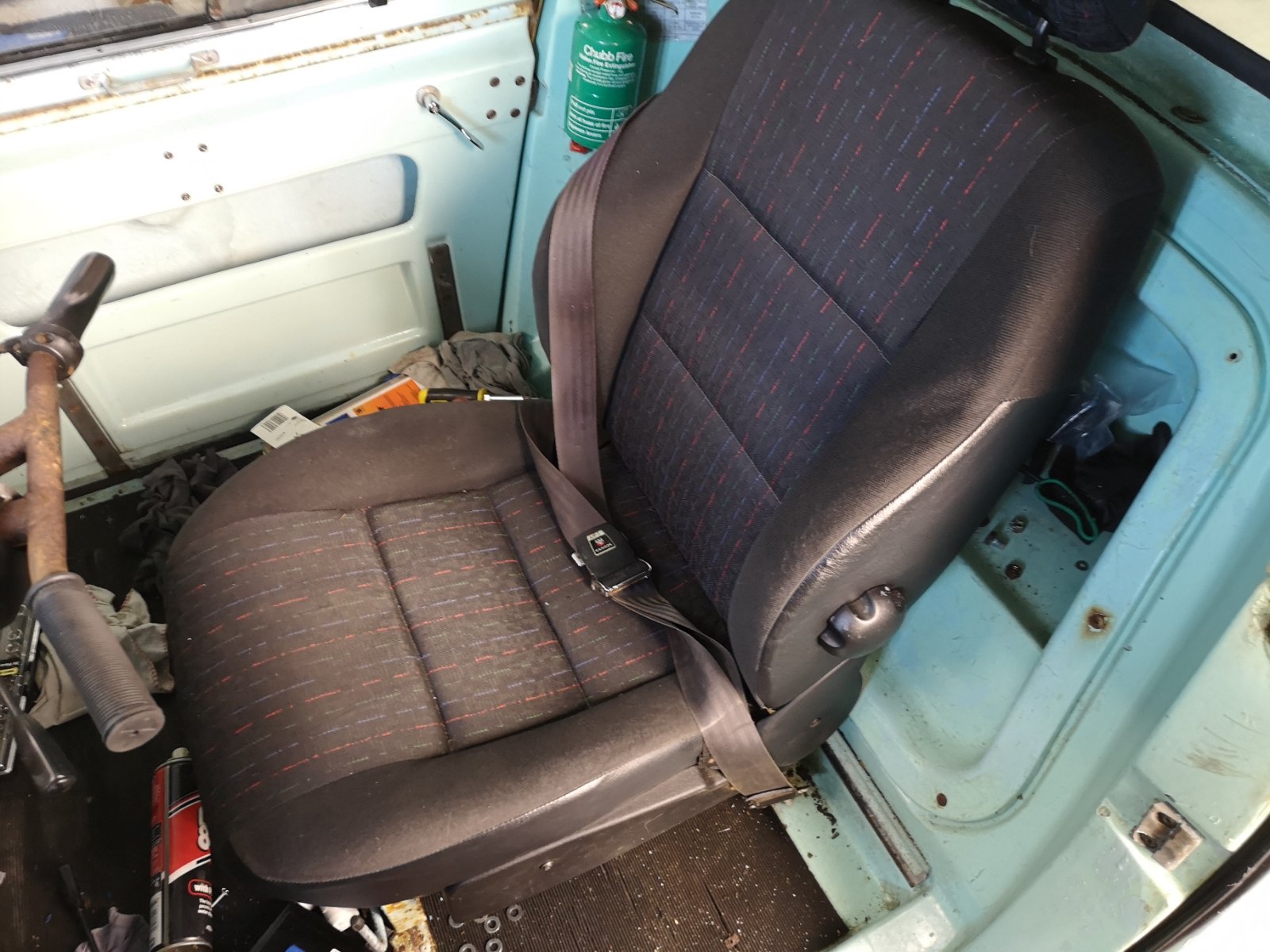

Next up, seat. Let's get this sorted out once and for all.

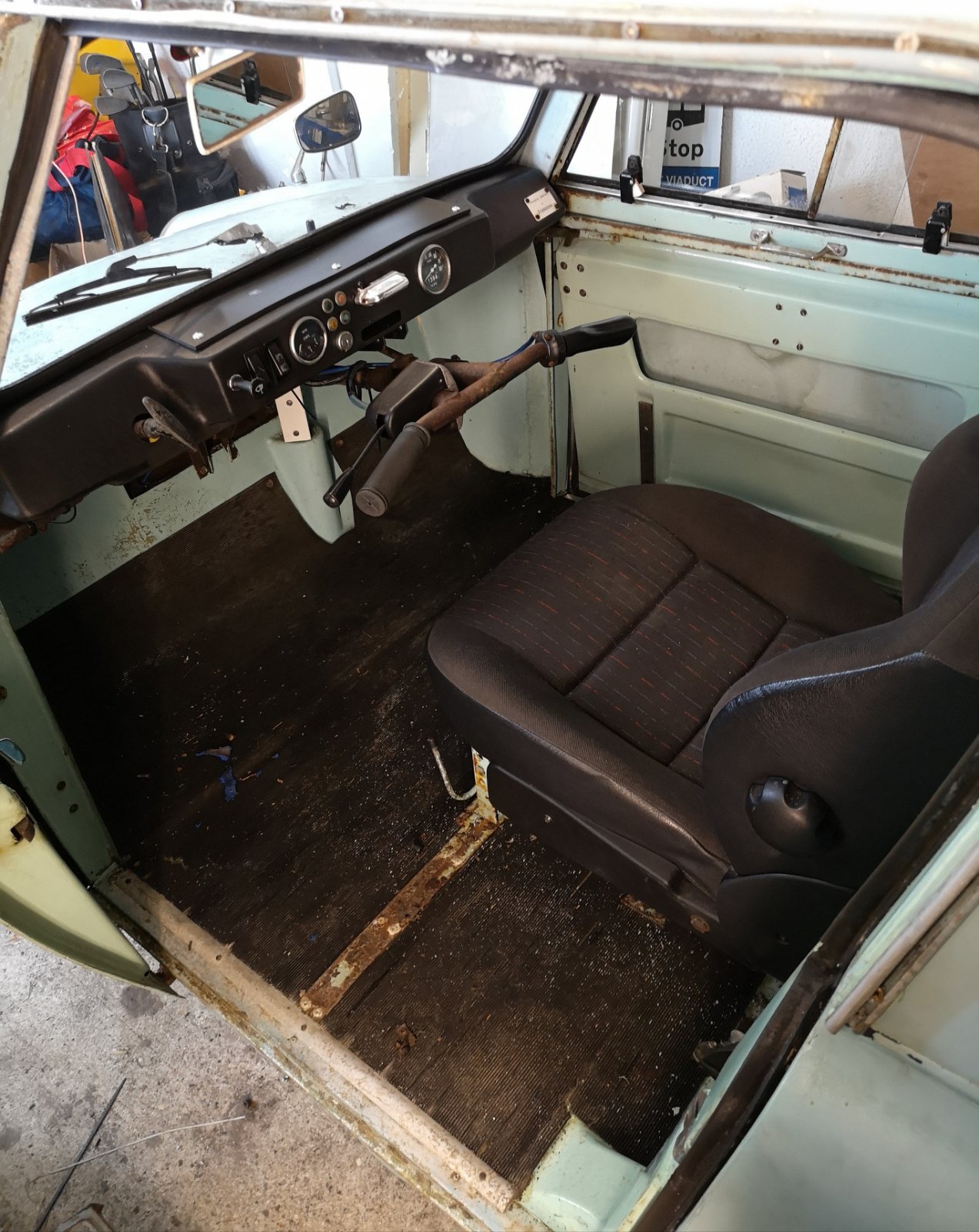

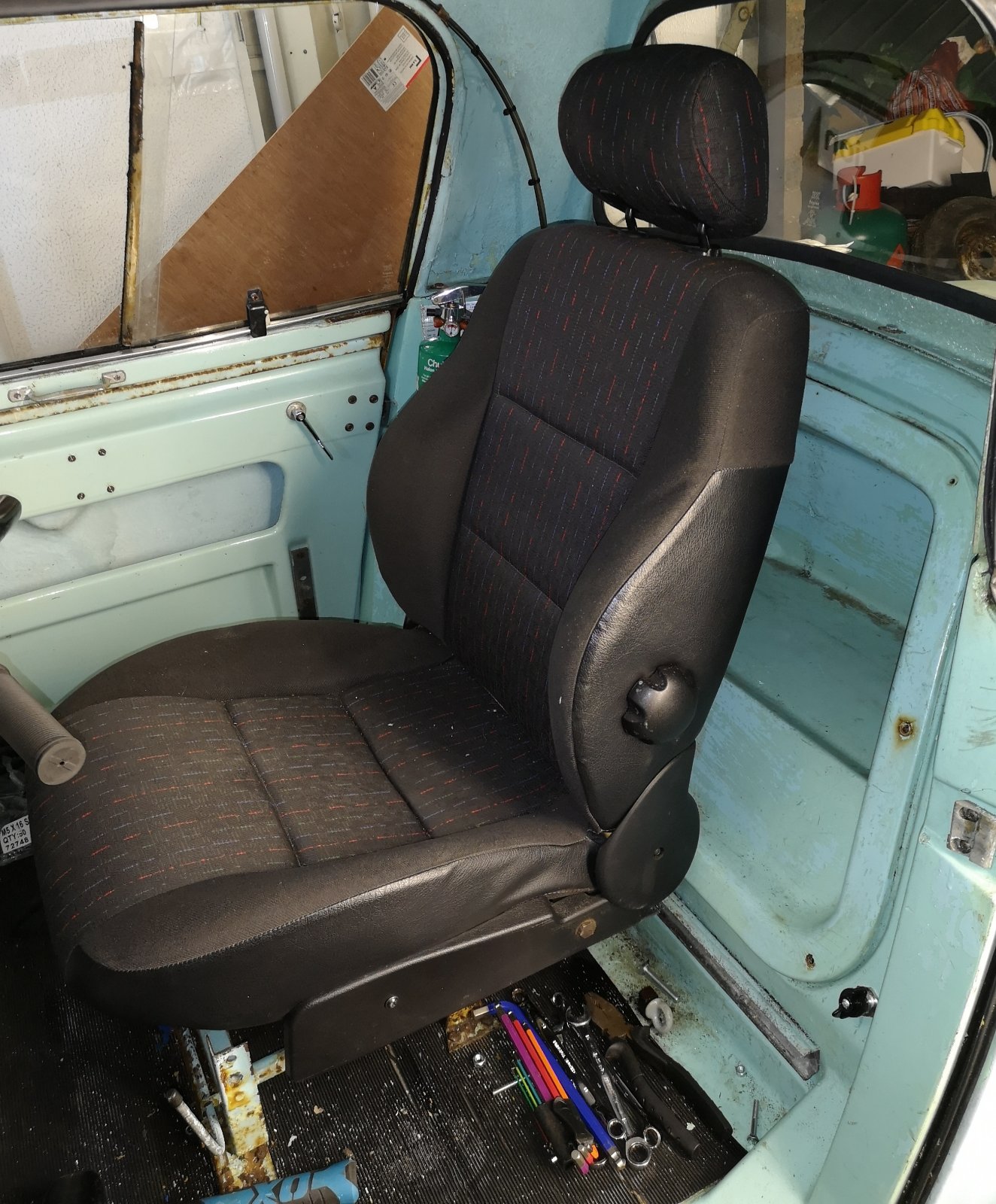

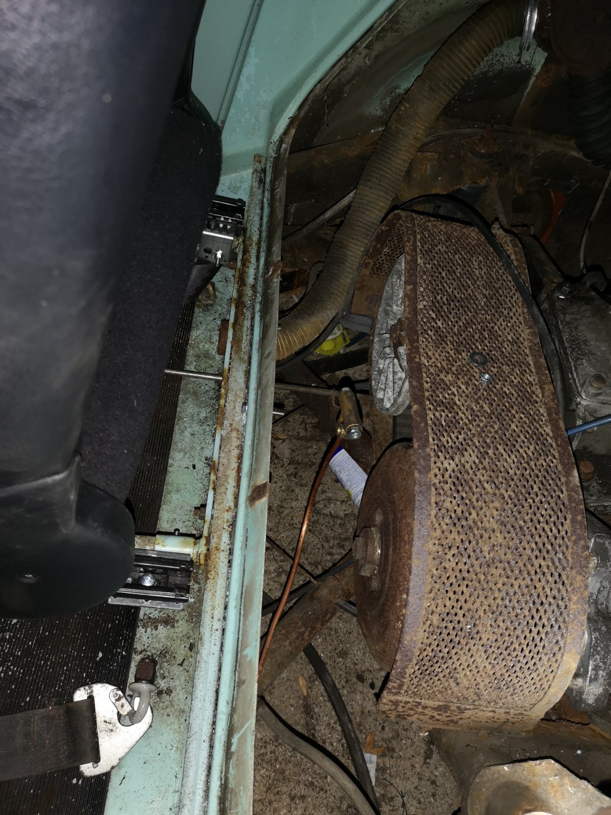

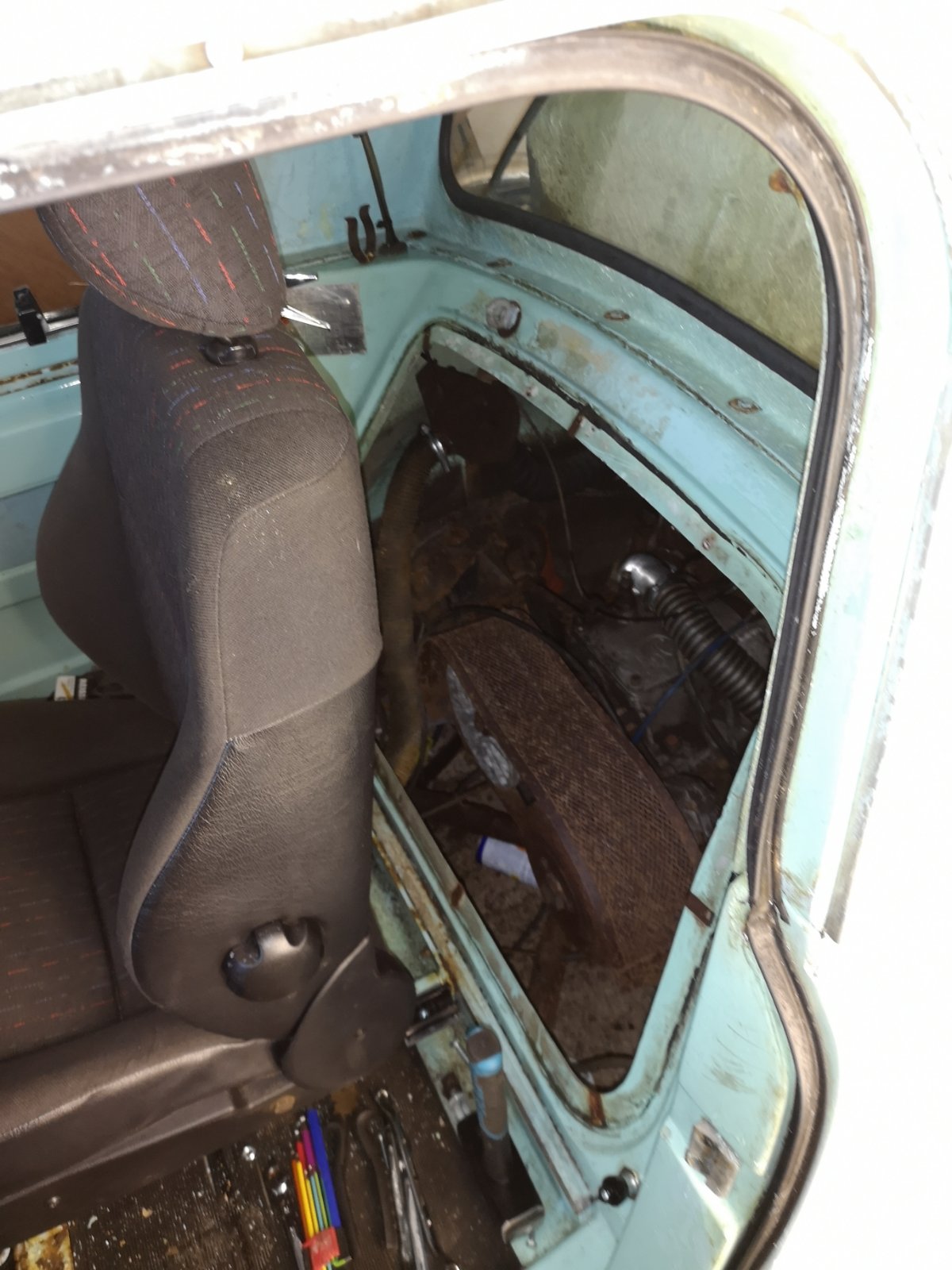

Here's where we ended up.
Doesn't look that different to things before does it? At a glance, no.

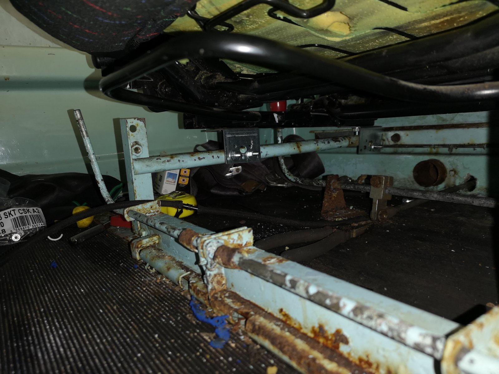

Here's the "before" shot in case you were wondering....

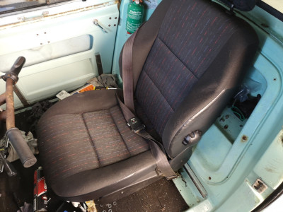

There's been a hell of a lot of planning, measuring, calculating and such involved to get to that point.
Originally I just had four huge U-bolts wrapped around the entire rails of the Xantia seat clamping it to the original seat's frame.
Now we've got an M8 bolt on each corner down through the original Xantia mounting points into the angle brackets you saw yesterday - which are then bolted to the original seat frame.
The rear ones are currently bolted through the original seat clamp onto the frame (hence there only being one bolt per side at present), whereas the front have had a pair of bolts through the seat frame.
I think given things have lined up in such a way to allow for it I'll probably drill a hole and add an additional bolt at the rear tomorrow.
They're lined up in such a way to help centralise the seat (the rails are offset to one side by an inch or so), and it seems to have worked.
Driving position now feels perfectly central rather than noticeably offset to the left as used to be the case.
There are some big additional features compared to the original seat "bodge" that I had in here though. All of the original adjustments available are now fully functional (as is the original left/right sliding setup from the original Invacar seat) - which allows an additional party trick...
Yep, with the seat slid fully forward and the backrest tilted forwards, it's possible to get the rear access cover in and out without removing the seat.

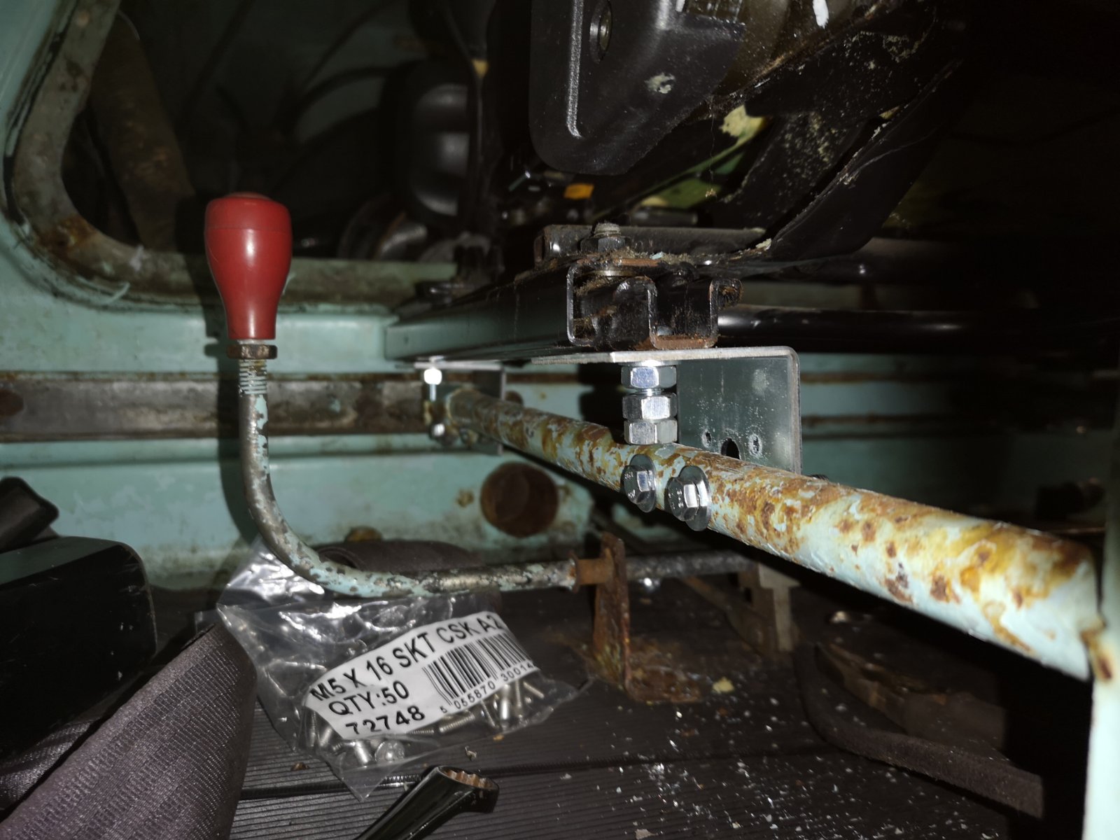

I did have one "oops" moment however when I realised that I couldn't get at the head of the big M8 bolt that I'd used to secure the seat down onto the brackets (which has a slot to allow me to fine tune the left/right position) to tighten them up.
Cue me getting inventive.
Take two nuts, screw onto the end of the threaded section and make a lock nut - then used that to stop the bolt rotating while tightening the nut holding the seat down up. Job done.
I was worried that it was going to be too flimsy a solution, but it seems to be perfectly fine. It's worth mentioning that the whole lot it depending on a few tiny screws and a pair of nylon rollers in a runner at the back to hold that side to the car anyway! So I get the feeling that this is probably over-engineered if anything...It's stood up perfectly fine to me (literally) jumping into the seat without moving a millimetre. Seatbelt isn't secured to the seat like on many modern cars - it's secured to the bulkhead at the top and to eye bolts secured to the chassis crossmember at the floor level. So the seat is purely something that you're sitting on, it's not involved in actually holding you in place.
Having a proper adjustable seat means I can get into a much more comfortable feeling driving position with my feet braced against the bulkhead, so I think this is a good result overall.
I'm somewhat amused at how close a colour match I seem to have randomly found in Halfords...
No that's not the "finish" I'm going for - that was purely a "let's see the colour" test. I need to trim the bottom of the panel back as well.
Speaking of paint - I'll be giving the brackets and such I've just added to the seat frame a coat of blue paint as well so they'll hopefully blend in with the original metalwork better.
Feels like a reasonable couple of hours work this evening and a decent step towards roadworthiness, see also the "stuff I orginally bodged together but need to do properly before she hits the road" list.

It's surprising how well the seat seems to fit in the cabin, I was expecting it to look comically oversized compared to the tiny hospital bench which used to be in there.

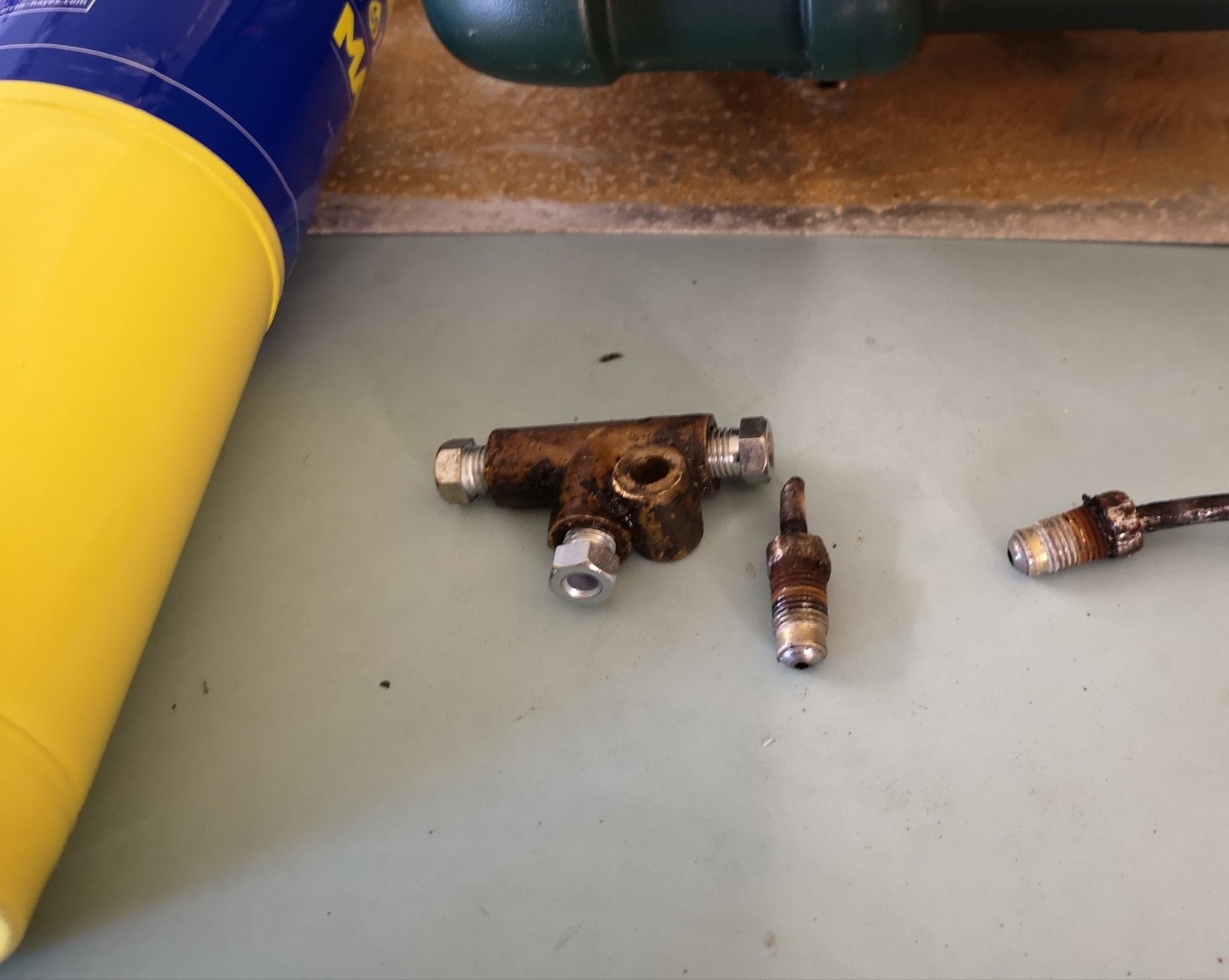

Step 1.
Spend the best part of an hour crawling around on the floor attempting (and eventually suceeding) in extricating this.
Two factors made this a pain. Firstly the fact that the T-piece (the bit I needed to reuse) was positioned directly above the handbrake linkage. This made getting at it difficult. Secondly was the fact that as with everything on this car it was held on with a bolt and non-captive nut. The other end of which I couldn't really get at with anything. Eventually though I managed to mangle the bracket enough to get a spanner onto it and got it undone.
Step 2.
Spend another hour wrestling the two remaining brake pipes out of it.
They *really* didn't want to come out - however eventually a combination of brute force and the MAPP Gas torch of persuasion were victorious.
Thankfully the threads all seem to be absolutely fine, so the T-piece with a fresh set of unions is ready to be used again.
Step 3.

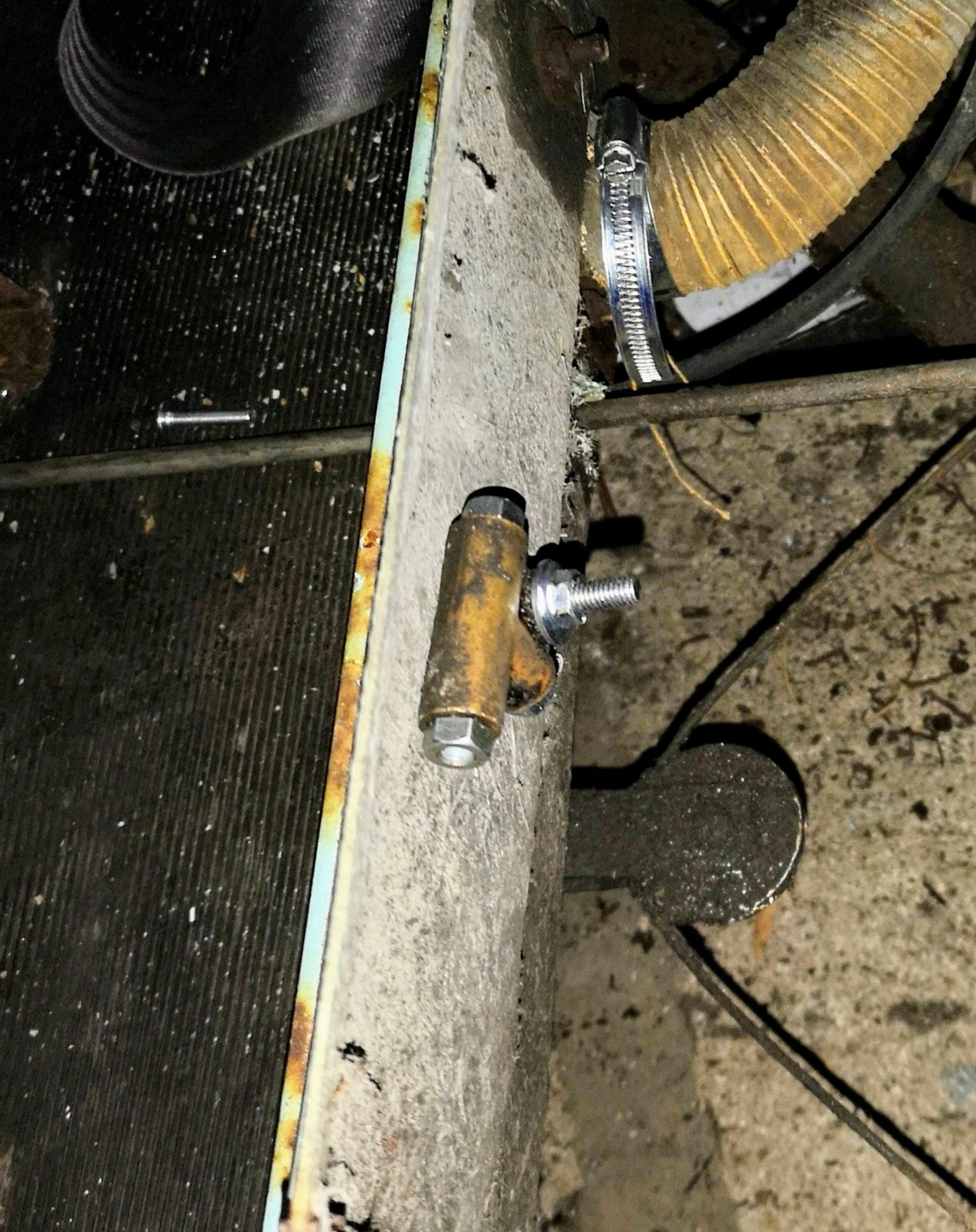

Apply some forward thinking to the siting of the T-piece.
I'd already played getting new pipes onto that thing once on KP. Getting them off TP was equally as much of a royal pain. The way the brake pipes were all tucked up into the chassis made it tricky to carry out a visual inspection of them unless you were up on a ramp as well.

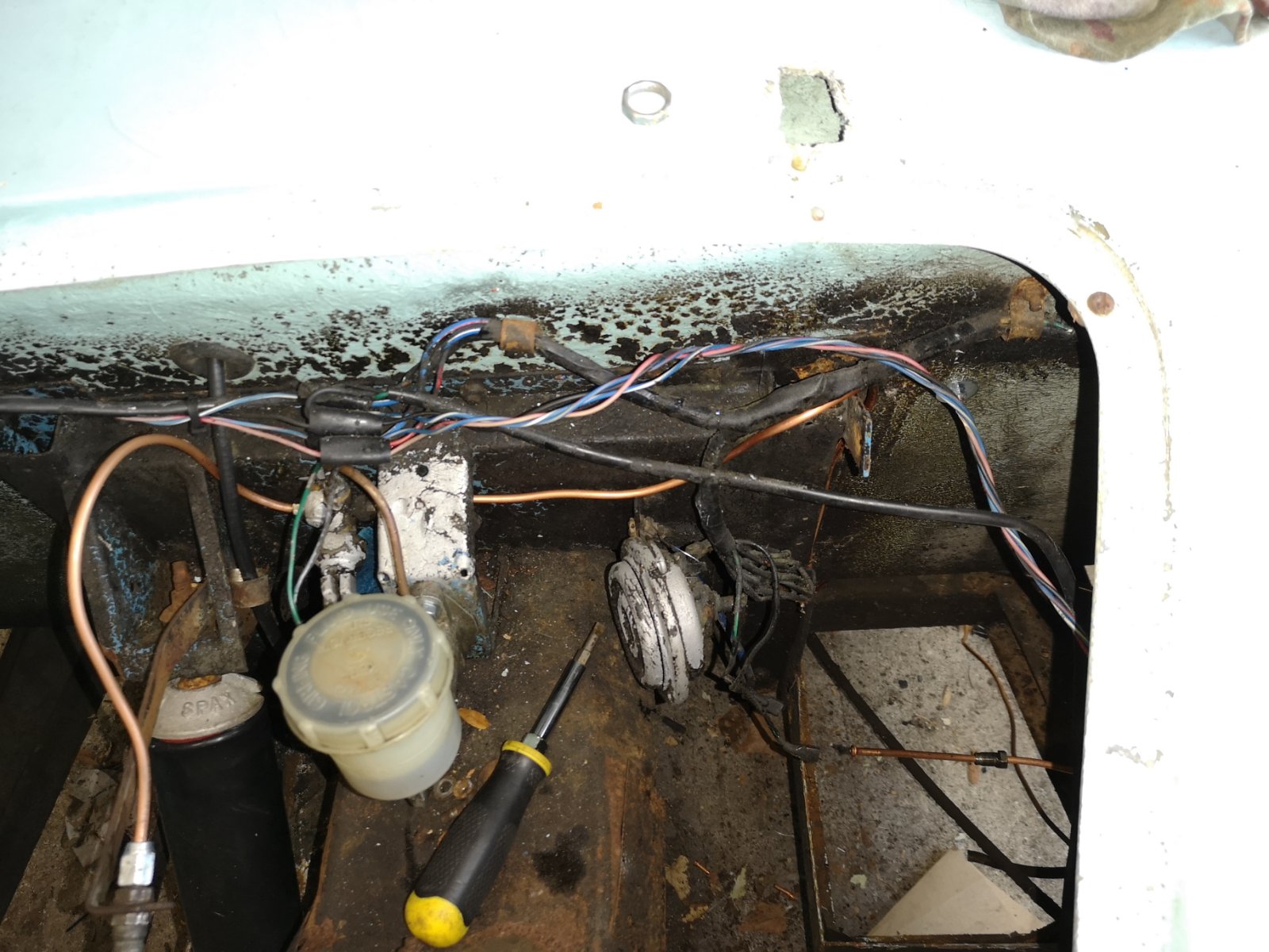

As such, I decided to move things a bit. The T-piece is now attached to the bodywork just below the service hatch, and the lines will run along there before heading off to the flexis going to the rear wheels. I'll install some P-clips along there to keep them in place (the original pipes just seem to by and large rely on luck from keeping them in place and preventing them rubbing through on stuff).
This will make future inspection and maintenance easier (as the whole of the brake piping setup from the T-piece to the wheels will then be visible with the service hatch open), and should keep stuff further away from road grime under the car hopefully.
It also means that I can do the actual connection of the brake lines to there while sitting in the car rather than contorted into horrifically uncomfortable positions underneath the car. Surely that's got to improve my chances at doing a decent job of it. The body of the T-piece will be secured in place while the unions are done up of course - I won't be applying all that torque to the tiny area of fibreglass it's currently bolted to.
I'm definitely not discounting the idea of at some point converting the braking system on this car to a dual circuit setup, so anything I can do to make it more user friendly in future has to be a good thing I reckon.
With a bit of luck tomorrow I should be able to get the actual lines connected up to this and we should be pretty close to being in business. At least I have a stock of unions in the garage now, so if I mangle the odd one here or there it's no big deal.

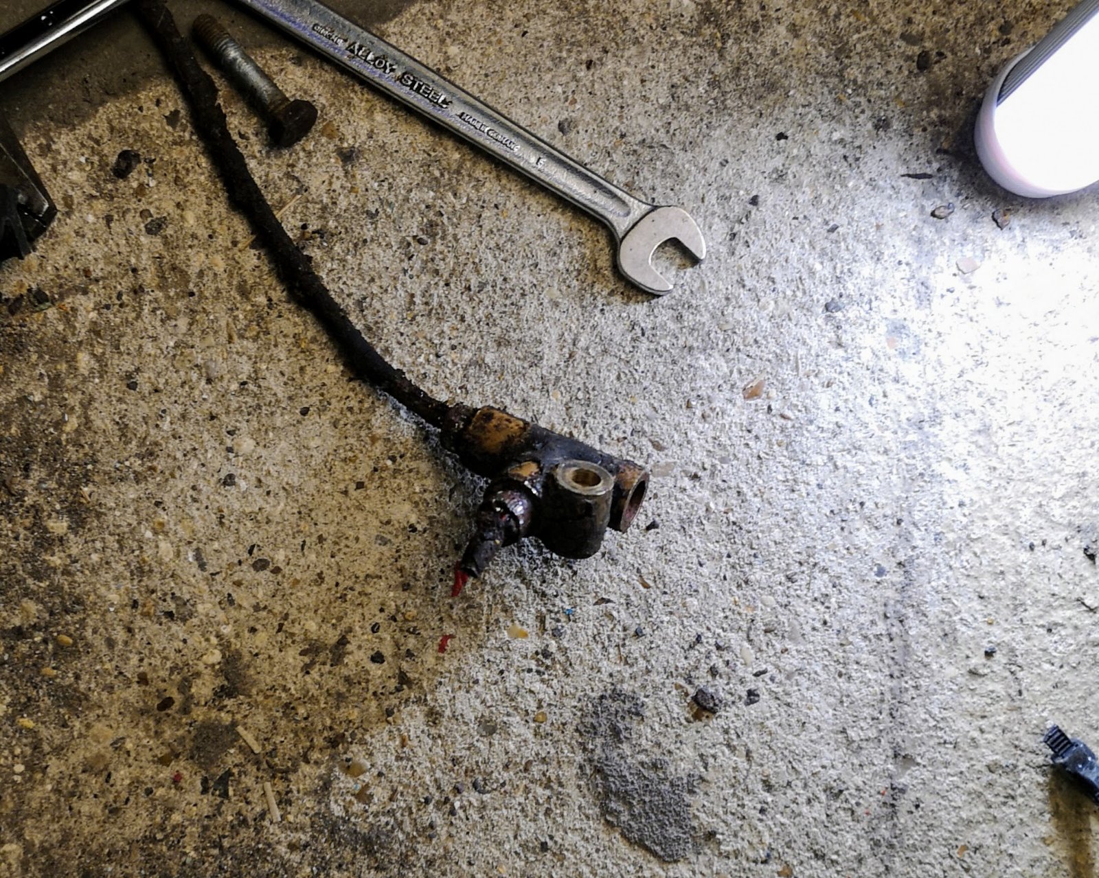

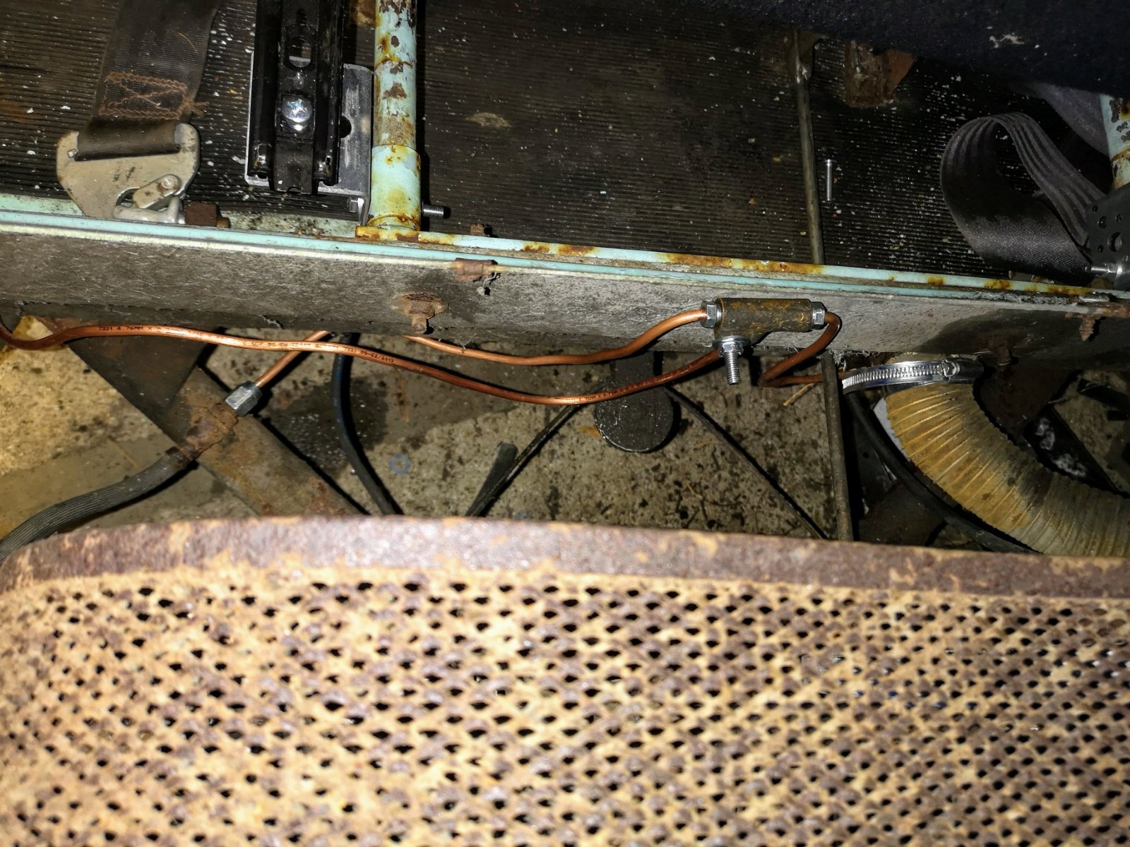

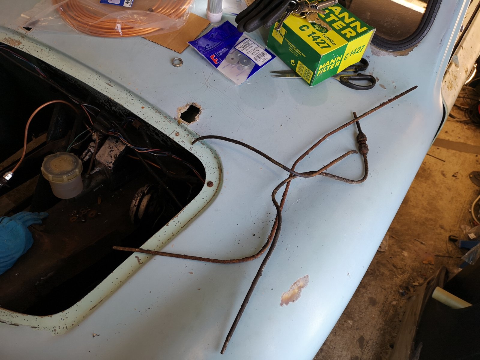

Here are the crusty remains of the front to rear brake line.
This had been disconnected since quite soon after I got the car, but was only actually removed today. I'll save the in-line connector before binning the pipe as those connectors are actually nice quality ones so worth keeping.
New front to rear line is now in place (the temporary one I'd had just dangling under the car is visible to the right) and connected up at the front...
...and is just waiting for the axle connections at the rear.
Goes without saying that there will be a bunch of grommets, clips and bits of rubber sheathing installed to make sure it can't rub through on anything as this car has no shortage of rough edges.
Had hoped to get the whole lot piped up this evening so a bit irked I had to stop there as I quite enjoy this bit where it feels like you're actually getting somewhere.
While I was under there I doused the handbrake mechanism in penetrating oil and had a look at the chassis in general. No idea what they rust proofed these old crates with from new, but it's bloody effective! Forgot to get any photos but will correct that soon.

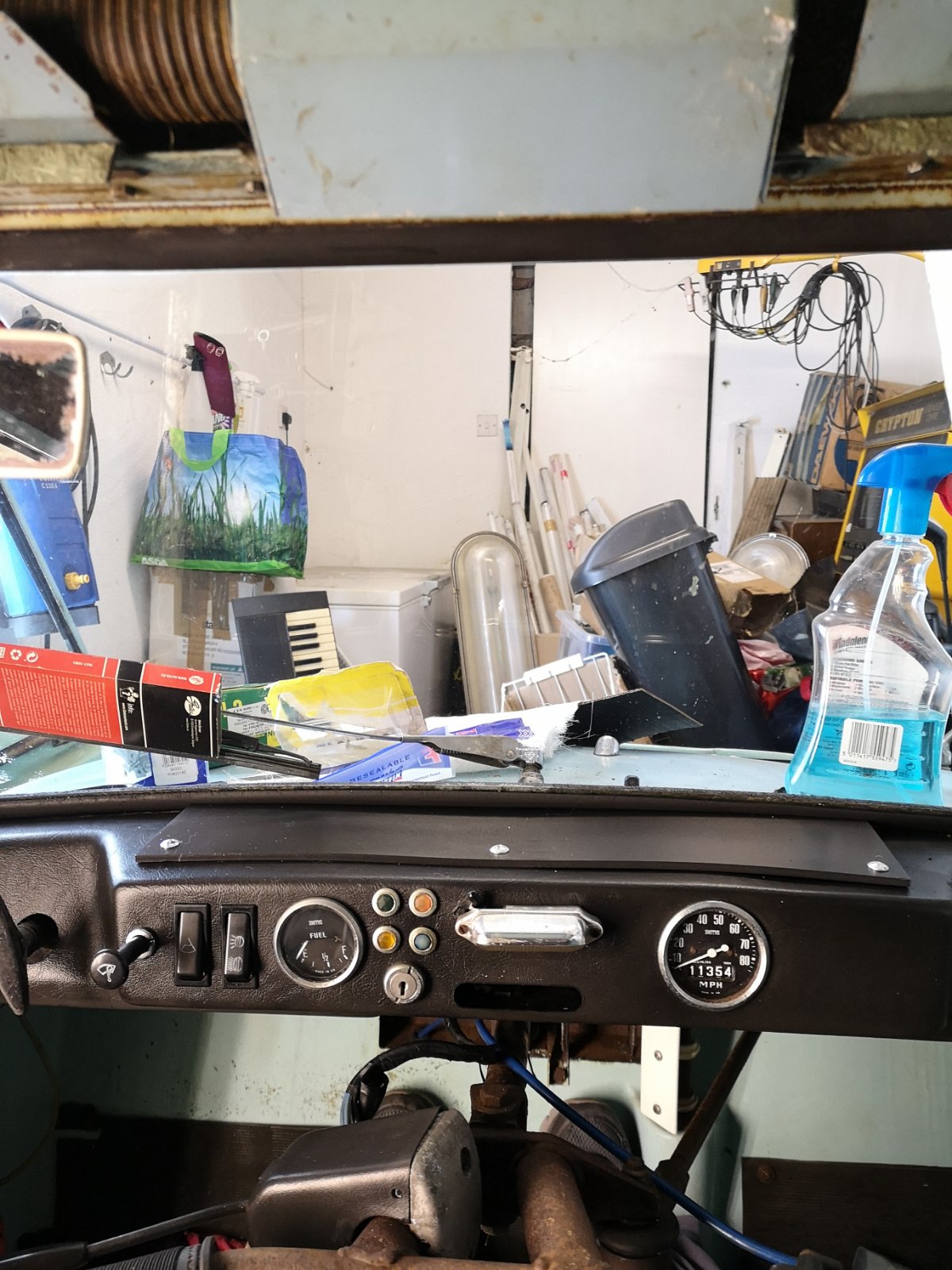

Isn't working on cars such a glamorous passtime?
Having a completely flat floor without pedals in the way does make it slightly easier to do stuff like this, and in fact it wasn't even that uncomfortable once I was folded into that corner.
Getting back *out* of that corner on the other hand, that was a process which I will simply describe as "inelegant."

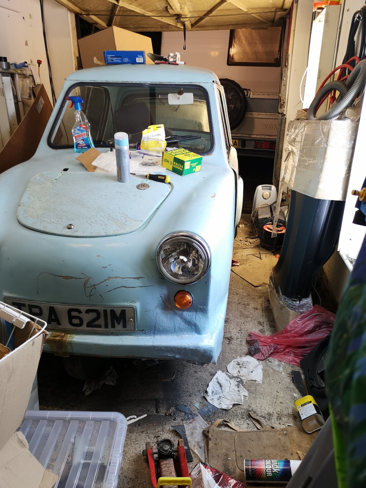

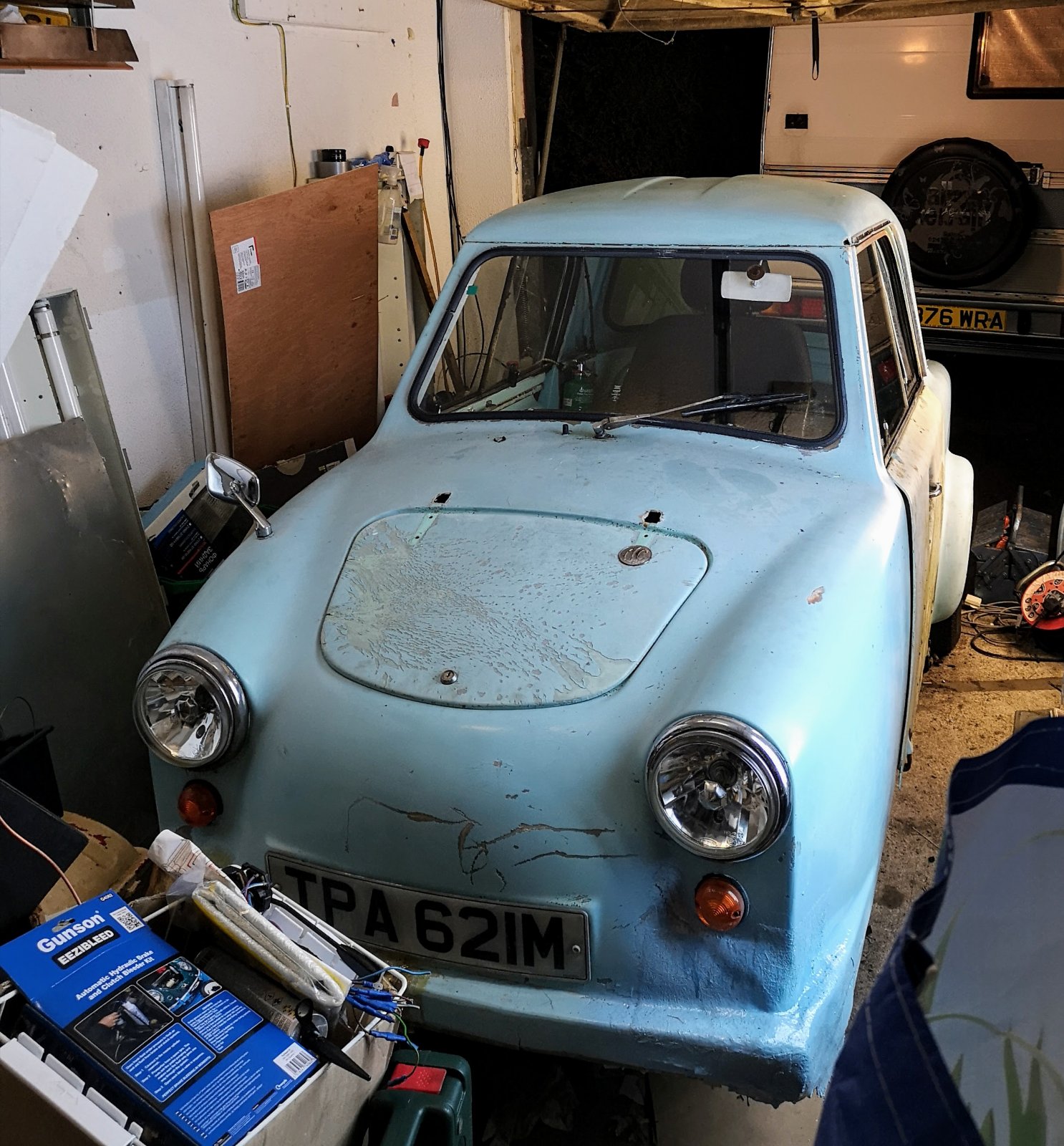

As hoped, I managed to get a couple of hours this afternoon to attack the to do list.
Getting the rear brakes actually connected up was of course the first order of business given how close to done that job was before.
Just need to fit a couple of clips to keep the pipes from rubbing against things.
Oh - and get the flexis changed. Though the rubber is actually in pretty good shape, I've tortured them pretty well and there's no real perishing to speak of and they've stood up quite happily to me literally hanging my entire weight on the handlebars without any bulging or anything. They'll still be changed as a matter of course - but I'm happy enough for that to be after the first test runs. The front one has been replaced already with a NOS part I got with KP.
At this point I figured I'd save myself some time by grabbing an Easibleed. I want to change the fluid in the van soon and that's going to be quite tedious the old fashioned way and they're hardly expensive.
...However they do not come with an adaptor in the box to fit the old Girling master cylinder. The largest one in the box is a good 1/2" too small. D'oh!
Fine, back to doing things the old fashioned way. The piping runs being pretty short at least mean that it doesn't take long to bleed the fluid through. Even if the offside one had to be done from the union onto the wheel cylinder as the bleed nipple on that side still isn't interested in moving.
All done and I have what feels like a reasonable "pedal" - there's still more free play than I'd like, though as I've mentioned already the handbrake mech needs freeing up - and I've not adjusted anything. Not faffing around trying to do that inside the garage where I've no room to move.
Time for some moving tests though...so let's clear the car of the accumulated junk (again), button the rear access panel back up and shift the van so I've got a bit of room to play with.
Took a surprising amount of time to empty this tiny space again...
I managed to ascertain that I do have brakes. Didn't have time to really ascertain much beyond that as the smell of petrol started to become obviously not just that from the open can out the back, but was Far More than I should be smelling...Immedialy obvious when I stopped the engine was the "Tssssshhh...Tsssssh..." of something dripping and evapourating from something hot.
That would be petrol dripping out of the fuel pump, onto the tinware and then straght onto the offside exhaust branch. Rather unnerving!
That hose was weeping about a week ago and I trimmed the last inch or so off the end of it - today though it's escaping from around the access cover on the top of the pump itself. Grrrr...Easy enough to sort at least, and I spotted it *before* the car had a chance to set fire to itself!
Will get that sorted out (I wanted to give the screen in the pump another clean anyway so not all bad) tomorrow and then give the brakes a bit more exercise on the driveway. Next up will probably be either swapping out the indicator switch to one that works more reliably or fashioning a heat shield of some sort to cover the exhaust until I can summon the willpower to fully rebuild the rear apron.
She's pretty much unburied though which is pretty rare these days!
