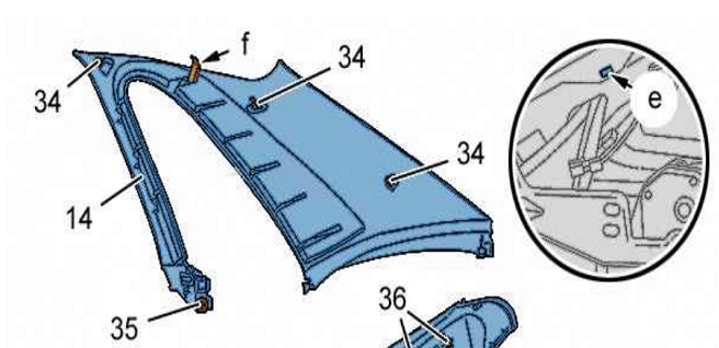

Thanks Marc, but how do I remove that trim?
- x 6954
Re: My turn for a C5!
Standard trim removal tools James - this is all I have:
Check the presence of the plastic clip ( 35) and of the metal clips (34) on the quarter panel trim (14).
When clipping in the quarter panel trim ( 14) ensure that the plastic lug "f" enters the hole "e" in the quarter panel inner panel.
OnlineHell Razor5543
- Posts: 14285
- x 3295
Thanks Marc, a friend of mine who works on cars (a LOT more than I do) has the tools, and has said he will help. These images should help.
