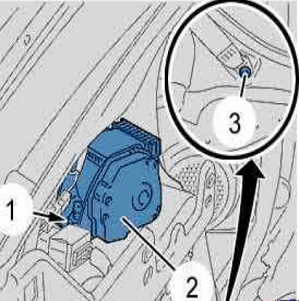

Can anybody explain how to remove the rear trim to allow me to replace the nearside rear safety belt reel? We had my Mums' new dog in the back, and while I was away he got his harness tangled up and panicked. Trying to get free he bit the safety belt hard in two places, and he has SHARP teeth. This belt is now an MoT failure.
Thanks.
Thanks.
- x 6945
Re: My turn for a C5!
You need to take off the rear parcel shelf, then the rear quarterlight window surround.
When Refitting
Proceed in the reverse order to removal.
Tightening torque:
bolts (3) : 3.5 ± 0.7 daNm
(1) nut : 3.5 ± 0.7 daNm
| Remove bolt (3) The nut (1) Then remove Remove the seat belt and the inertia reel ( 2). |
