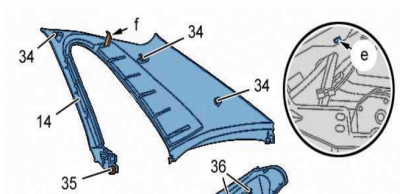

Can anybody explain how to remove the rear trim to allow me to replace the nearside rear safety belt reel? We had my Mums' new dog in the back, and while I was away he got his harness tangled up and panicked. Trying to get free he bit the safety belt hard in two places, and he has SHARP teeth. This belt is now an MoT failure.

You need to take off the rear parcel shelf, then the rear quarterlight window surround.

Thanks Marc, but how do I remove that trim?

Standard trim removal tools James - this is all I have:
Check the presence of the plastic clip ( 35) and of the metal clips (34) on the quarter panel trim (14).
When clipping in the quarter panel trim ( 14) ensure that the plastic lug "f" enters the hole "e" in the quarter panel inner panel.
