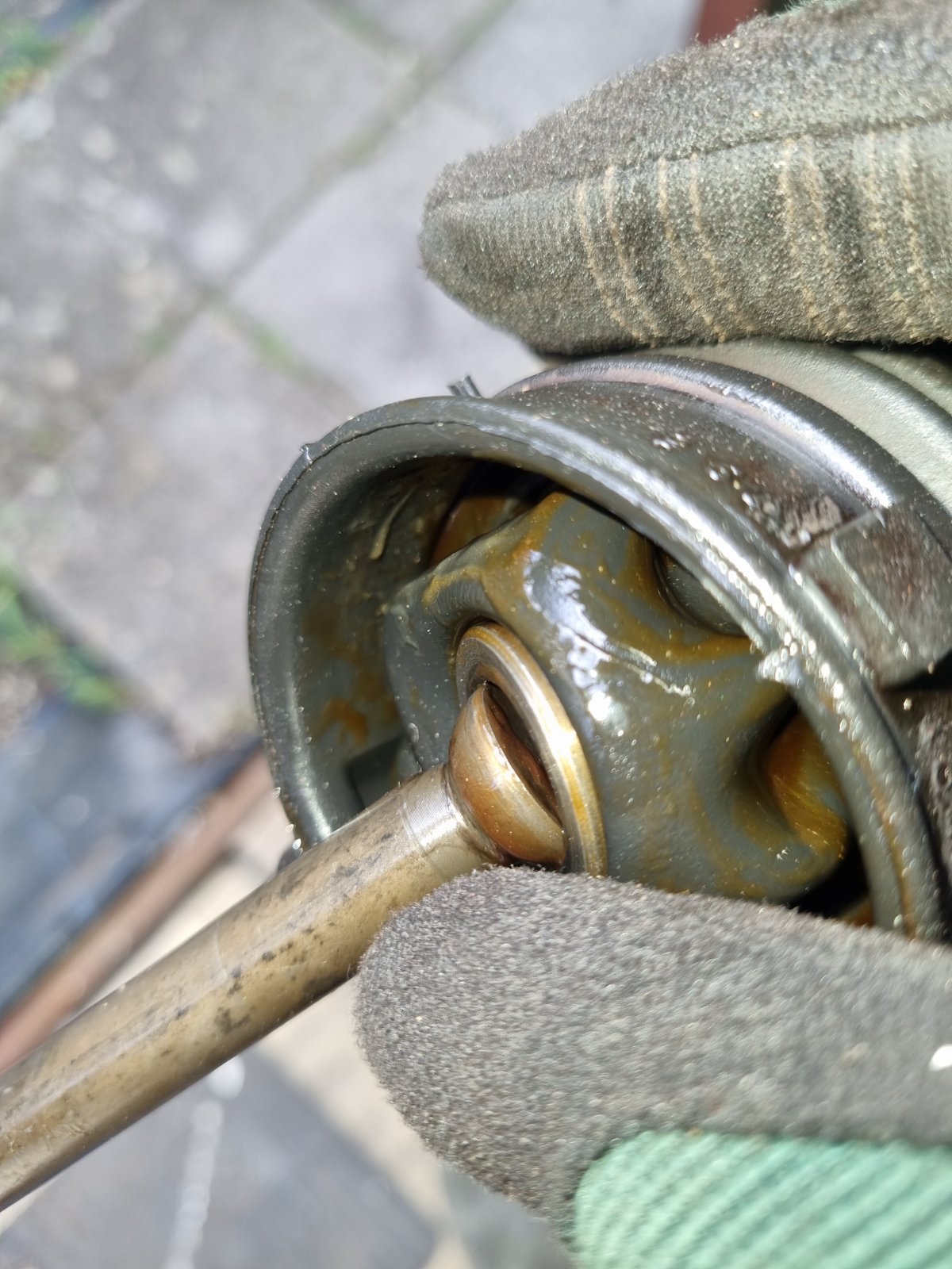

Think i've found it
Can these be repaired, i remember someone mentioned a circlip.
The ram is a tight fit.

gave the rod a clean
