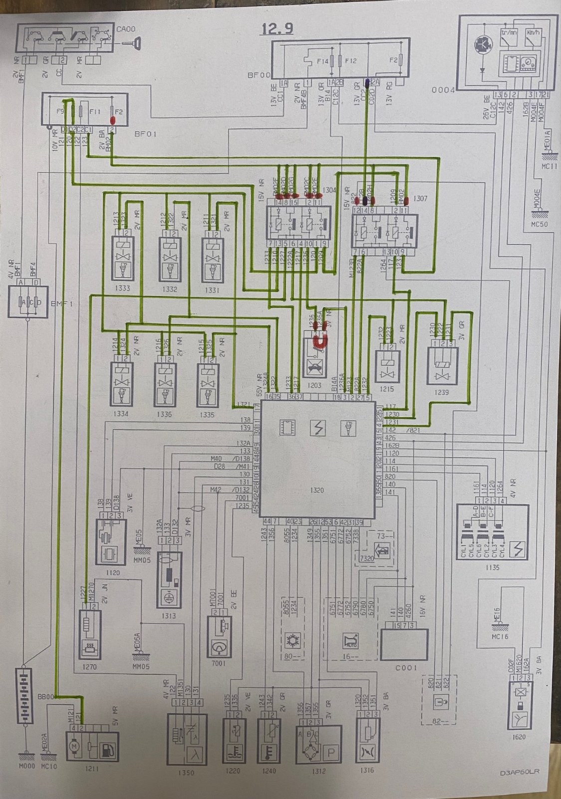

I started by checking continuity of as many cables as I could. Annoyingly the one I thought was broken (checked cable 120 from pin 1 to Fuse 9 on under bonnet fuse box (this does not have continuity so must be broken!)) was not broken I must have been on the wrong pin on the multi plug under the drivers side wing.
I have attached an image of the wiring diagram and coloured all the cables i have checked continuity with green pen.
I have marked where I was getting 12V with battery connected in red and one point between inside car fusebox and pin 14 on relay 1307 when ignition turned to position 2 in purple.
Also I wanted to rule out 1203 (which is the red inertia fuel cut-off switch) I was getting 12V at it so fitted a cable between pins to try and get 12V at pin 10 on relay 1304.
So Can you tell me if I an correct in saying the following:
I need 12V from ECU pin 3 through the inertia fuel cut-off switch to pin 10 on relay 1304, This will then give 12V at pin 1 and 9, supplying under bonnet Fuse 9 for the fuel pump. As well as pin 2 on relay 1307 but also 12V from pin 51 on the ECU to pin 10 on relay 1307 thus supplying pin 9 and giving 12V at under bonnet Fuse 11.
How do I know the ECU is getting power and sending it back out?
Why am I not getting 12V at pin 10 on relay 1304 even with the inertia fuel cut-off switch looped out?
Help very much appreciated.
Owen

How are you testing continuity of the wires? Reading with a multimeter is not always accurate with a corroded wire, as it may show a low resistance, or correct voltage with no load but still not pass any current with a load applied. You need to check for voltage drop across the cable when it is carrying a load.
I think you need to take a step back and determine which voltages are present or absent at the relevant pins on the ECU and relays, I have become a bit confused.

Ok,
Yes just using a multimeter for continuity.
So next time I am back I can pass 12V down each cable and see what comes out the other end and let you know values for relevant pins?
Thanks
Owen
Thanks
Owen

For the power wires, you should apply a load, such as a 20W light bulb. It also give a visible test result.

A good way to look for loose and dry joints in the power distribution chain is using a filament bulb, say an 18 or 21 watt. Connect one side to ground, the other to a probe and to a meter on volts, and touch this along the supply path to be checked. Obviously look for low volts as you go. Don`t probe sensors, processors and so on, but the method is fairly safe.

Thank you for the info, I'll let you know the outcome
