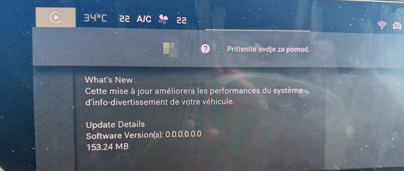

Update:
Today, a new update notification appeared. Unfortunately, it failed again at 5%—it was an update of around 155 MB, which I believe is the same one that originally failed the first time. After I reported the issue back then, the manufacturer pushed a smaller 5 MB update, which installed successfully.
I’ve once again sent the relevant information about this failed update to the importer’s after-sales team, and I hope they will resume the previous ticket with the manufacturer tomorrow.

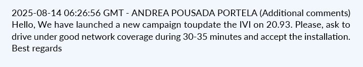

Re: C5x Firmware version
Update – Major Firmware Upgrade Installed
After some back-and-forth with the importer because of the 153mb failed update, and then 0.04mb and 0.02mb failed update, they opened a new ticket with the manufacturer. In response, the manufacturer pushed the 20.93 update, which then triggered the appearance of a 1.23 GB update. This finally delivered the long-awaited firmware upgrade.

However, after the major firmware update, a 153 MB update appeared again and failed once more. I’ll be opening another ticket with the importer on Monday to address this recurring issue.
