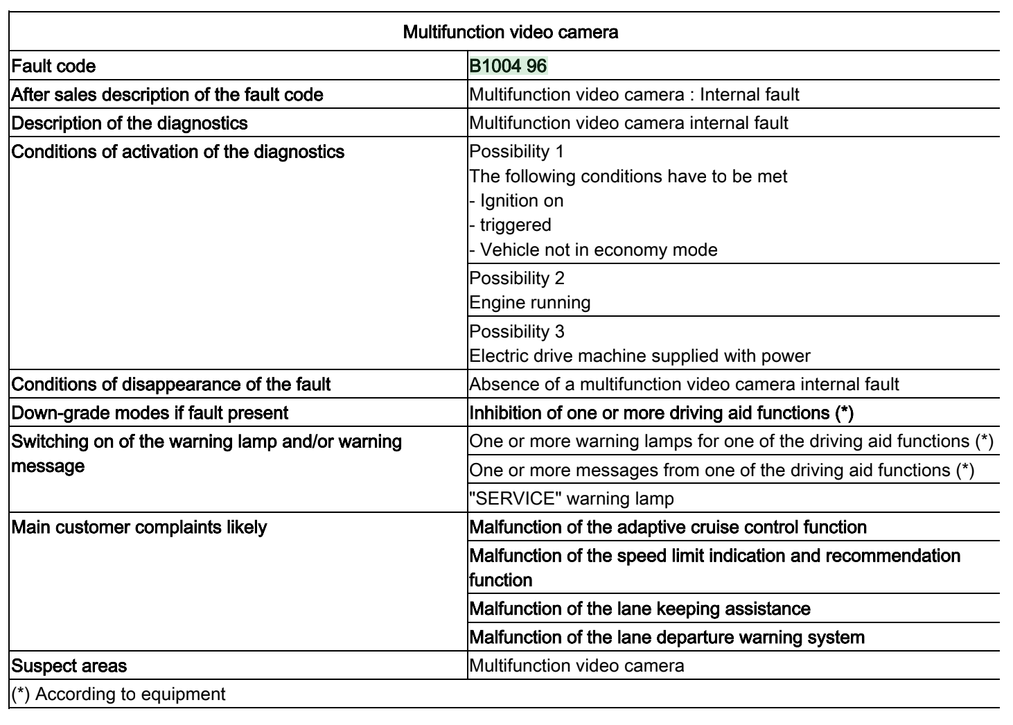

trollkarlen wrote: 31 Jul 2024, 18:43 I got the real codes but my diagbox was too old so it could not decode it 9.68 😔
Could someone assist?
ECU
P105904
P16AB07
EAT8
P140605
P17E049
Parking assistance
U1F0000
B124497
B125192
ADAS
B1004 96
U1F00 00
BSI
B120D 86
B120A ?? Warning collision, permanent
Service module
8D93
Which version of diagbox for at least 2020 models?
The main issue now is the collision detect and lane assist warnings.
Found some info on error codes:
ECU
P1059 04 - Ancillaries battery 2 switch : Fault not clear
P16AB 07 - Ancillary drive belt : Mechanic malfunction(This is set when not changed after a certain distance 6000km?)
EAT8
U1406 05 - CAN Flexray : Internal fault
P17E0 49 - Hybrid automatic gearbox input speed sensor signal : Internal electronics fault
Parking assistance
U1F00 00 - Event not recorded fault
B1244 97 - Rear left lateral parking assistance sensor fault : Obstruction or blocking of operation of the system and / or component
B1251 92 - Front right lateral parking assistance sensor fault : Operation or performance incorrect
ADAS
B1004 96 - Multifunction video camera : Internal fault
U1F00 00 - Fault event not stored in the faults log
BSI
B120A 62 Collision risk alert function fault : Signal coherence fault 6
B120A 68 Collision risk alert function fault : Detection of an impact 7
B120A 86 Collision risk alert function fault : Invalid signal 6
Service module
8D93 - Error in communication between the telematic unit and the independent telematic unit : Not characterised

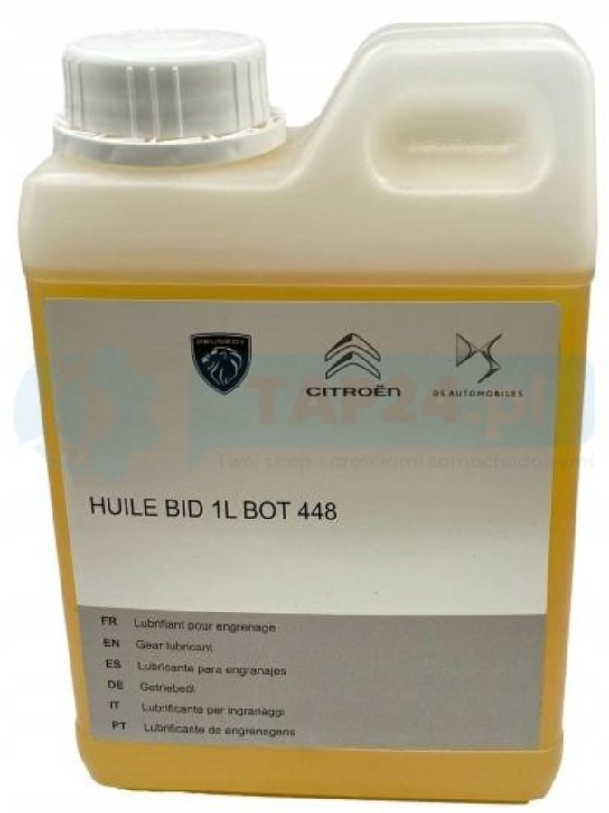

Change oil in the rear reduction gearbox hybrid
The filling and draining hole is on the backside in the above image.
Two plugs with flat head and hex/square socket(Will update when i know the size).
They can be accessed trough a hole in the plate underneath the rear axel reduction gearbox.
The top plug is for filling and the bottom is for draining.
The capacity is 0.5L, dont over fill.
The oil:
The Electric Reduction Gear Oil (2) is BOT 448, part: 1656247880, £51.92 (1 Lt).
reduction gear for hybrid vehicles
All countries
1656247880 BOT448 oil CASTROL Spec SAE 75W80 1 litre container
Original "Huile BID BOT 448"

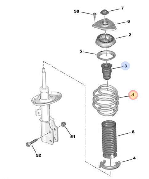

GiveMeABreak wrote: 02 Aug 2024, 23:26 Ok, but just for future reference, please direct all parts requests to the official members parts thread here:
That thread is only for parts requests, not technical queries and ensures that they get prioritised as staff may not pick up requests outside of that thread.
(1) Front Suspension Spring, 1 Purple, + 1 Yellow + 1 Green, part: 9815469280, £148.33
This is correct ?
https://xdelar.se/bildelar/product/KYB/RA1559/
