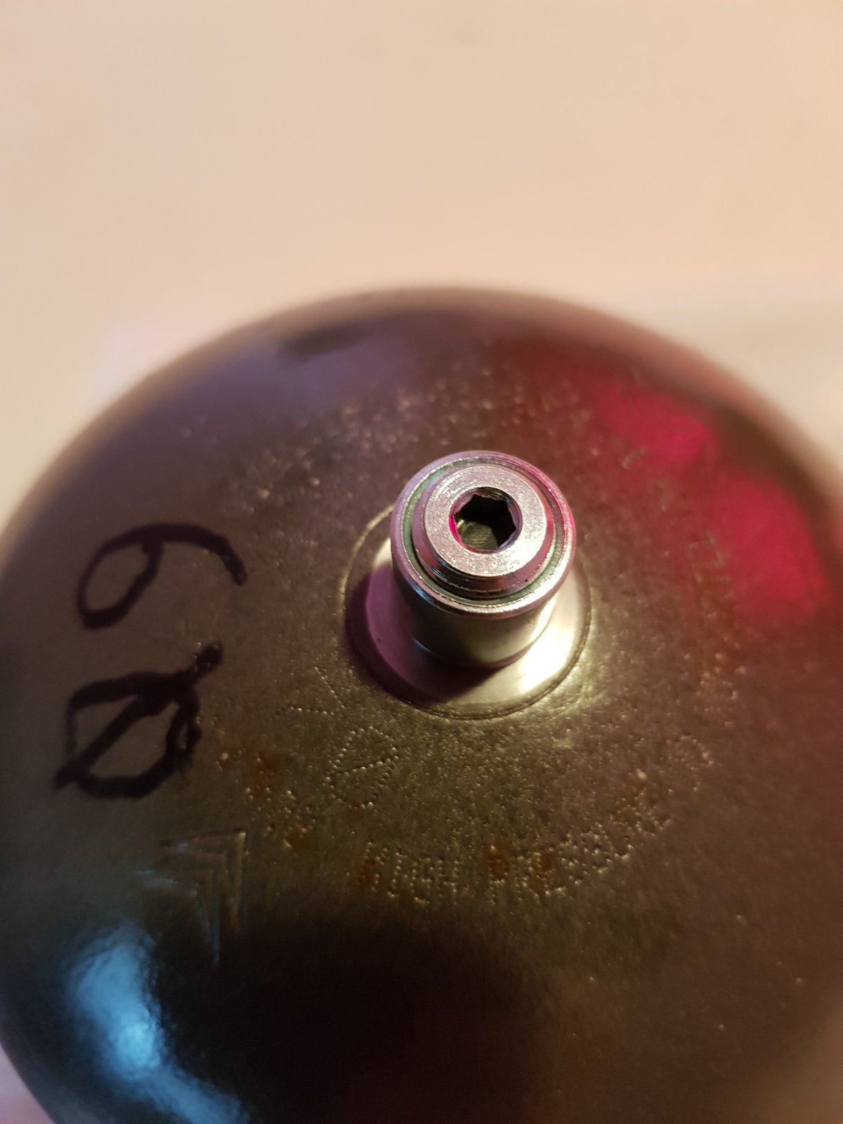

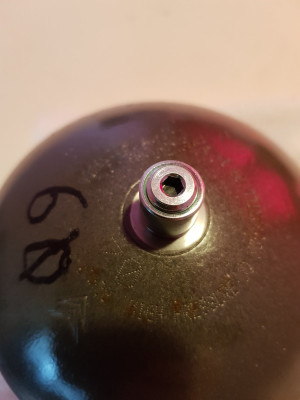

A question, does your mechanic the same valve for regass the sphere as you see on my picture?
Hi!
Yes, it's the same valve as in your picture.
