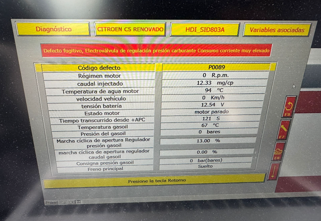

Today I was able to see the error P0088 as well, I don't understand anything, I don't know what is happening, yesterday I filled the fuel tank full, I don't know if it has anything to do with it, it says fugitive engine stopped error P0088.

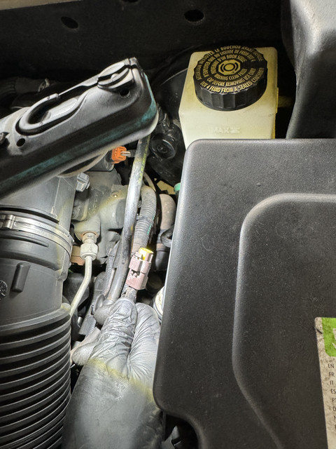

Tomorrow I need to solve all the problems (I have the exhaust temperature sensor) but when trying to mount it I have not found where the connector is, it seems that it goes up somewhere in the engine but I cannot access it or see it.

I also need to check what that error P0089 is, although perhaps it was due to filling the tank to the top with some specific error, since it seems to be a fugitive.

Fault Code: P0089
Description of Fault: Control of the fuel flow regulator : Fuel flow rate regulation valve control current incoherent.

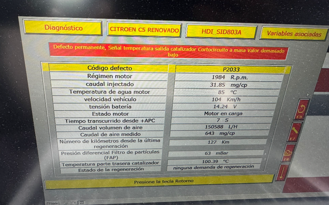

Fault Code: P2033
Description of Fault: Catalytic converter downstream temperature signal: Voltage too low. The voltage of the signal of temperature downstream of the catalytic converter is lower than 200 mV for 31.5 s.

Disaster189
Posts: 72
Joined: 23 Apr 2022, 07:25
x 1
Re: Citroen c5 II height sensor suspension
Unread post by Disaster189 »

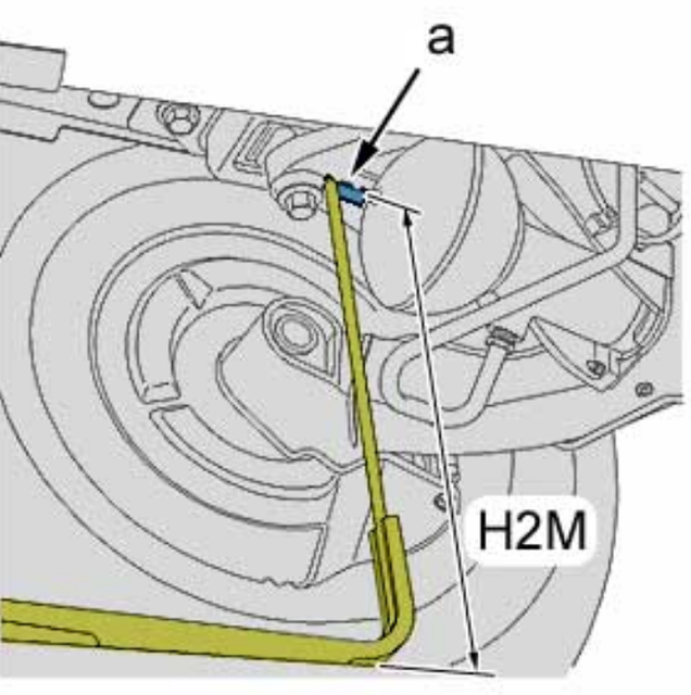

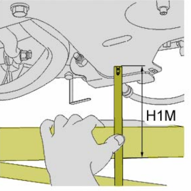

Thank you very much for all the information. I already have a new catalyst temperature sensor, but I was not able to locate where the connector is despite following the cable, it went up and got lost. I have not been able to get good data on the height either (I think the car is very high) I have heights: front from the trapezius to the ground as indicated by cotroen: 16cm rear from the chassis to the ground as indicated by Citroen: 37.8cm my 215-55-16 front radius is 30cm my rear radius 215-55-16 is 31cm

Can the two errors I have be related? Or are they independent? The P0089 says that it is fugitive and is not permanent, maybe it was when I filled the fuel tank or something strange happened briefly.
The catalyst sensor, no matter how much I look at diagrams, I can't find out where the connector really is since I lose track of it. I have seen that in some C5 I it is in the ECU itself, but in this one it seems that is not the case.
I also can't see the correct heights anywhere.

I found the culprit, when they changed the thermostat they did not connect the fap temperature connector!! connected and erased fault. I have also deleted p0089, I hope it doesn't appear again. Now I need to know the correct height (my car measures from the front cradle to the ground 16cm and from the rear chassis to the ground 37.8cm) passenger window I have not been able to solve the problem either
Problem conector sensor temp
Measure car:
16cm
37.8cm
