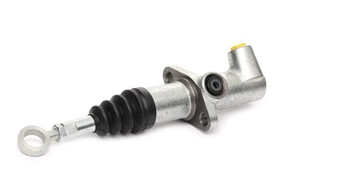

Dont speak to soon ..... it went again this weekend . After flywheel replacement . Its the complete setup of pedal to cylinder and the alignmemt of the part if the plunger is not straight , and i belive not many are , this then over time wears it out . ( or part of a number of other factors all doing there bit to make it fail )

Im at this momemt thinking of maybe trying a cable system old school and forget the hydralic system altogether , if this is there weakness then maybe i need to check the housing postions for a cabke to go to and see if it xould be done , wonder if psa would care ? Cant keep having these plastic parts going on me again ,

I wonder if there is a possibility of having the part copied in aluminium?

Be great if an aluminium one could be made...

Bmw is very very simliar .
This could bolt to the bulk head wall with some metal spacers to strengthen the wall . A bit of fettling with the pipe work , and this is the best bit . A quality part for Citroen 70 quid upwards, this part BMW , £27 ....

https://www.kitcardirect.co.uk/products ... -converter
Seems possible. Apart from the route of a cable , go left dpfmin the way, go right then you need to go round the gearbox ,aling the bulk head then a sharp right toward the way through the bulk head to the clutch pedal area, then find fixing postions for the cable to be ankered to .

As for my findings this evening regarding these master cylinders failing , an ebay seller whom sells the bushes that replace the green type on the car which were known to wear & cause pedal flop ( up down & side 2 side ) hes said hes never known this to cause a master cylinder to fail . But i beg to differ i mean if the rod that clips to the pedal is being pulled off center then surely this can cause the seal to sort of open and let air in after a few hundred miles of gear changes. We will have to see.
