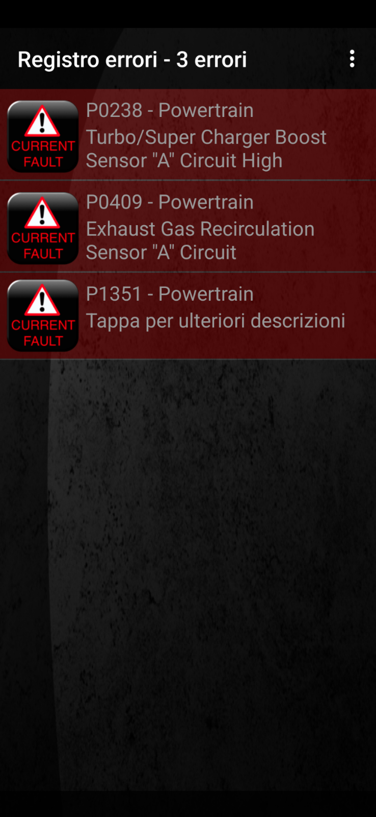

Hello
Today I was able to turn on the engine all works fine except this error code.
Turbo spins and sucks strong from the inlet manifold ..
I didn't see where these sensors are could you direct me?

Hi
Don't know what happened but I disconnected all plugs that I unplugged during this service and also the main ECU connectors.
I used deoxidize spray on every plug and then I set all in order.
After 2 or 3 attempts all error message went away except one that probably has to do with incandescent plugs.
The engine runs smoothly and all seems ok.
I hope to end this too long (for me) job tomorrow.
Thanks everyone
Pietro
