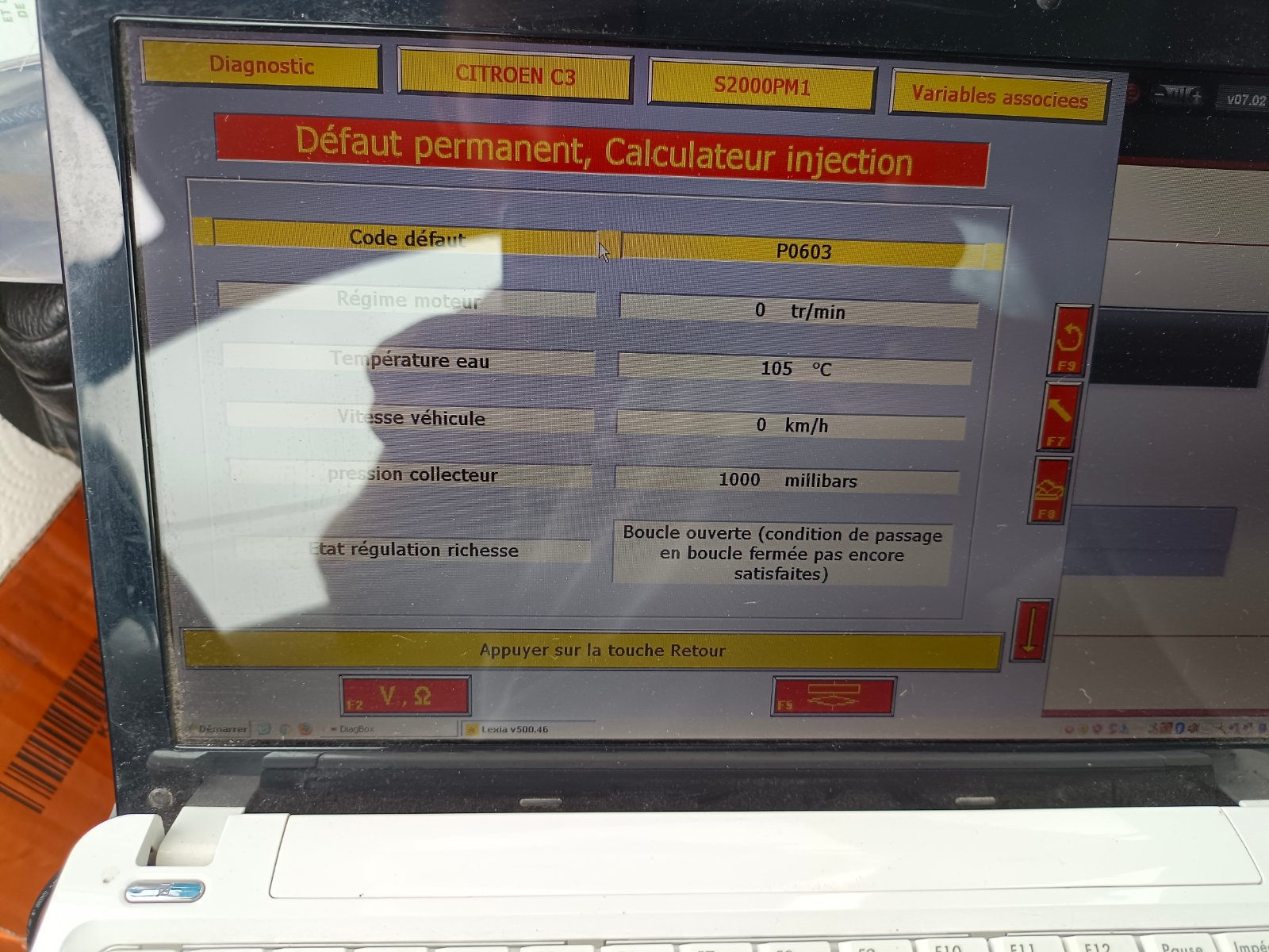

I tried to read again with diagbox 7.02.
I had the same results except that I realized that I could accelerate more than 3000rpm.
I have an error on the acceleration unit and on the computer.
I tried to erase but it says "cut during erasing" I'm afraid of having burnt out my ecu by simply trying to read the engine values
- x 6945
Re: Lexia 3 read s2pm-380 C3 1.4i 8v 2002
Any of the following faults: P0601, P0603, P0604 or P0606 refer to an internal fault of the Injection ECU. That being the case and if you have checked all the pin connections to the injection ECU and the wiring, then you may be looking for a new ECU. There is no further information about these faults apart from an internal fault.
Hi
I disconnected the battery and it's gone again...
Now it is ok
Now it is ok

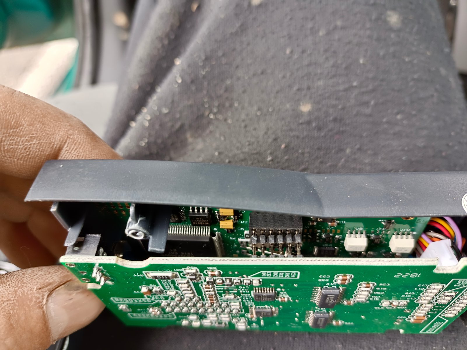

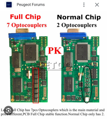

After lot of tests and the fear of having broken my ecu, i put away my lexia and look for another more generic diagnostic tool like cl2000 Can loggers (especially for live data).
then I told myself that would still be interesting to open this tool...
it is not complete (lite version).
Obviously the problem does not come from the software but rather from the tool.

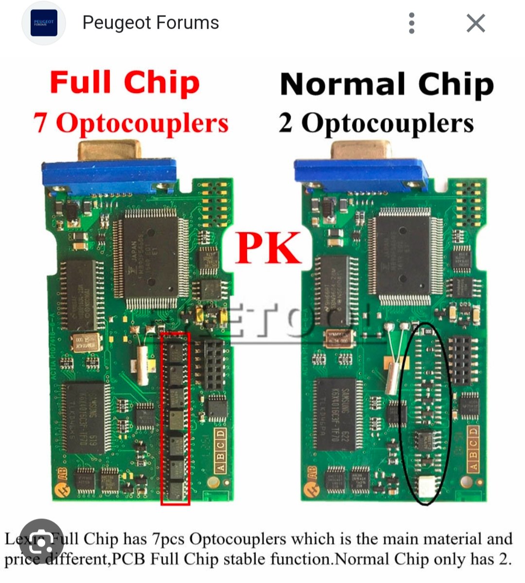

- x 6945
Yes, we know that, the cheaper versions have cut-down hardware and won't work properly with later vehicles.
There are other missing components not shown in the image above in the cheaper versions.
hi!
yes some people have the skills to add the "good" components.
I remain doubtful that a "full chip" improves operation, often the reference to full chip is for modern cars with completely impossible reading.
In my case I read some live values ??(slowly) without being able to save.
the actuator test works and it is apparently normal that my sp2m-380 ecu is read s20000pm1
