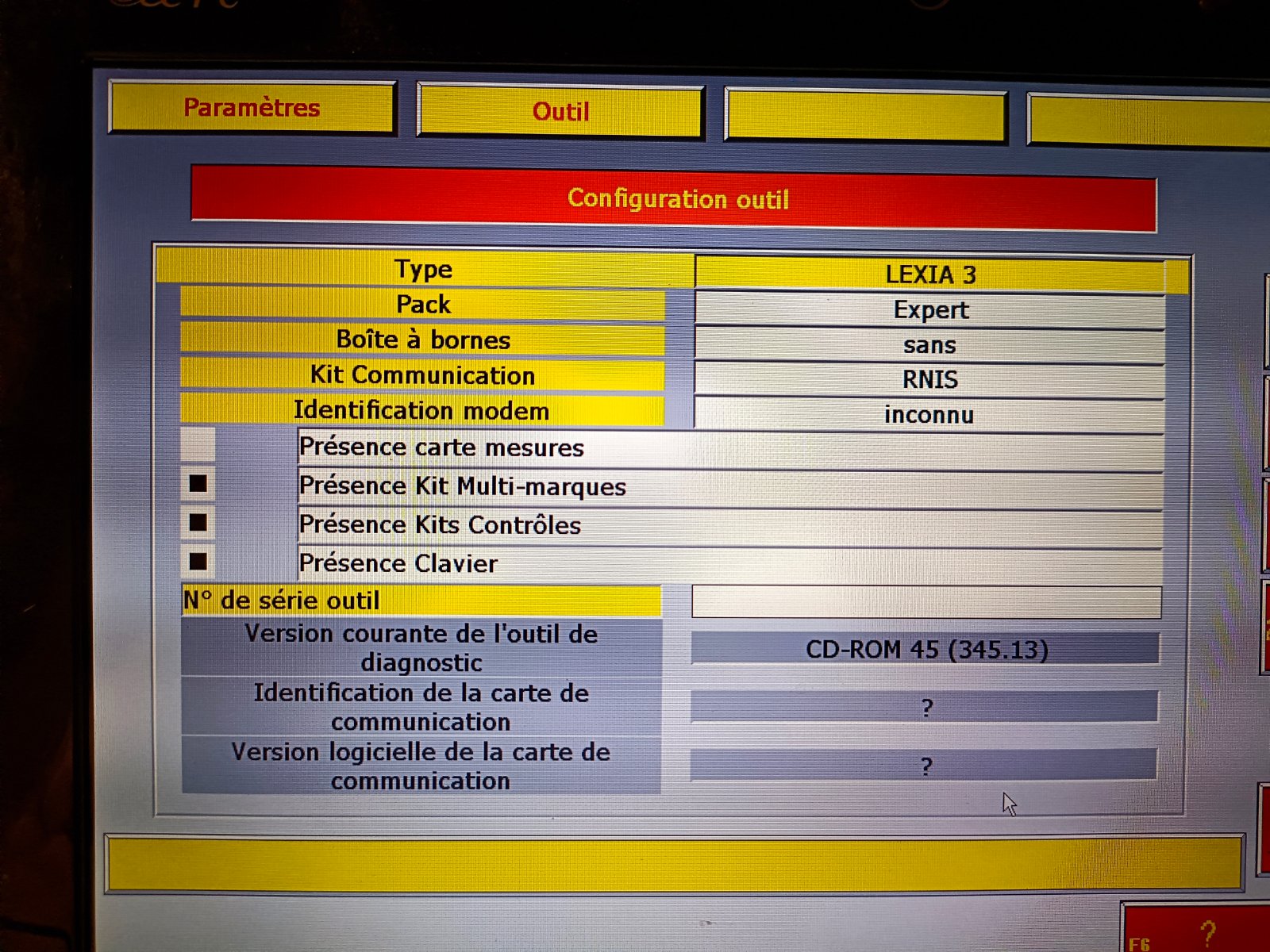

Lexia 3
It is 45 (345.13) CD-ROM before 2007
Thx
Lexia 3
Thx

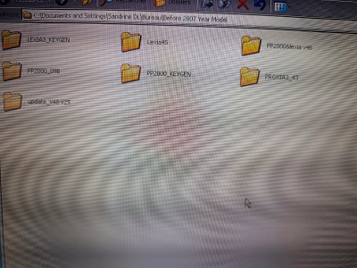

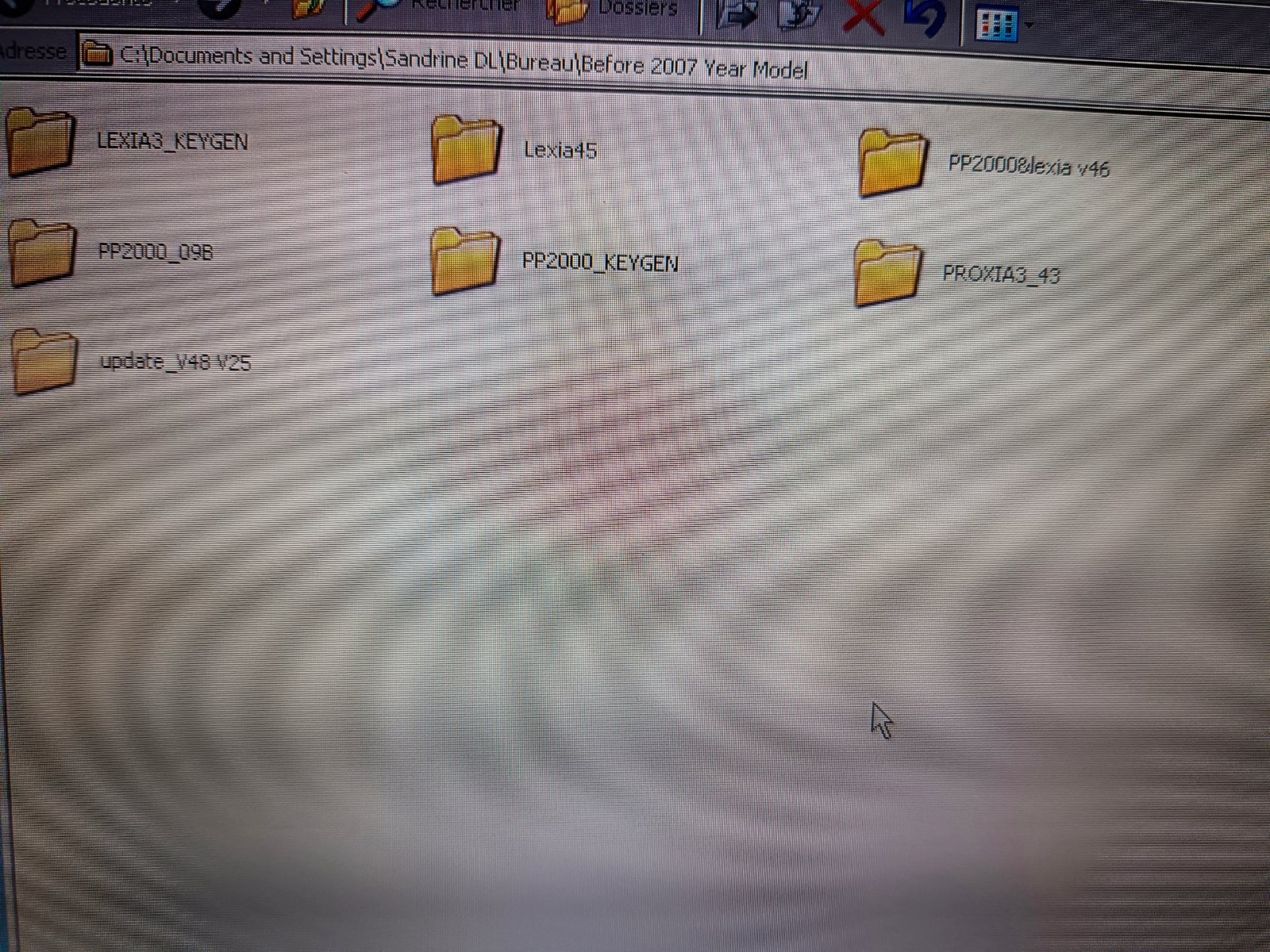

I have access to the software in the image above I will try to restart the installation from zero with each program.
And see if I have any better, did you have s2pm-380 in your list?
(the pack is called "before 2007" and diagnoses the Citroën Ax from 1993)
so theoretically it should work...

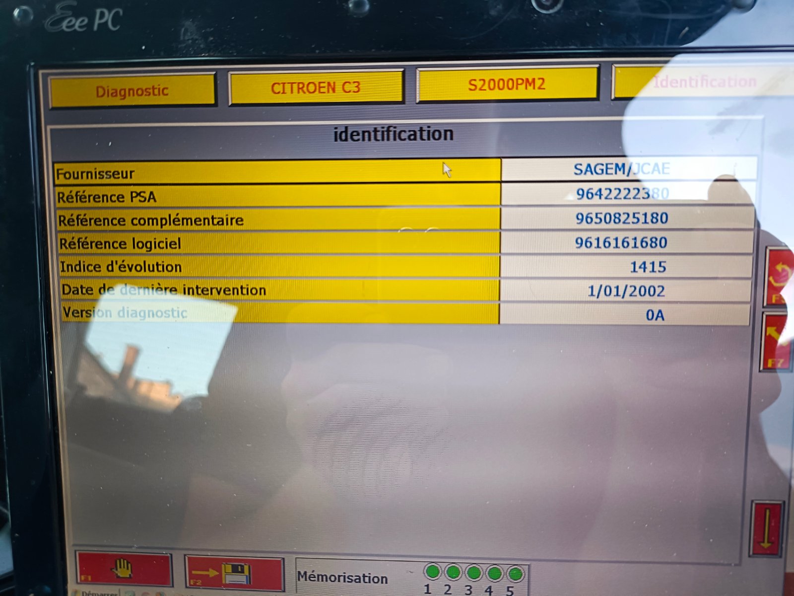

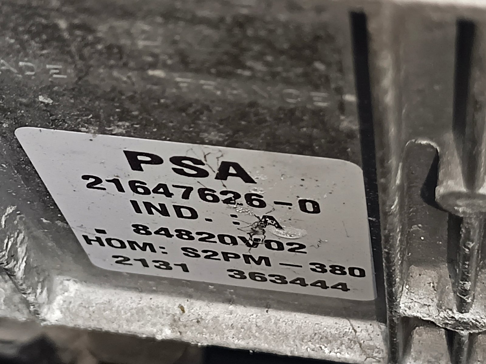

I updated lexia 345 to 347, now I have more models but it still doesn't read my C3 properly.
It only offers me the s2000pm2 calculator
Instead of my s2pm-380
I looked at the identifier that lexia sees and it does not correspond to my ecu which explains why it displays the message:
ecu not recognized information not guaranteed

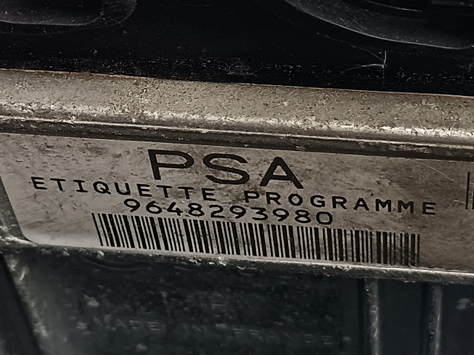

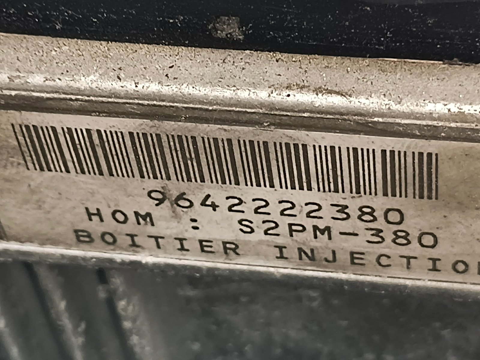

The PSA ref is still there even on lexia and the ecu label (common to a lot of PSA ecu) 9642222380
On the other hand the other ref 9648293980 on the ecu
Lexia gave me ref. 9650825180
The date of writing is 1/1/2002
If anyone has any idea thanks
