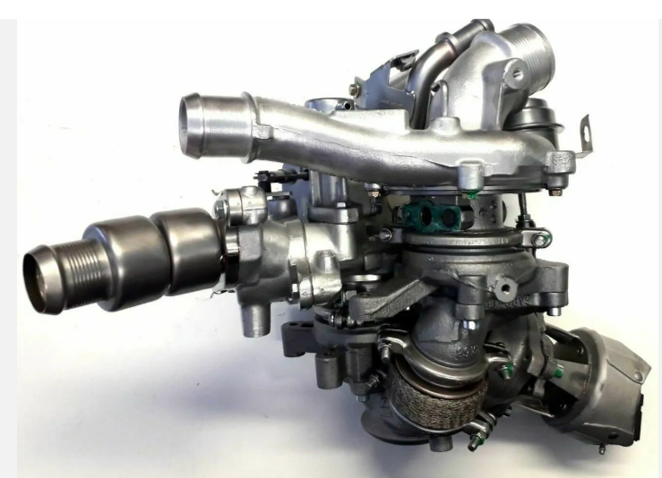

Yes it's the later engine in an X7 so is 173 bhp from factory.
So this scary assembly lurks behind the engine!
Two turbos entwined in a romantic embrace!
(I have bought a second hand spare pair!)

That's some big pair of a turbo :lol:
Was almost buying one Mk1 (facelift) with the 2.2 biturbo , but got a bit afraid of the "Biturboness" , regarding to possible repair costs :mrgreen:

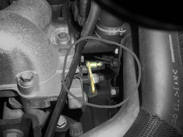

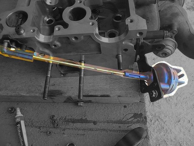

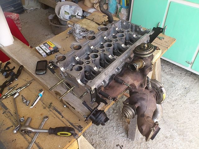

This is the Swirl Valve on the old 2.2 engine like mine. Took the photos from the internet (Dont remember where from - probably this or other forum). This was a few of the photos that helped me to understand better what to look for and where to find (one of the) problem (s) :D
It's vacuum controlled and opens around 2000 rpm
