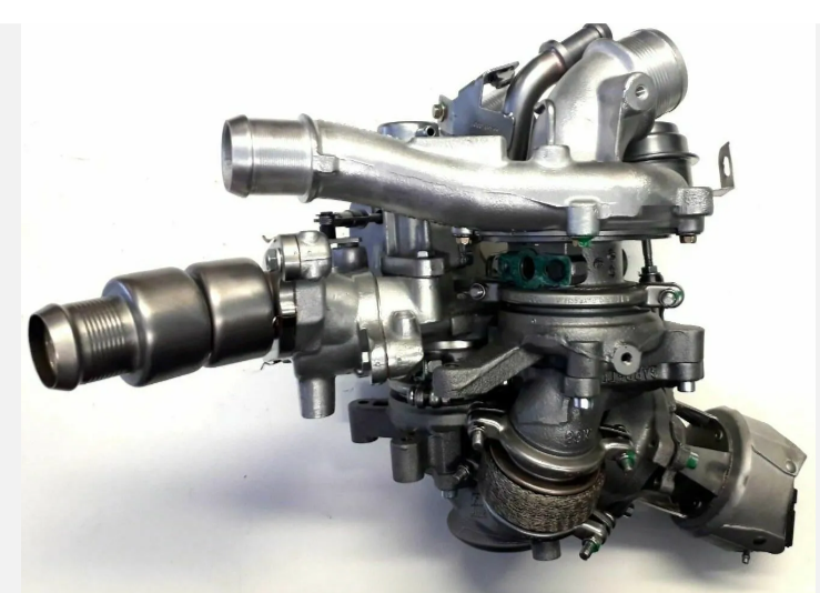

So this scary assembly lurks behind the engine! (I have bought a second hand spare pair!)

That's some big pair of a turboMattBLancs wrote: 09 Jan 2023, 06:16 Yes it's the later engine in an X7 so is 173 bhp from factory.
Was almost buying one Mk1 (facelift) with the 2.2 biturbo , but got a bit afraid of the "Biturboness" , regarding to possible repair costs
Imagine that driving it will be very pleasant.

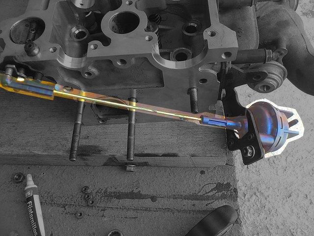

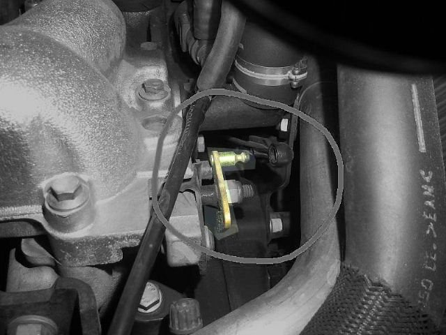

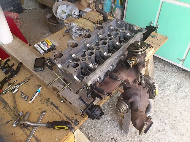

This is the Swirl Valve on the old 2.2 engine like mine. Took the photos from the internet (Dont remember where from - probably this or other forum). This was a few of the photos that helped me to understand better what to look for and where to find (one of the) problem (s)
It's vacuum controlled and opens around 2000 rpm
