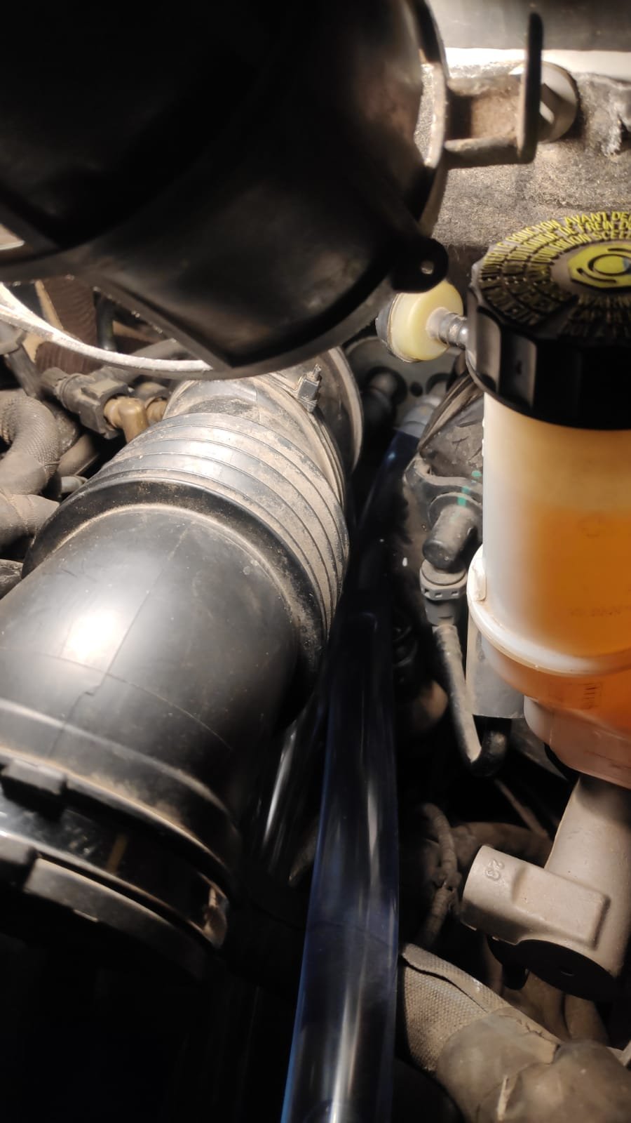

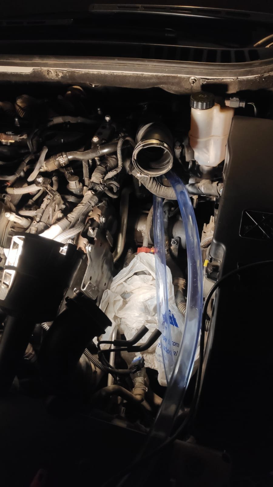

Hi guys, sorry for not replying but I was very busy with a lot of stuff, one of which was installing an RT6 unit in the car, but that's for another topic.
We've tried to flush cabin heater matrix, and it was not clogged. We first flushed it with water, afterwards we used Radiator Flush to clean the system https://abro.com/product/radiator-flush/ and left it within the system for about 30min. During the second flush with ABRO we just let it in the system via gravity, and it came out on the second pipe. First flush was pink due to antifreeze coolant, I am not even sure I saw any rust residue or anything else that could pollute the system. The 3rd flush consisted of only distilled water (all 5L).
Then I've went for a short drive (5-7min) and one pipe was very warm again (not to hot because of short driving) but the other was cold.
It really looks like something is ''holding'' the hot water from entering the system. Which also doesn't make sense, since the flush worked easy, without any problems.
Do V6 models use the same heater matrix as the other models?
I still need to check PTC heater, worked on it until 21h Yesterday.
Some pics of the procedure:
