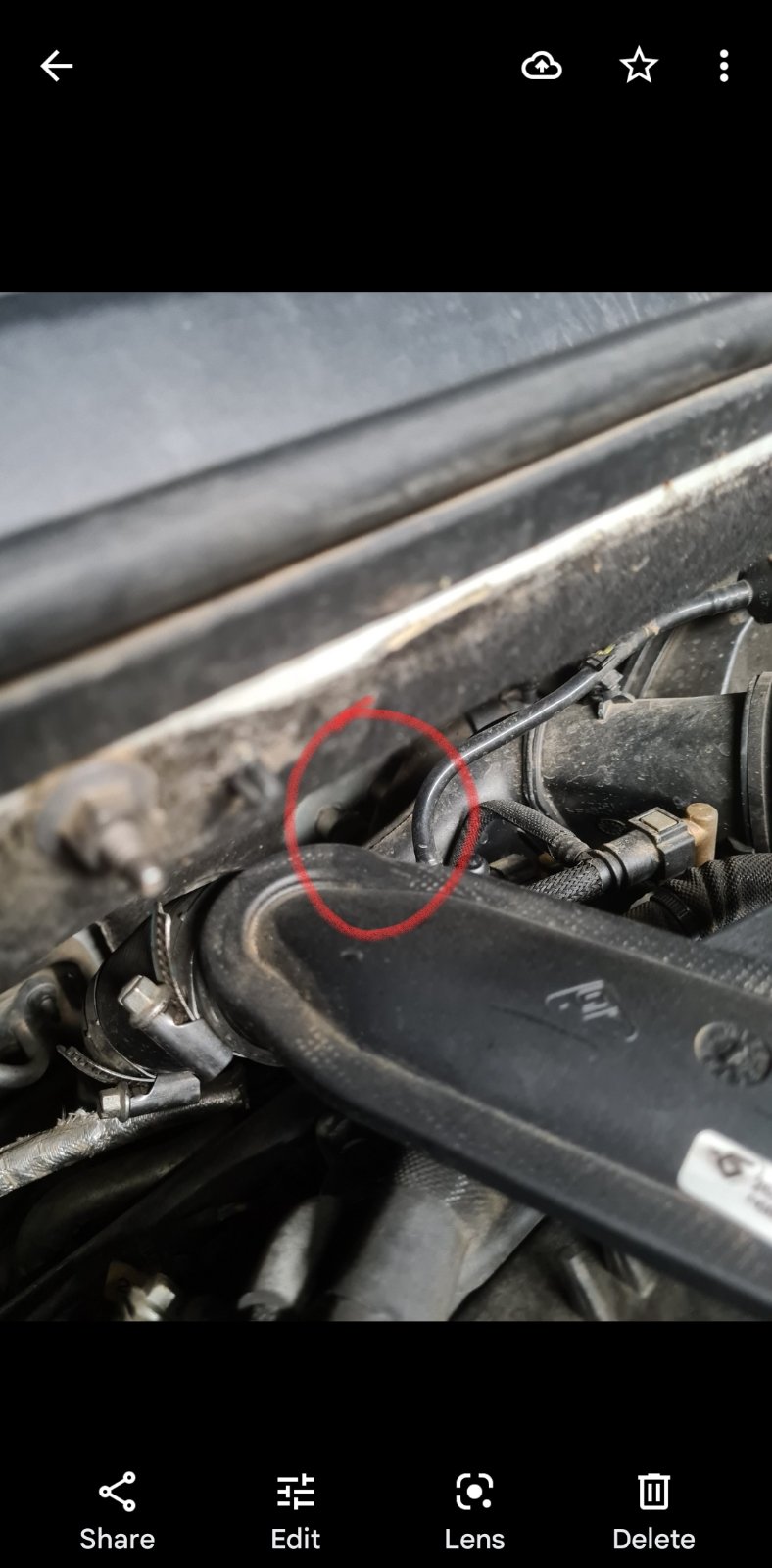

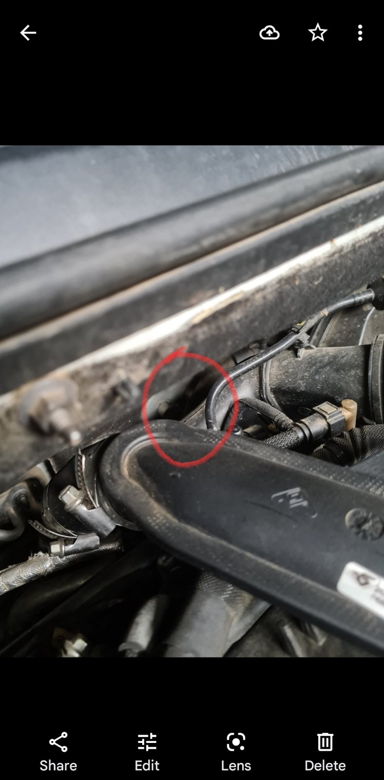

Ross_K wrote: 08 Nov 2022, 18:14
citroenguy wrote: 08 Nov 2022, 17:23 This thing:
That's not it surely, in front of the pollen filter, with the pipes going in? That'd be too accessible for a Citroen :rofl2:
Ross!! Really? I can't believe, an experienced citroenian such as yourself fell for that old trap - just because you can see it, sometimes even if you can get your hands on it, doesn't mean you're going to be able to extricate it. It's french, it's a car, ergo its female, so it's a french female, and you know how provocative and seductive they can be, it's teasing you... you probably need to remove the dash to get the mofo-matrix out.

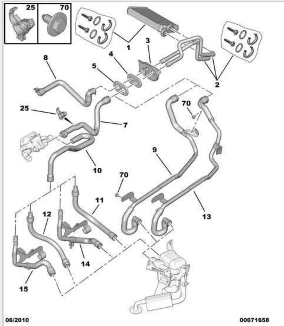

ExOduS442xb wrote: 09 Nov 2022, 13:52 Now, since I am pretty sure this is the problem, how does heater matrix work?
Is there some kind of valve that controls how much coolant will be released into the heater matrix?
I'd expect you should find a control valve on the inlet pipe.
One of the two light-grey un-numbered items in this diagram maybe? Perhaps the one on the left?

Since this is a "modern" (post cirka 1995) there is always coolant flow through the heater matrix.
The temperature is controlled only by the flaps in the heater box.
As you can see in the above picture there is no valve in the system.
The last Citroën with heater valve was the BX
